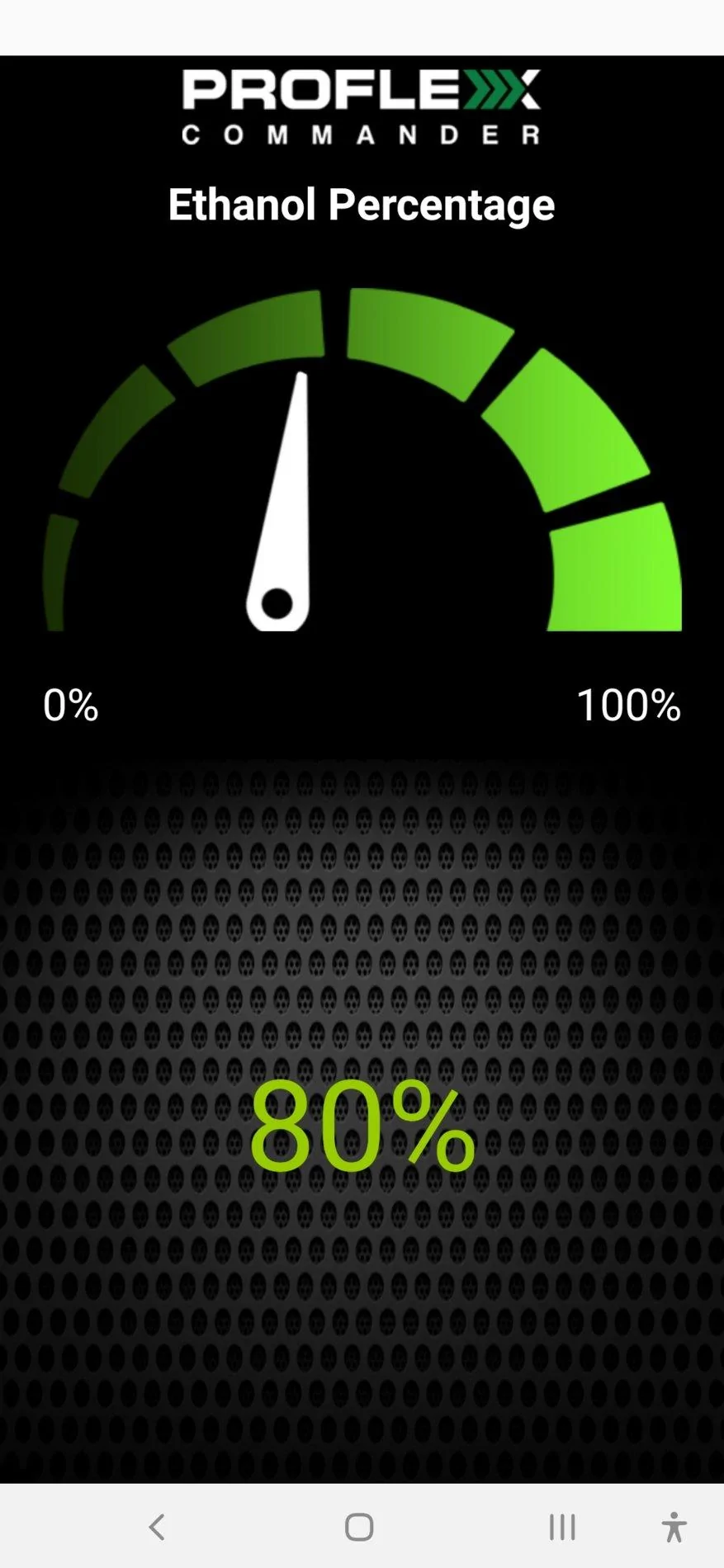

Alright I've put a half tank of driving in on E73, did some max acceleration pulls and just some general driving around. I threw the reader up 10 min ago and I have 0 codes and 0 pending codes. As for performance, you can definitely feel the difference in throttle response and acceleration. It's not game changing or anything but it's enough for you to love the system. I'm definitely happy with it if it continues to work correctly as it seems to be.
exactly what i am experiencing. it's definitely working as it ought right now. did a few WOT pulls tonight and it felt s-t-r-o-n-g. it's not blower strong, but it's definitely not a "stock" feel anymore. it's also got more pick-up in the lower rpms.
