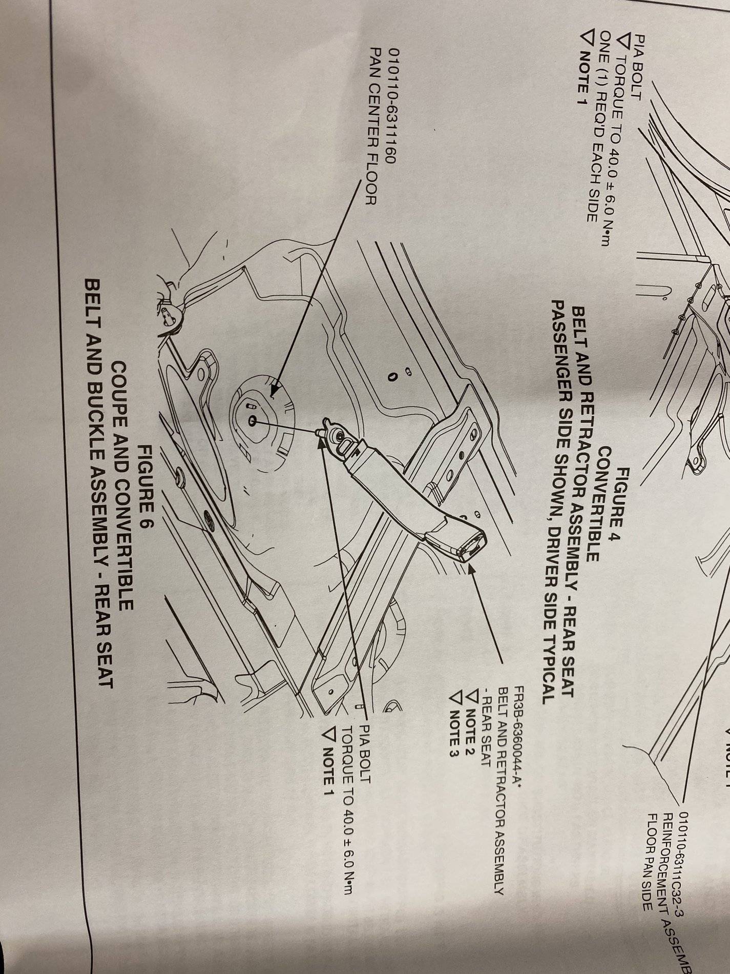

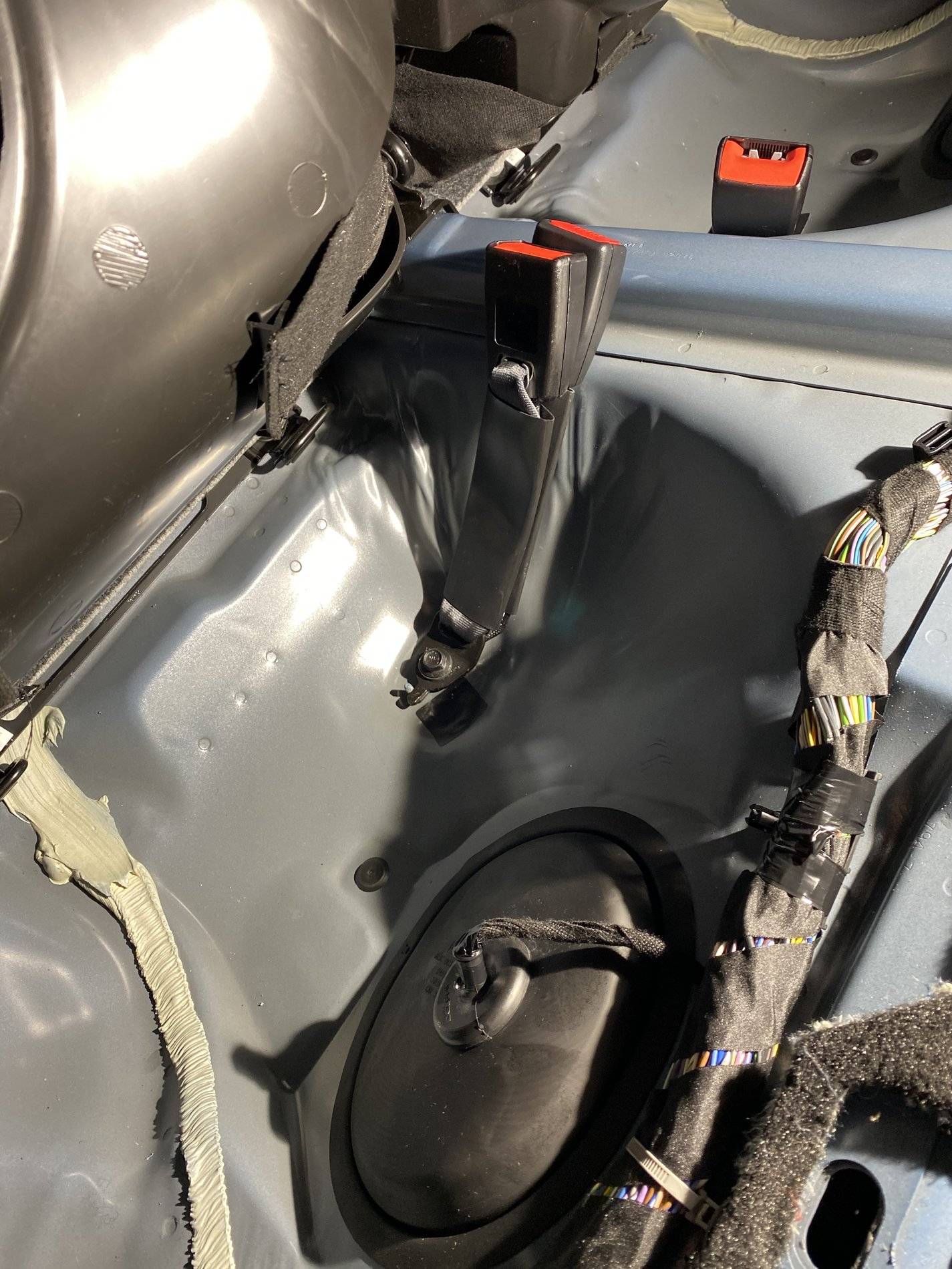

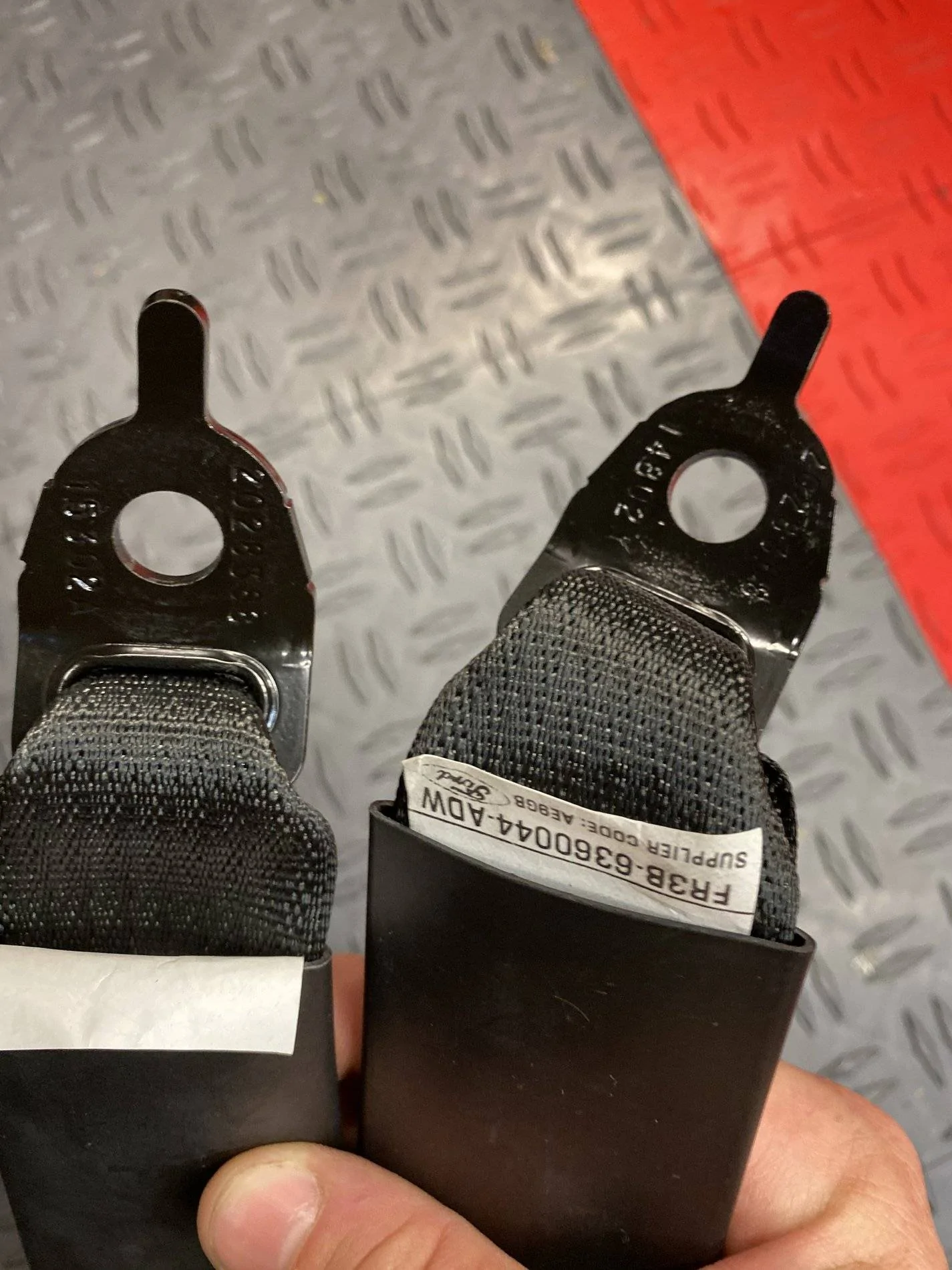

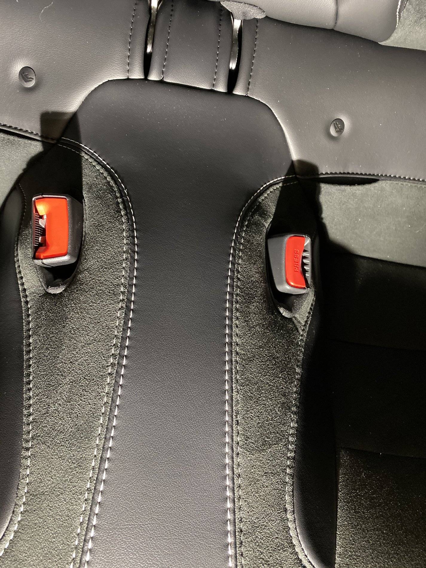

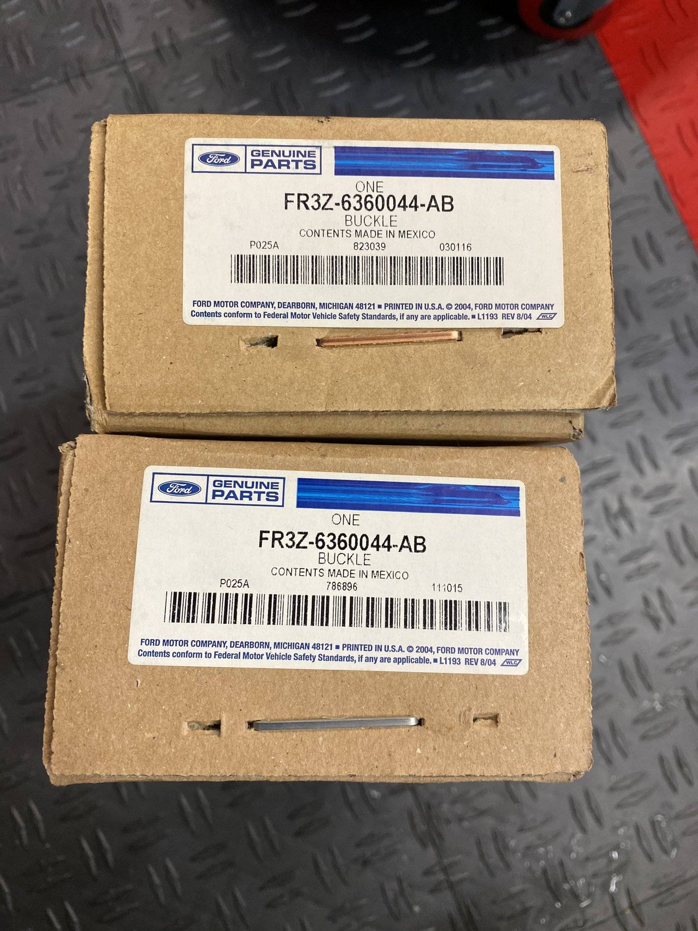

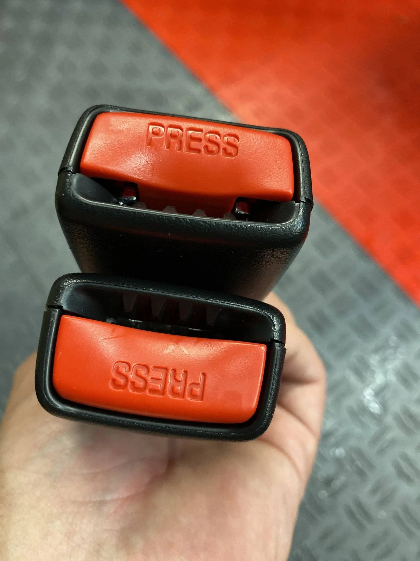

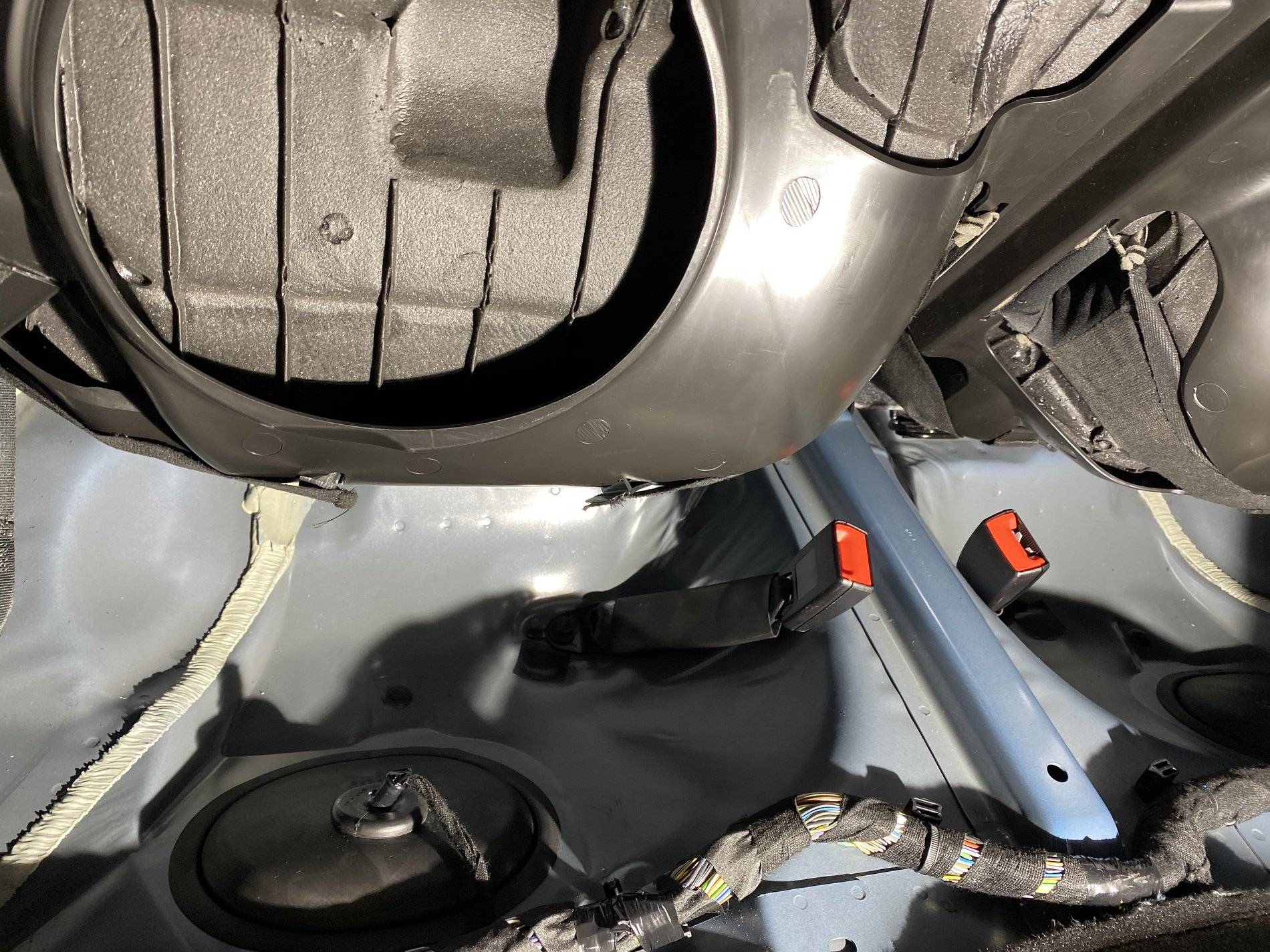

I went with the Schroth quick fit pro. If you want to use a HANS device and I recommend it, make sure you go with the quick fit pro as the regular quick fit is not HANS compatible.
I added a buckle recie to the rear compartment from the 2017 Mustang so it still works. I just pull up the buckle I need for the rear seat.
I took some pics but haven’t put up in my build thread yet. Need to take some more shots when I do the passenger side. Highly recommend them. Used them at their first track day let month and they did an excellent job with the OEM Recaros in my base GT500.

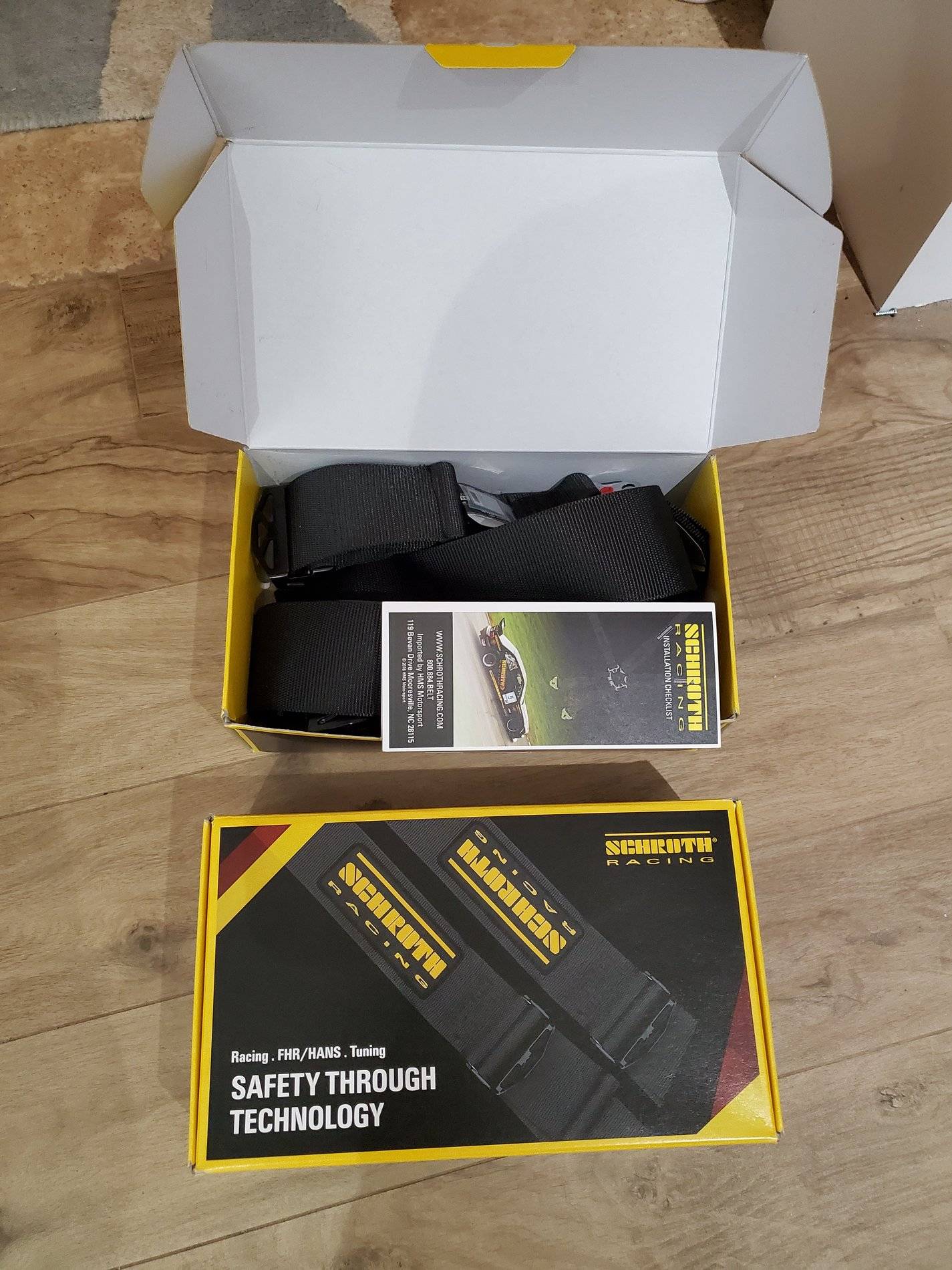

Funny you mention it. My schroth harneses arrived today.
