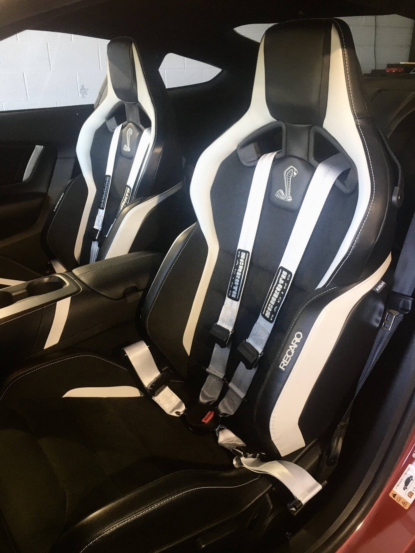

I recently installed the latest version of the Schroth QuickFit Pro 4 point harness.
Looks good. Was everything you needed included in the kit? How was the install?

Thanks. Everything was included with the exception of the grip pins which are optional. Install was easy. Just be cautious when you pull the trim panel as it could scrape against another section of trim near the upper back corner of the side window.
