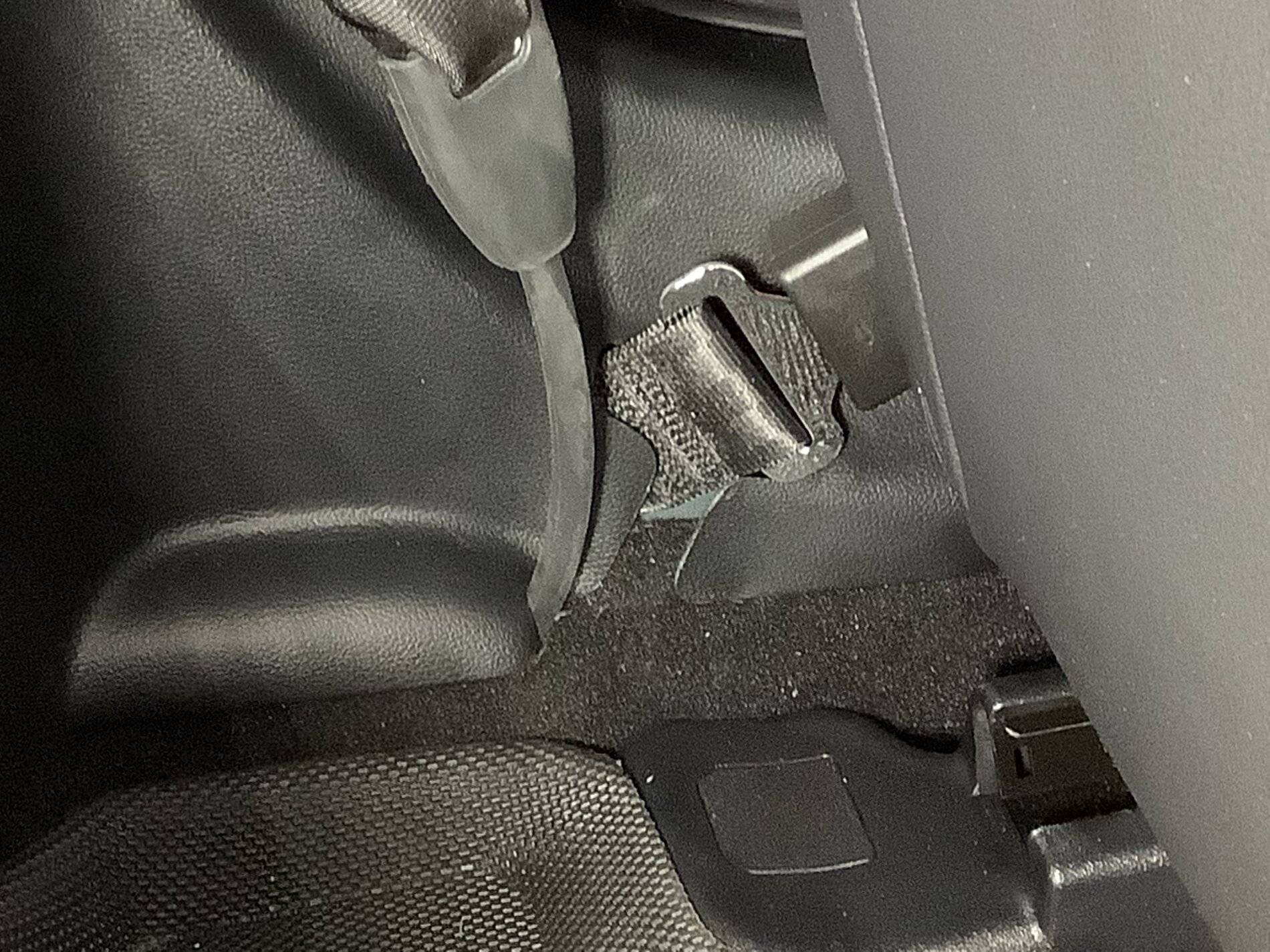

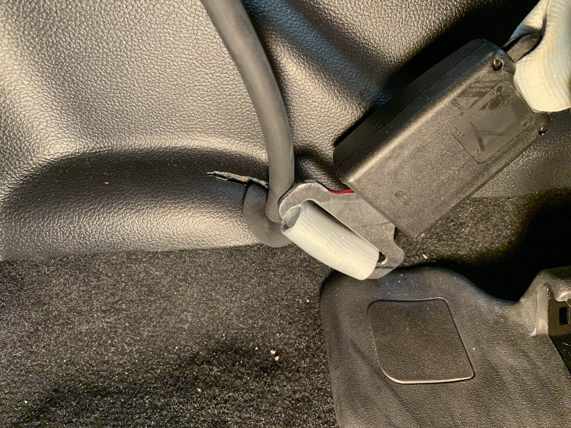

I have a CFTP GT500: Where & How do you install the front Driver Side Seatbelt Anker?
Surfergeek
Jul 13, 2019
277
235
Silicon Valley
Jared
2020 GT500, 2004 Corvette Z06, 2020 F150 Platinum, 2019 Yukon Denali XL
It mounts along with the stock seatbelt:

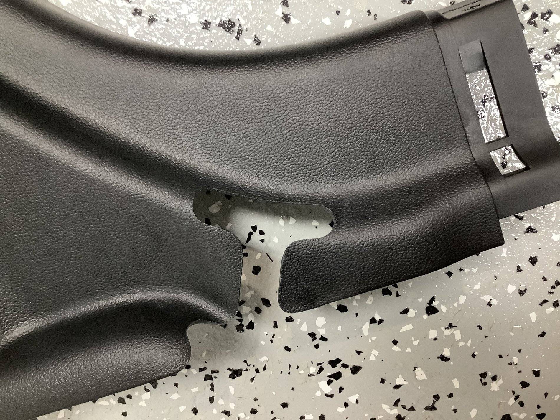

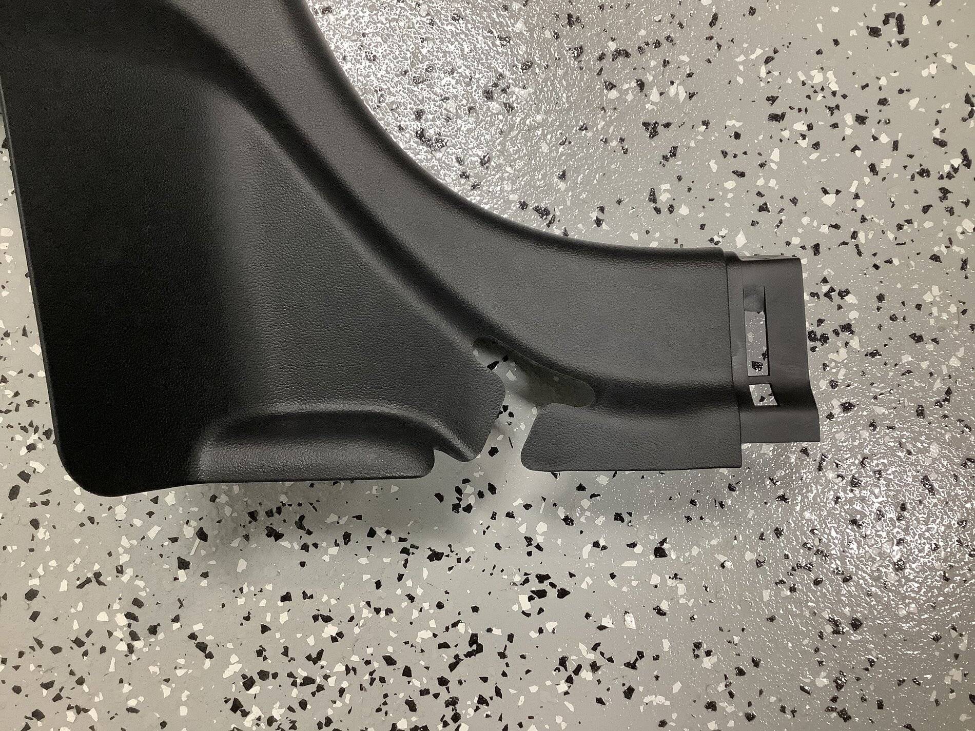

I see you did the panel trim like I did. There are some minor differences in the factory anchor mounting from what is shown in the directions. I fought with it and ended up trimming the panel like that. Dremel comes in handy.
The Chairman
Mar 18, 2016
1,079
806
South TX
‘09 GT500KR & ‘16 GT350 Track Pack & ‘20 GT500 HP
Ya, I cut it like I had done on my GT350. As you can see, I didn’t need to slot it as much as I did... Kinda overachieved.

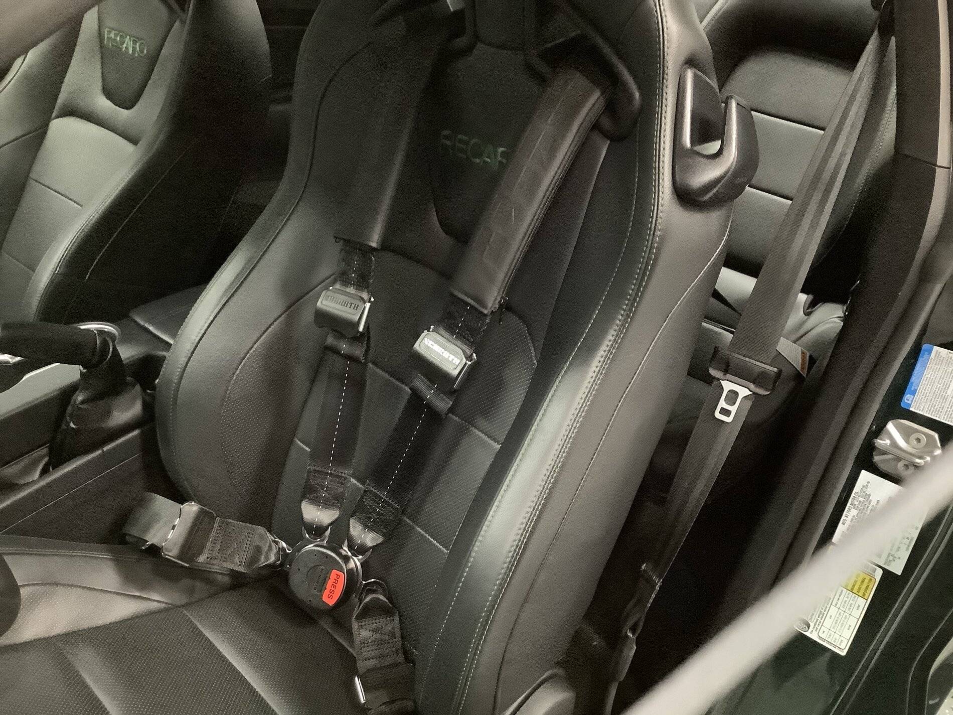

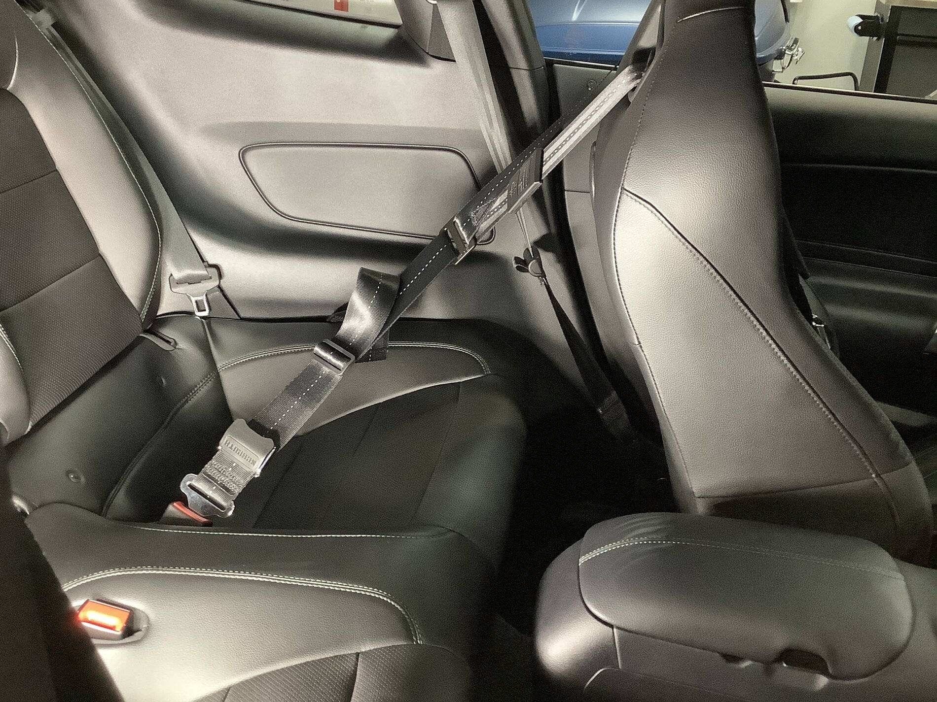

I recently installed the latest version of the Schroth QuickFit Pro 4 point harness.
Lookin’ good! Did you have to bend either of the brackets on your belt clips?
I just installed a Quick Fit Pro on the driver’s seat in my Bullitt today too. While I didn’t have to bend any of the brackets, I did modify my rear trim panel for the outside lap belt clip. I did order two grip pins, but apparently they’re on back order. After getting the belt, it looks like I could have used three. How many grip pins did you order per belt?
