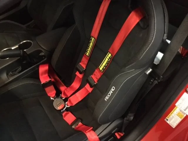

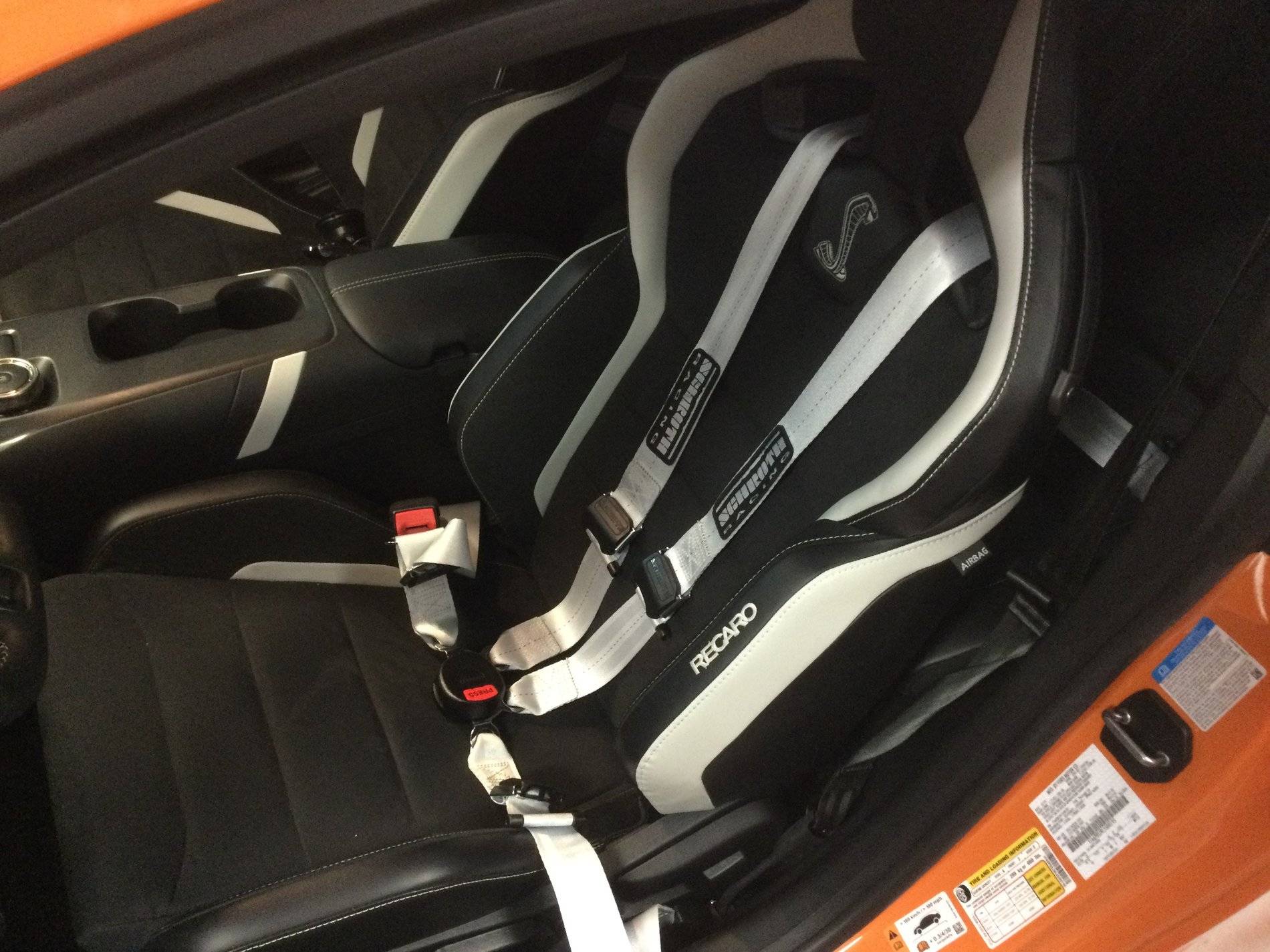

I use the Schroth 4pt system as it is accepted by NASA and every HPDE group I have run with. Much safer than the stock system. Works great with the HANS — No issues there.

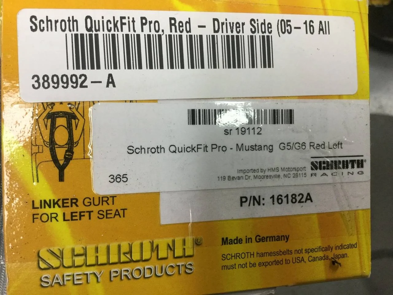

Also, just order the belts for the 2016 GT350 and add this buckle to the rear seat: FR3Z-6360044-AB. The rest works fine.
It’s the rear inboard buckle receiver that Ford changed. If you add this older style female connecter to the one that is already there, it works just fine and the original belts still work.

This part is from my GT350 order (red), and a pix of my GT350 install. My GT500 is identical except I got the belts in gray/silver.
