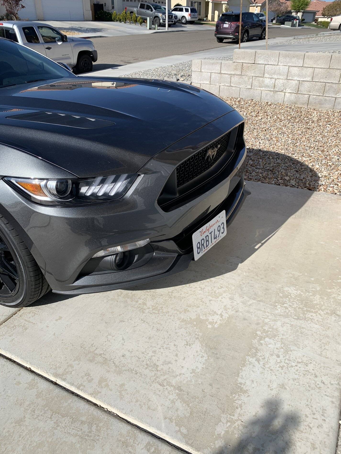

Sto n Sho here mounted offset. Works good for me! First thing I told the dealer as it came off the truck..."Do Not Drill MY BUMPER!"

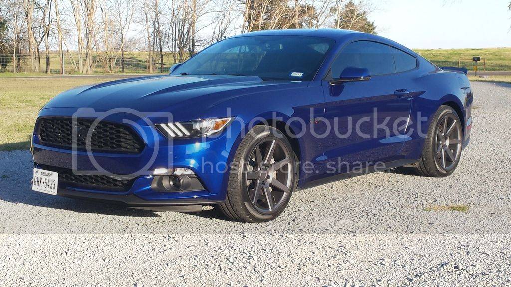

Told my salesman not to drill the bumper when I ordered my car. Called him back a few weeks later and told him not to drill the bumper or I'd walk away from the deal. A few days before arrival he had lot attendants coming to him asking permission to drill bumpers for every Mustang delivery. And when I got my car the bumper mount was taped to within an inch of its life to the spare tire with a big sign on it not to drill the bumper. Had the whole place paranoid. Mission accomplished.
Oh - and the Craig's bracket works great. I like the location of the plate (would be good with stripes too).

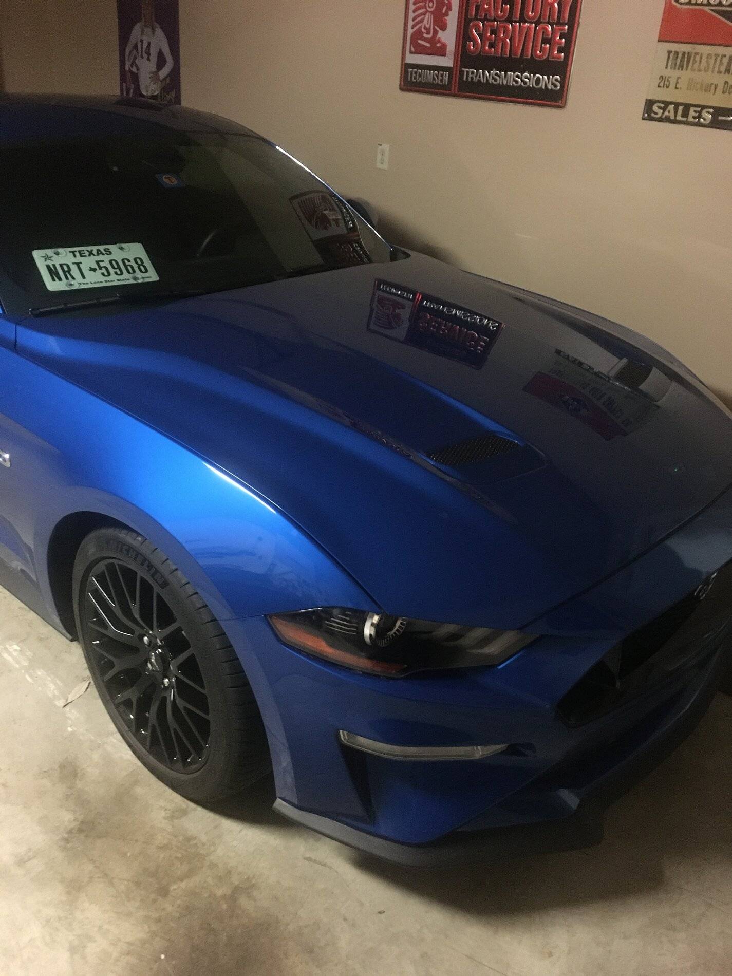

Here's my solution. Cost $3 for suction cups.
Supposedly it's not legal to do that in TX. I asked a cop many years ago if I could put it on the windshield, and he said nope. Or did that change now? I'd not leave it there for any length of time, but just to get out of a ticket momentarily, I'd be fine with that. Need to check the TX laws on front plate again, but I'd be surprised if something changed. Did you check it???
After further research, i am going to plan B. Currently searching for a better option.
