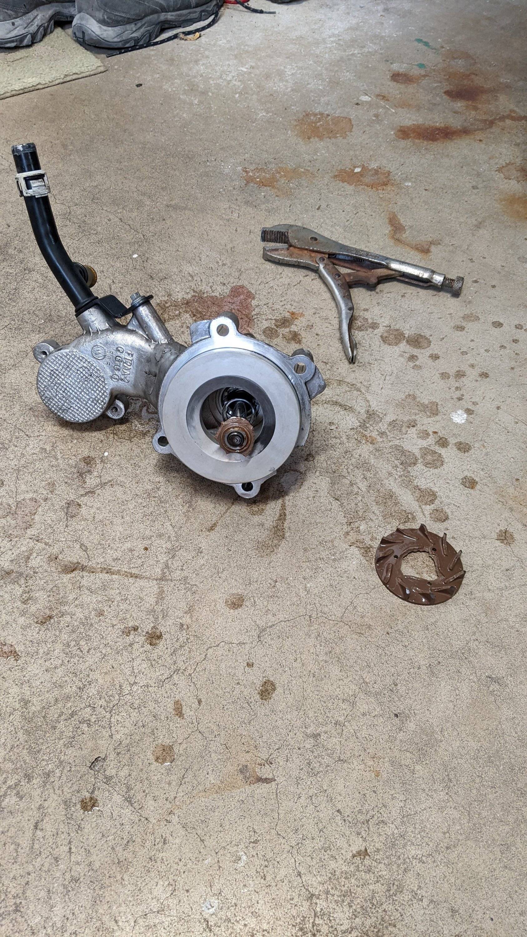

I just finished up installing a new water pump on my 15 GT over the weekend. I ended installing an aftermarket pump with a metal impeller as opposed to the Ford part with the plastic bits. Everything went well with the install, but after putting everything back together, paranoia set in. I'm worried about pieces of plastic floating through the block that came from the stock plastic impeller that broke up due to a failed bearing. Is there anything I can/should do to make sure the cooling system is not contaminated with plastic fragments?

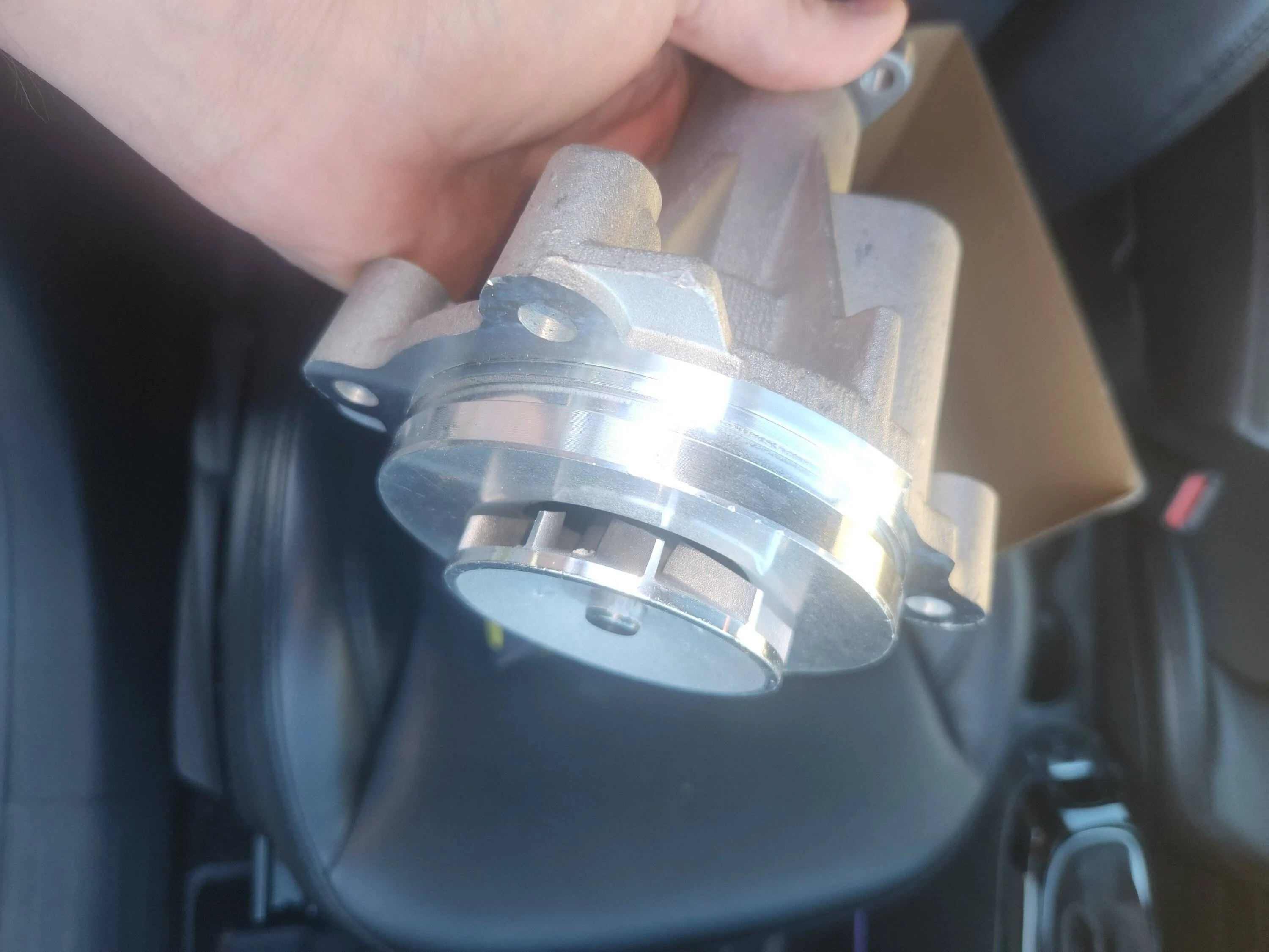

My mileage is right 48000, which I wouldn't consider to be that much. I guess the bearing can go anytime on these pumps. The pump I ended up ordering was from rockauto. The brand was Dayco, and apparently comes with a 120k warranty if you register it. The price was $69 I think. As far as collecting plastic from the cooling system, I was only able to pull out the large impeller disk shown in my first post. Attached is a pic of the new pump.

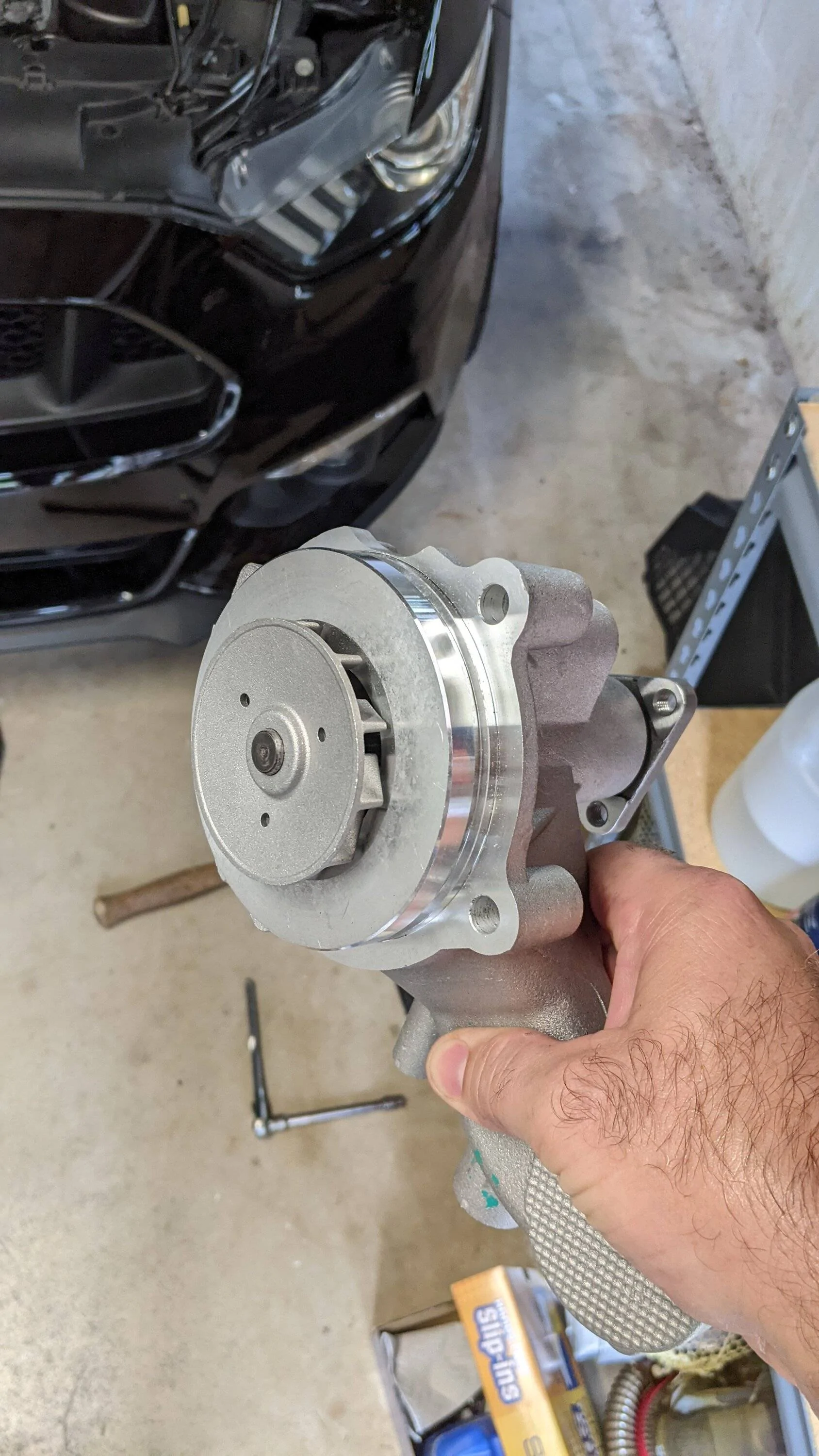

It's funny that you bring this up. I am in the middle of putting my built engine back together and was certainly not interested in re-using my plastic finned water pump with 48K+ miles on it back in the car after upgrading almost every other component. We are going to be turning this thing at over 8K rpms and I am worried about a plastic impeller coming apart. I was talking to one of the managers of a local auto parts chain here in the Baltimore region and he mentioned their premium brand, US Motor Works, that they carry. I picked it up yesterday for $85.85 out the door. They appear to be headquartered out of California.
In their catalog it is part # US8116
