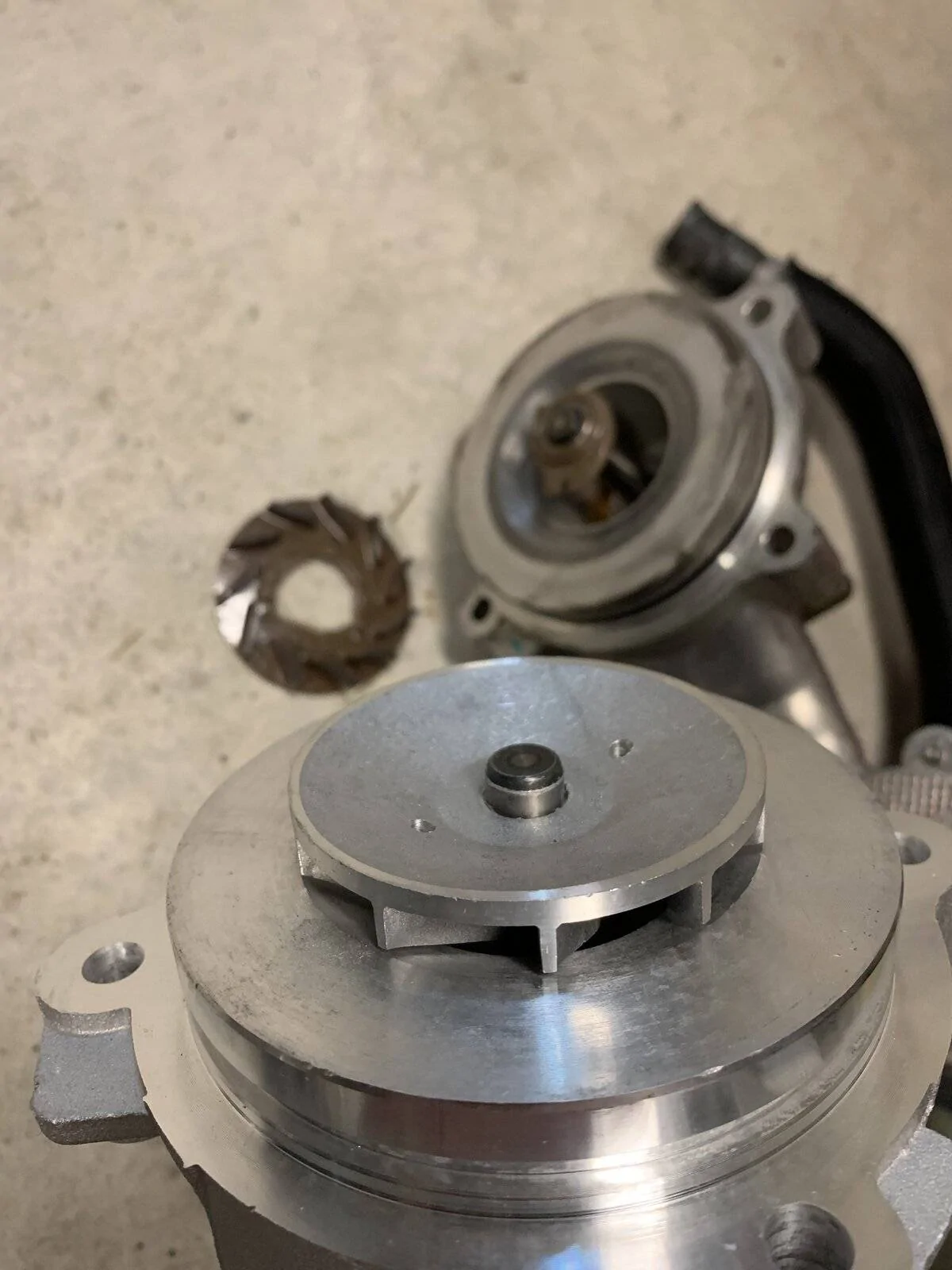

Sorry to hear, hopefully it didn’t leave you stranded. Good news is a trip to Autozone, $150 bucks, and about four hours takes care of it (did mine this morning).
I suspect Ford and the aftermarket corrected this failure. My 2016 OEM pump had a plastic impeller (grenaded impeller is farthest in below photo); the replacement part is all metal (in photo; nearest):
I bet the metal design will go longer than 30k miles or 5 years. I also used liquid gasket along with the provided real gasket as insurance.
I’m not sure, but I suspect 18+ MYs have the good metal impeller.

Looking back, I think bearing quality is most important. I suspect my bearing failed and caused the plastic impeller to contact the pump housing, leading to the catastrophic failure.
This said, I think a good preventative maintenance inspection of the bearing (see if it wiggles) can save folks from being stranded on the side of the road.

Plastic water pump impellers = cost savings to vehicle manufacturer and = royal PIA to vehicle owners when they don't last past 20k-30k miles.
The metal impeller design should last life of vehicle ownership - until the water pump bearing fails anyhow...
Powertrain Warranty is 5yr/60k, which ever comes first. I think a failed water pump is covered but depending on when you bought your S550 (if original owner), you may be past the 5-year mark.
Composite impellers can actually be superior to metal ones, IF they're made properly. Never have to worry about corrosion with a plastic.
If you don't believe me, I have a practical example. In the Ford Taurus DOHC engine (early Duratec 30) from about 1996 to 2003, they used an early composite impeller that was essentially immortal. They would outlast the car, pretty much guaranteed. 200K plus and you might have to change one because the bearing would be worn out.
