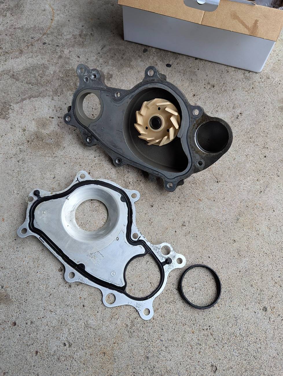

The water pump change over went well. 2 hours and done. No issues at all. Cleaned up all the surfaces and installed the housing fasteners with the proper torque. The belts looked great. I plan to change them at 160,000 km when I change the spark plugs.
I've had many cars that go more than 200, 000kms and no water pump issues. I guess 120,000 km isn't too bad.
