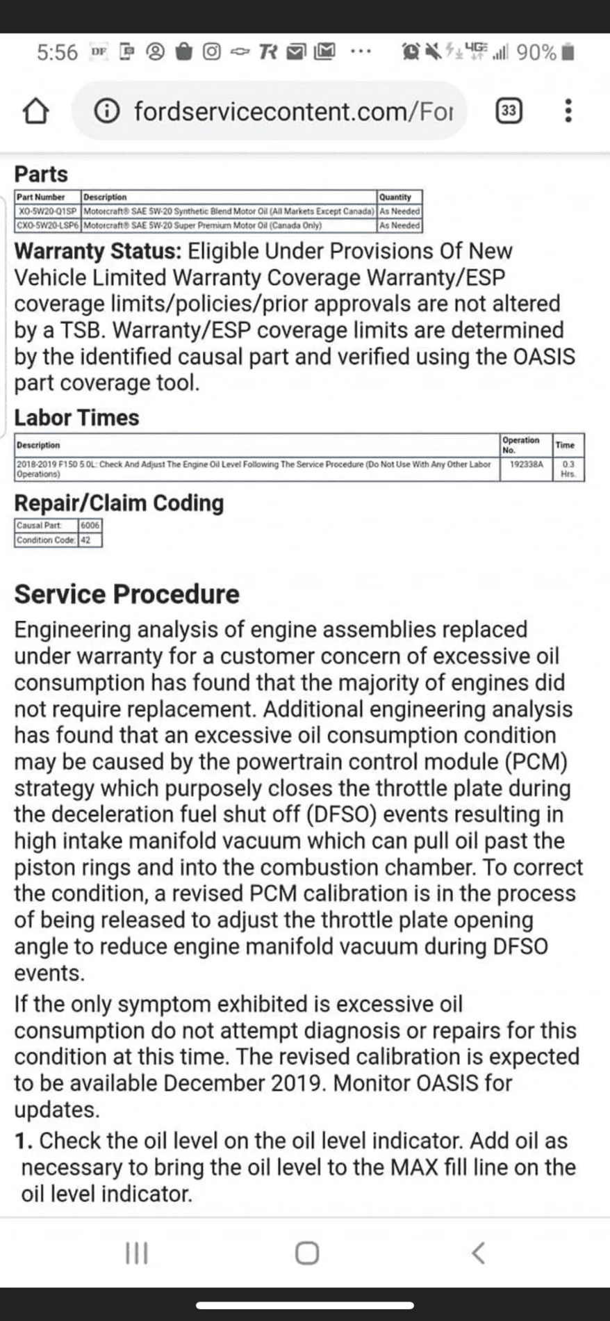

Going from new engines to new pcm calibration
I’m not sure this is for the 350 though.

Hmm, makes sense but I would be more excited if it didn’t say F150. Have those guys also been getting engines replaced for oil consumption?

I always wondered if that was part of the reason my oil consumption was so bad (closing of the throttle plate) because of the intense vacuum. You would see in the forums not to engine break to see if the consumption reduced...

Might be apples and oranges but interesting. Wouldn't the PCM be calibrated the same on all new engines leaving the factory? So why do some burn and some not?
Yes, some are....
I hope to not be one of that particular club with my new truck.
Many cars have slightly different engine calibrations. That is why there are different ECU codes. They can have different stock timing, fuel, many things. Usually more higher end cars (shelby's and lately Mustangs in general) have had much smaller variance between them. I have seen a Focus put down 118WHP, swap the ECU with just another stock ECU, and then repeatedly make 105. The two had totally different fuel and timing maps even though both really should have made similar power based on the fact both cars were rated the same.

There are also going to be minutely different tolerances in the oil rings that may not directly affect compression, but could result in one engine allowing more oil by than others. Of course driving style can change it as well. I can notice a change in my car's minor oil consumption based on driving habits. I used to commute in to work on a patch of highway that had a lot of traffic and through most of that traffic i would simply leave the car in 2nd or 3rd as appropriate and accelerate and engine brake as needed to maintain distance. This deceleration and engine braking in gear caused far more oil consumption than my current commute that has a few dead stops at stoplights, but generally consists of more acceleration to cruising speed and then braking to a complete stop as needed. I have also heard others report similar experiences where their car may use 1 quart per 1,000 miles, but they take a 1,000 mile road trip and consume next to no oil whatsoever as the drive was mostly steady state cruising without multiple engine decelerations.
I wish it were true but clearly looks to be a TSB for F-150s with the 5.0 liter V8....

It's hard to know what this really means - it could be rings as stated in the TSB or it could also be valve stem seals that are leaking. In any case, if it cuts oil consumption that's a good thing. Also, I would expect that with the throttle plate open and fuel shut off that the engine would be a more effective brake than it would with high manifold vacuum.
Dealership I goto has replaced several 5.0s in f150s for oil consumption. They are a huge shop for trucks though. They havent mentioned of any gt350s being replaced, but they also think my gt350 has a 5.0 in it, so.....
