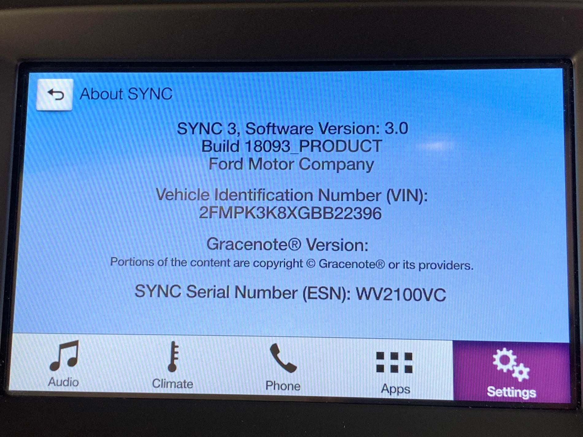

I know my VIN what the heck is ESN??
Yep, go to general settings, scroll down all the way, then click on 'about sync'. Then scroll down all the way again, and at the end you'll see the serial number. It should be 2 letters, 4 numbers, and 2 more letters. Hope this helps.
