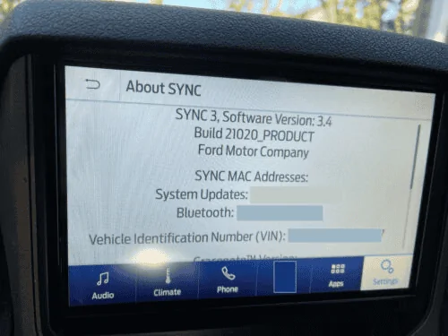

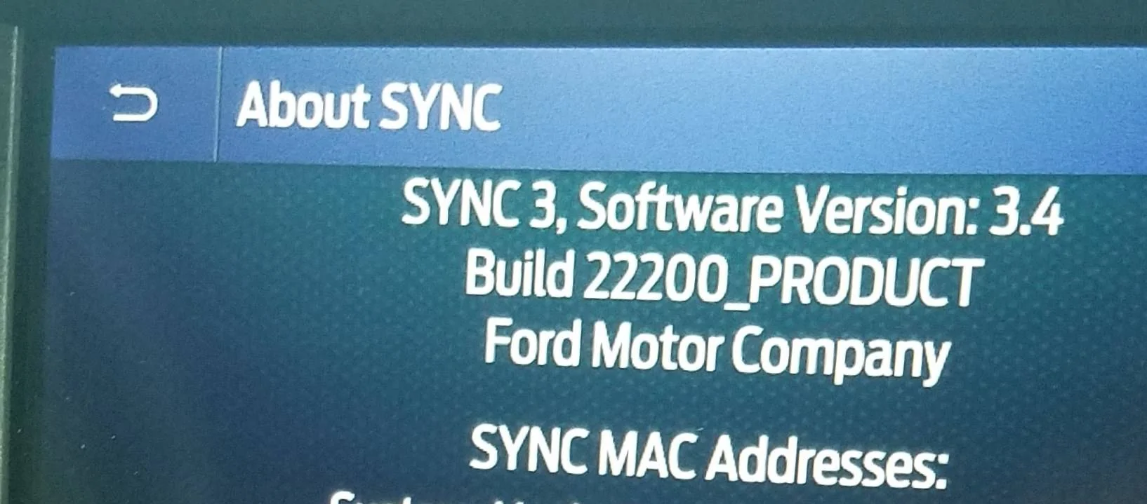

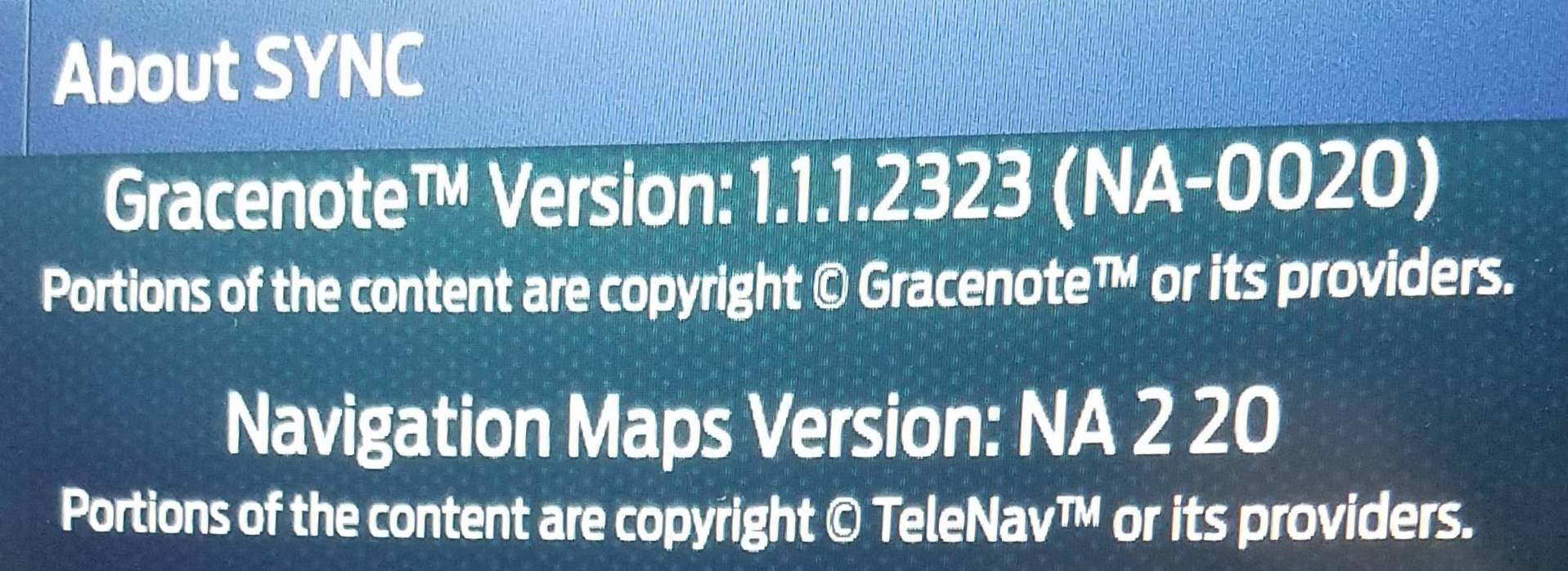

In Sync3 go to General, about Sync. This is where you will see your version # and build #. The latest is 22200. If your is not try downloading from your USB again.

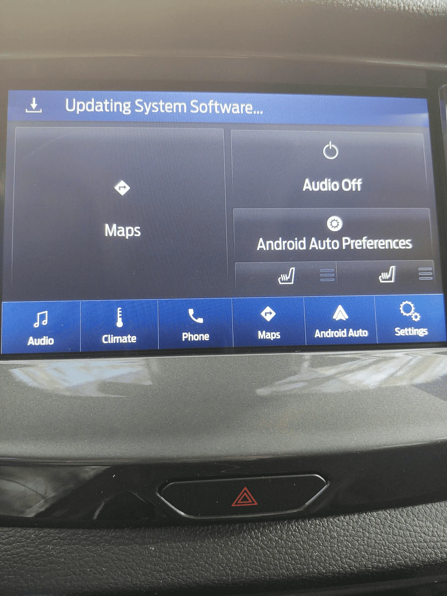

When you first started you should have gotten a header stating that an update was loading. A short time later you will get a screen telling to you restart your car (or something like that, I never remember). Do nothing, the update will continue on its own. You will then get the final screen telling you update complete, remove your USB. At this point I shut off my car, open the door for 30 seconds and then start her up again.
Her is an older about Sync screen but yours will look the same.

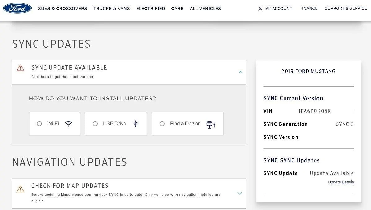

Thanks. My build is 22200. I definitely didn't get the "Updating System Software" note. The Ford website says my SYNC isn't up to date when I put in my VIN. I tried contacting Ford and they created a case number, but nothing has happened since.

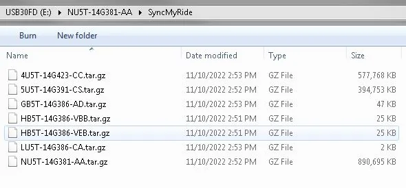

So long as you have 22200 you are up to date. Did you check your USB files to make sure that you did not get the .XML file?
Here are my 22200 files.
Yes. I checked. It's not there. If I'm up to date, why would the website say I have an update available?
Because it doesn't know due to the fact you could not report back to them. No big deal Ford will take care of it for you.

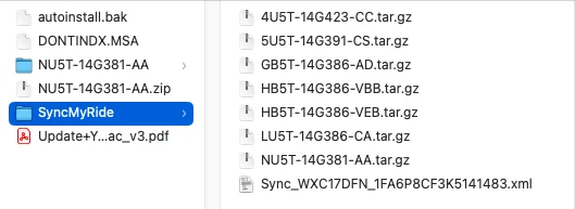

For such cases, when an XML file isn't generated during the update, Ford provides a separate package that does just that. I think they only offer it in Europe, I don't know why, but it should work in US vehicles as well.
Unzip it on the USB thumb drive and use it just like a regular update package.
