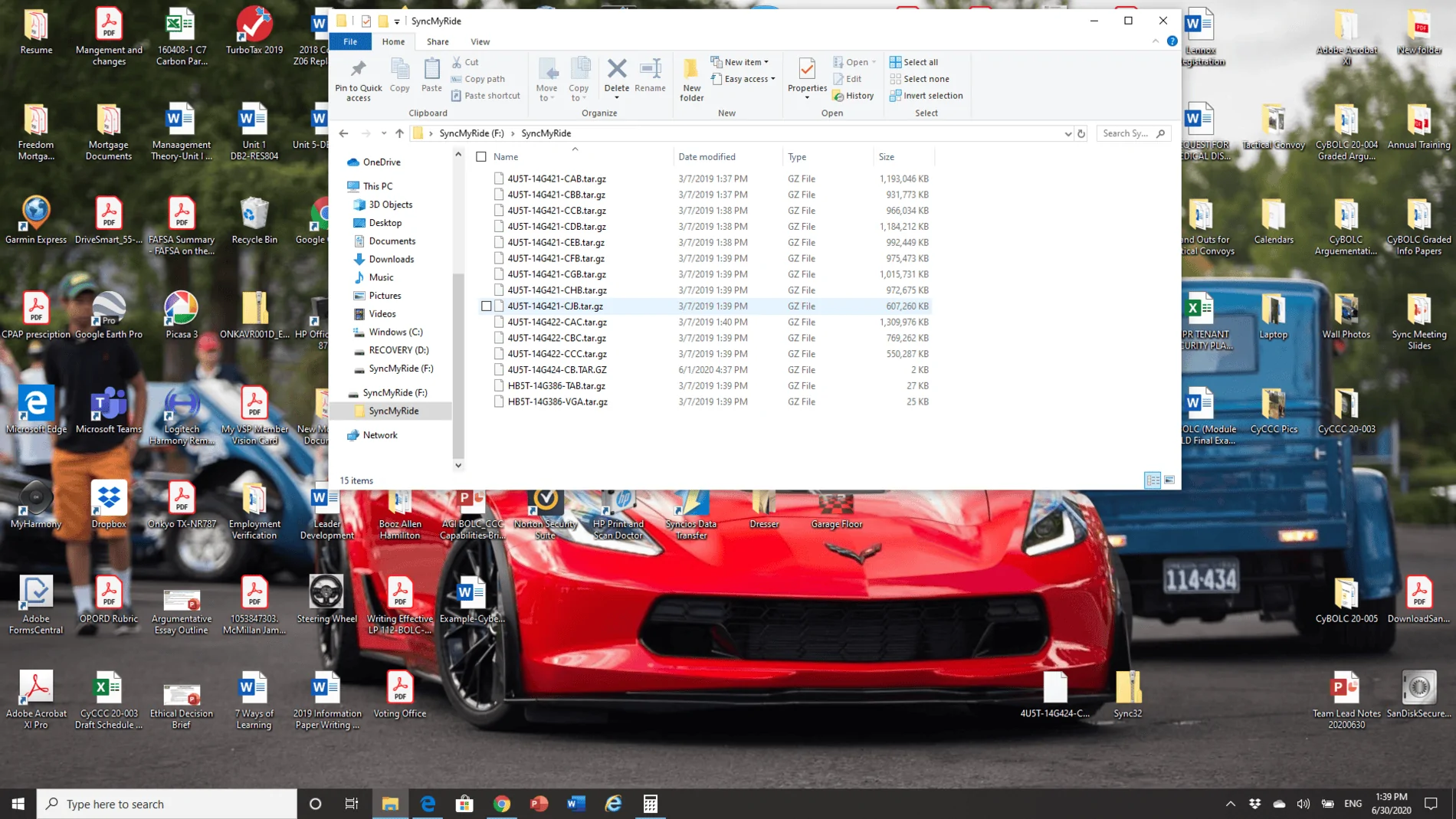

Here is a screenshot of how the files look on the USB that I had no problem installing with the 1.18 maps.
As stated a couple of times, ensure the USB is formatted with exFAT32. I only have the update on the USB and nothing els.

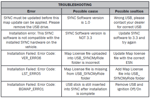

in the installation directions i posted they have this..
looks like you got license file issues..
Thanks for sharing the error codes! I couldn't find them anywhere. Strange that I get that error even when I have the license file in the right spot.
