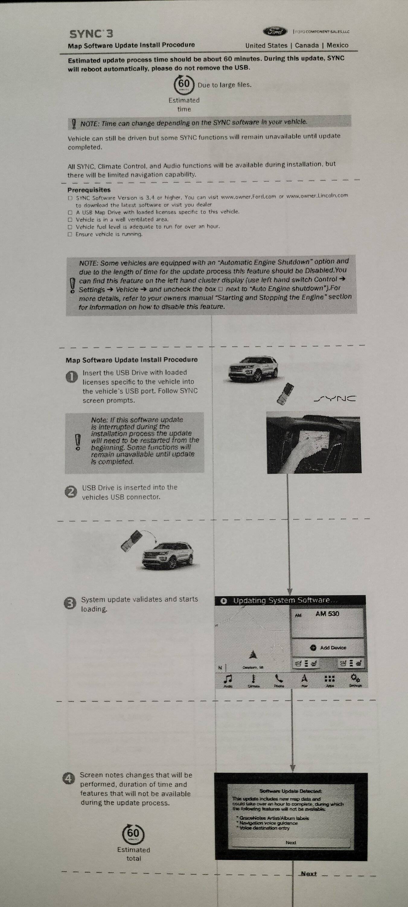

Hi. How exactly are you doing this update in your car settings while parked outside?
Thanks
If it's free I'll do a download to a USB drive as I always have. WiFi has never worked for me. If there is a charge (There will probably be) I'm going to pass for now. Now going anywhere that an update is needed.
DavisCustoms
Dec 23, 2014
376
168
2019 Ecoboost Premium
you have to go to syncnavigation.com/ford, enter your VIN, and download the map file and license onto a 16GB (bigger preferred)usb3.0 flash drive.
then plug it into the USB port in front of the shifter, start the car and it will pop up on the screen if you want to update.
Note:
You will need to have SYNC already at ver 3.4
It will take roughly an hour so make sure you have enough gas for the car to idle for an hour
Edit: Added the Map/license download instructions and the Map update instructions.
Edit: Instructions say it takes 60 minutes, mine only took 20 minutes to install.

Ford paperwork does state the engine has to be running (I am assuming to keep from killing the battery)
It also states you can drive during the update but some Sync/navigation features would be disabled until complete
A/c controls will work normally at this time
Fixed the images that didn't load on my last post

Sync software can be update via WIFI in your garage, however, the Maps update is 15GB+ and is too large to download via WIFI, you will need to download the update to a Flash drive and update manually. i included the instructions above
Thats what I will do. Do you know if we can drive the car around for an hour during the update?
DavisCustoms
Dec 23, 2014
376
168
according to the Ford update manual, you can drive it around like normal, Some Sync functions and Navigation will be disabled (A/c will work as normal)
