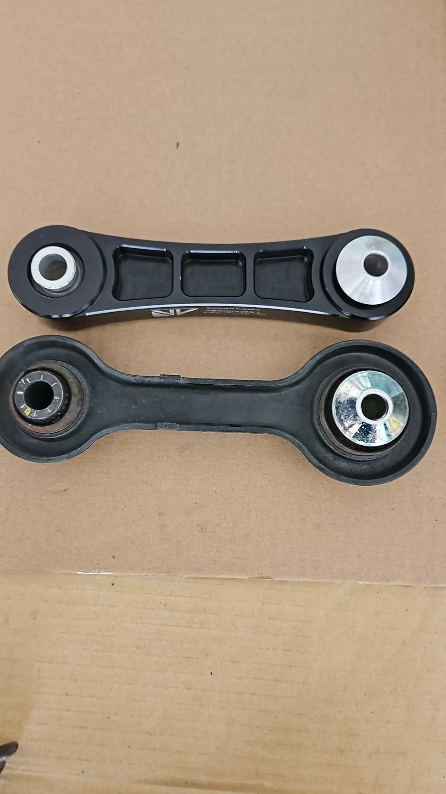

Those turned out really nice WD!
Thanks - but they came like that ... :giggle:
J&M offer them in silver, black and red - so I didn't need to do anything with them :like:
WD :like:
WD :like:
Even better, as that saved you some coin not having to pay to get them done.
