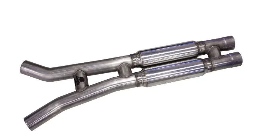

So, I currently have Stainless Power catless headers with a Corsa Extreme catback. Since I went catless in April, the rasp has gotten pretty bad. When I had cats, it was tolerable, but I need a long break from it. I saw Lethal Performance in the last few months released a resonated doubled H pipe with 2 MBRP resonators on it and I'm thinking that should help cut out some of the rasp, and give me a deeper sound overall. I could have 2 resonators welded in on my current exhaust, but after parts and labor it's probably pretty close to the price of the Lethal Double H Pipe.
https://www.lethalperformance.com/l...ipe-2015-2026-ford-mustang-gt-dark-horse.html
My only real concern is I may have to modify the H pipe. My current Corsa X had to have a few inches cut off each tube to connect to my headers when I had them installed 18 months ago.
Has anyone used this H pipe, and if so, what's your opinion on it?

Havent used that H pipe but have the same car and exhaust and it was to loud as well. I went to a muffler shop and they cut out one of the h pipes and added two resonators and the rasp is all but gone now. Couple of pool noodles for the cold start and i am officially not a douche to my neighbors at 6 am with my cold start.

I put on the Magnaflow 12469 and it made it sound better than it ever had.
No rasp, cold start is tolerable and it sounds really good in the higher RPM

I went with the magnaflow 11386 and I love how it sounds with kooks headers and stock catback.

I have the double H pipe (non-resonated) and Stainless Power headers. The good thing is, you can buy 3" transition tubes from Stainless works as well, and get rid of the 2.25" choke point in the factory exhaust. The nice thing about the Corse double H, is that it comes with adapters for the factory exhaust, or 3". You would just need (2) 3" butt clamps, and then cut off the flared section of the transition pipes.

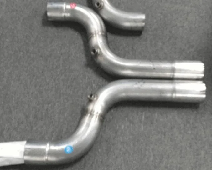

I already have full 3 inch. I'm just assuming I have to cut the same pieces off with the lethal h pipe.

It just depends on whether your "S" shaped transition pipes from the cat into the resonator are flared, or are straight. If they are 3" OD, then you shouldn't need to cut anything, and they will slip into the H-pipe flares.
If you have the Aftermarket Connect transition tubes, then they should slip right in to the flared ends of the Double H

Two short resonators will likely not get rid of it all. I would go with a larger muffler-style resonator if I were you.
this is what my instinct says too. No experience with that Lrthal part but it sure is nice to see more resonated pipes on the market.
