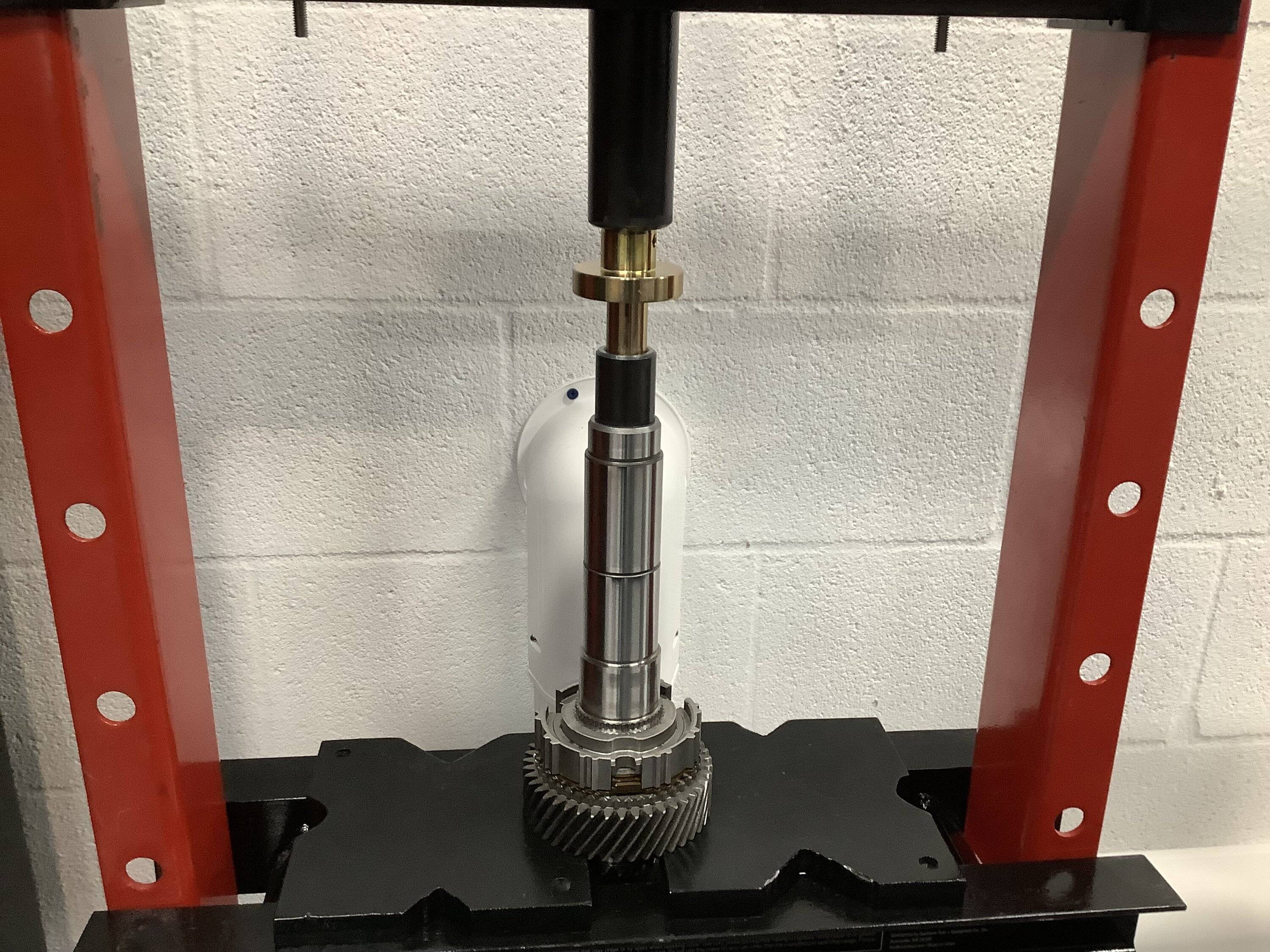

I’m not sure either in this situation. I may have to consider putting. Stress relief cut down the entire side of the gear, while being careful not to go through to the shaft. Maybe then I can throw it back in the shop press and it should let go. Of course, I’m always open to other options too.

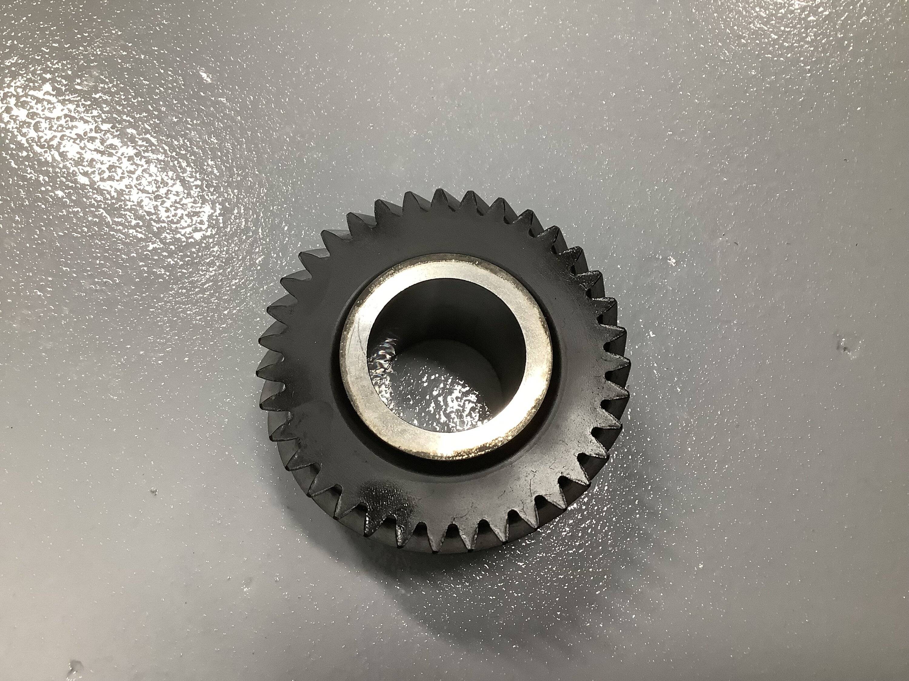

After “Rollin Down in the Deep” for a couple of hours today, I hit “pay dirt”, although it was at the cost of another gear. It wasn’t pretty, configuring the press plates in a way that gave me the clearance needed to get them off, but I managed to do so safely and without any further issues. With that being said, let me introduce you guys to Snag (AKA 5th gear). He’s missing the most teeth.

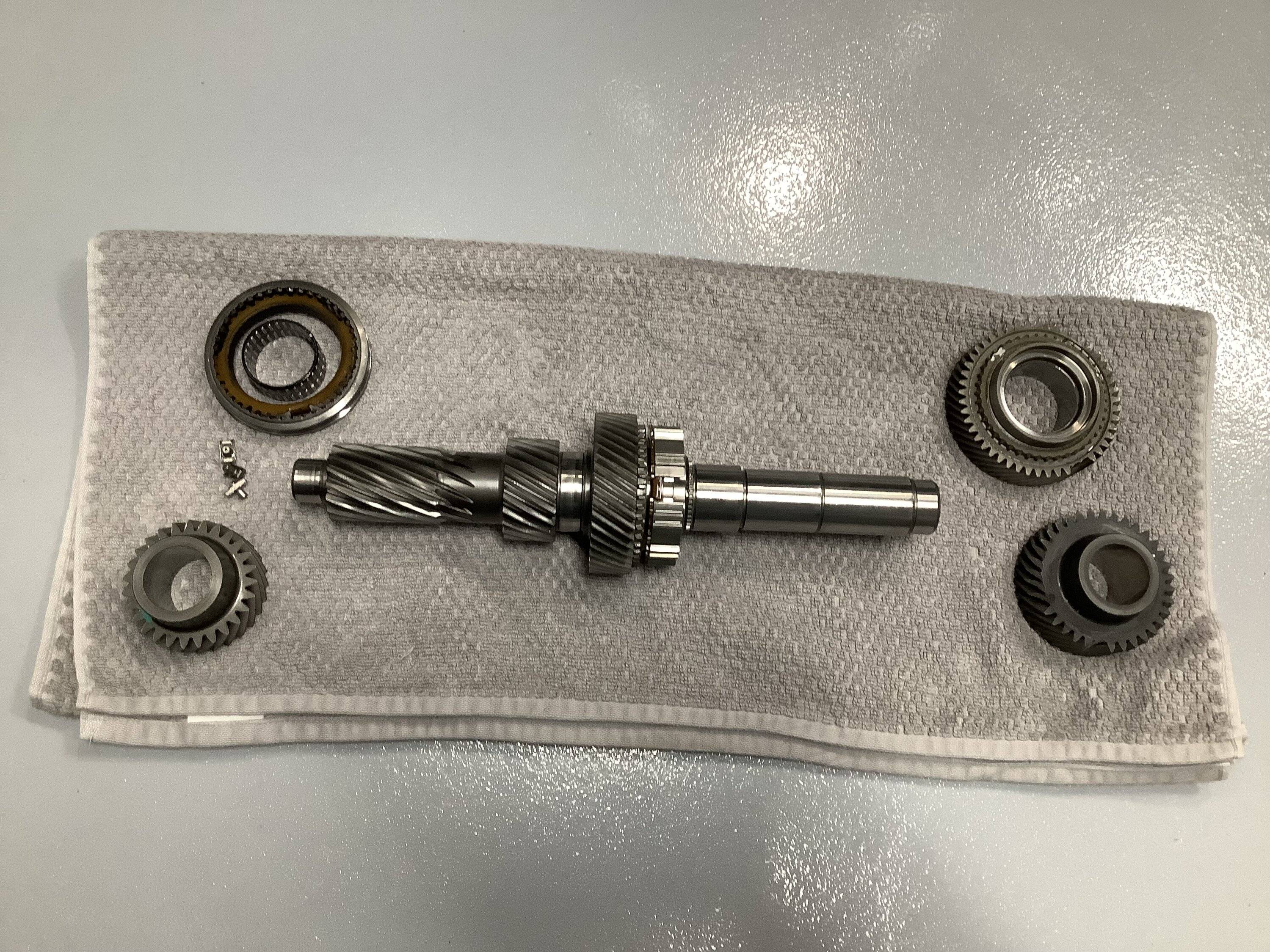

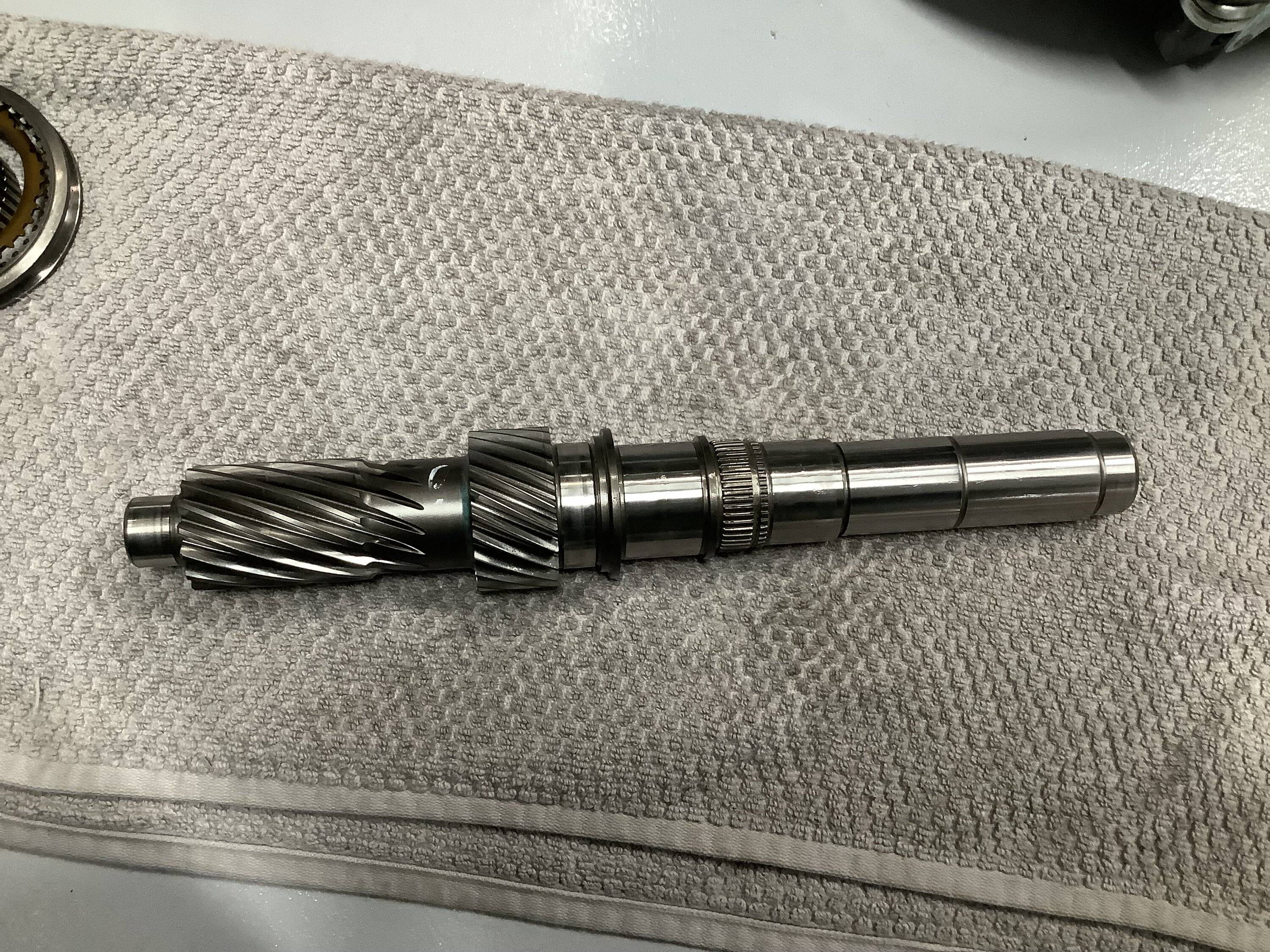

Snap ring, 3rd/4th synchro slider assembly, 4th gear, and both needle bearings have been removed. Note: This is as far as the shaft can be broken down.

Strange fracture pattern on Snag, any chance this is a powdered metal gear?
NGOT8R
NGOT8R
Jul 19, 2020
154
9,333
7,833
Adrian
2019 Bullitt
Yes, Snag actually does look like a powdered meta gear. Bucky looks to be a stronger gear, but has a powdered look seems more coarse.

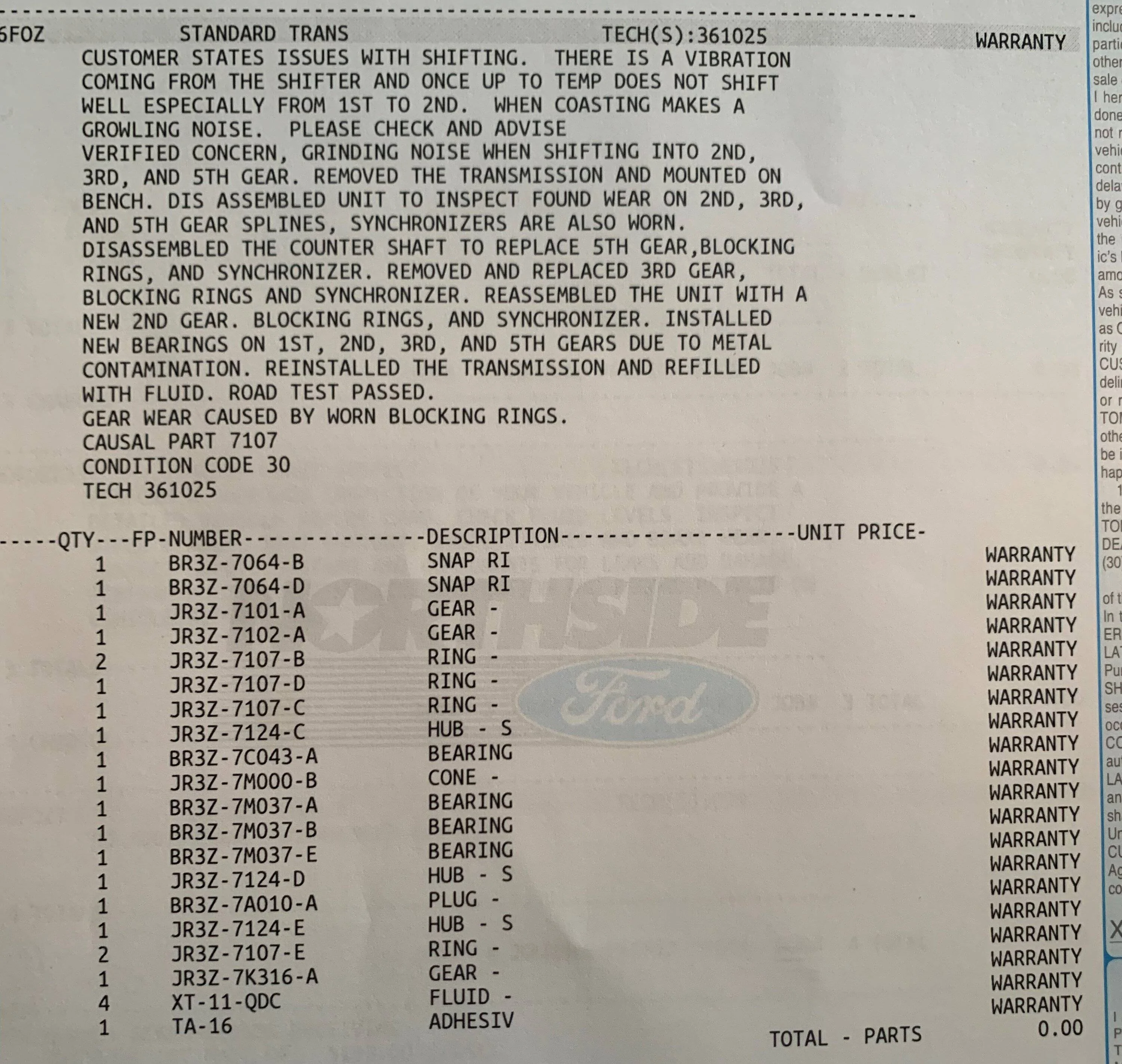

@stang1087, just confirming, did you have the countershaft gears replaced in your transmission?

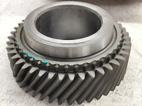

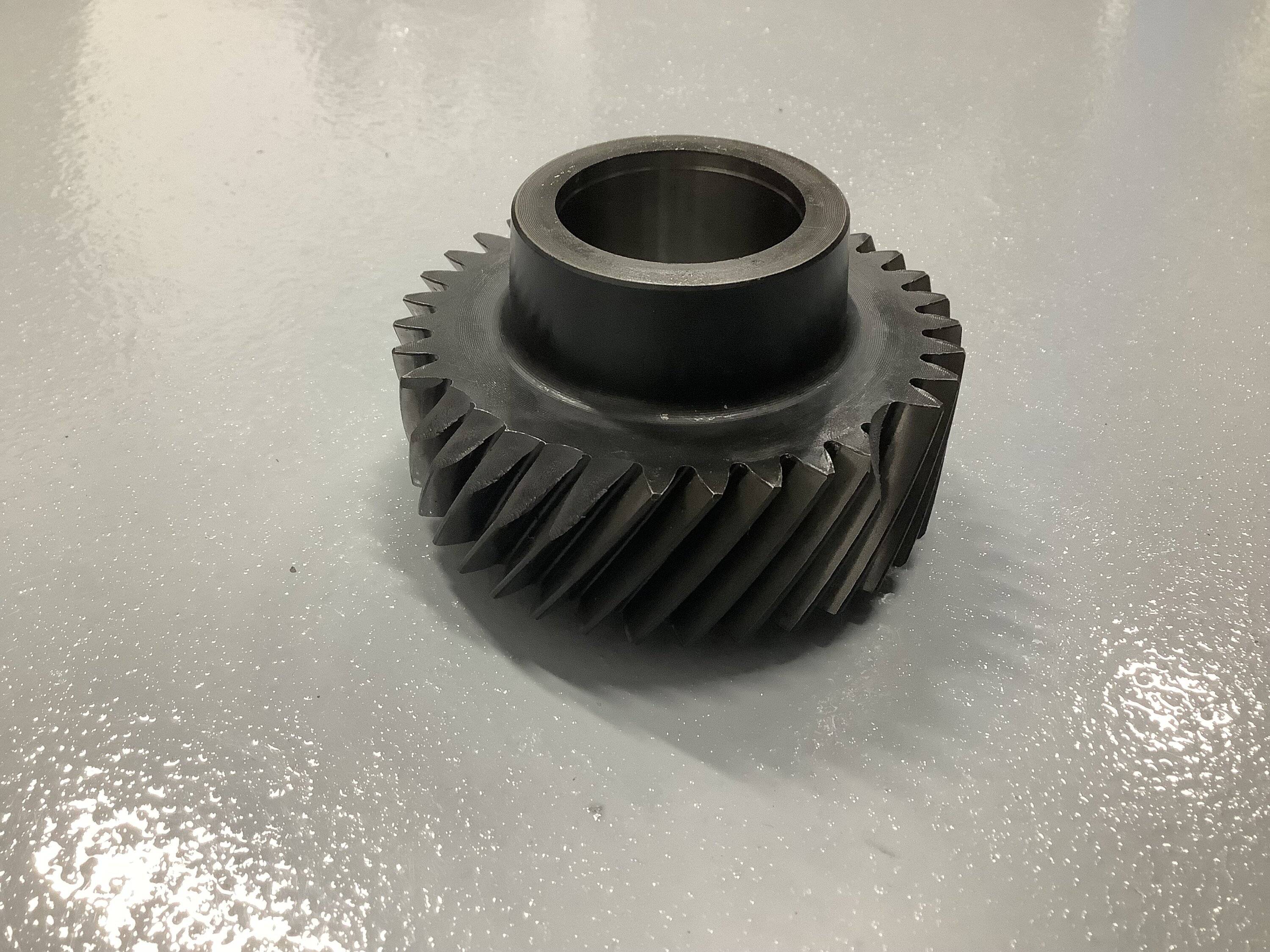

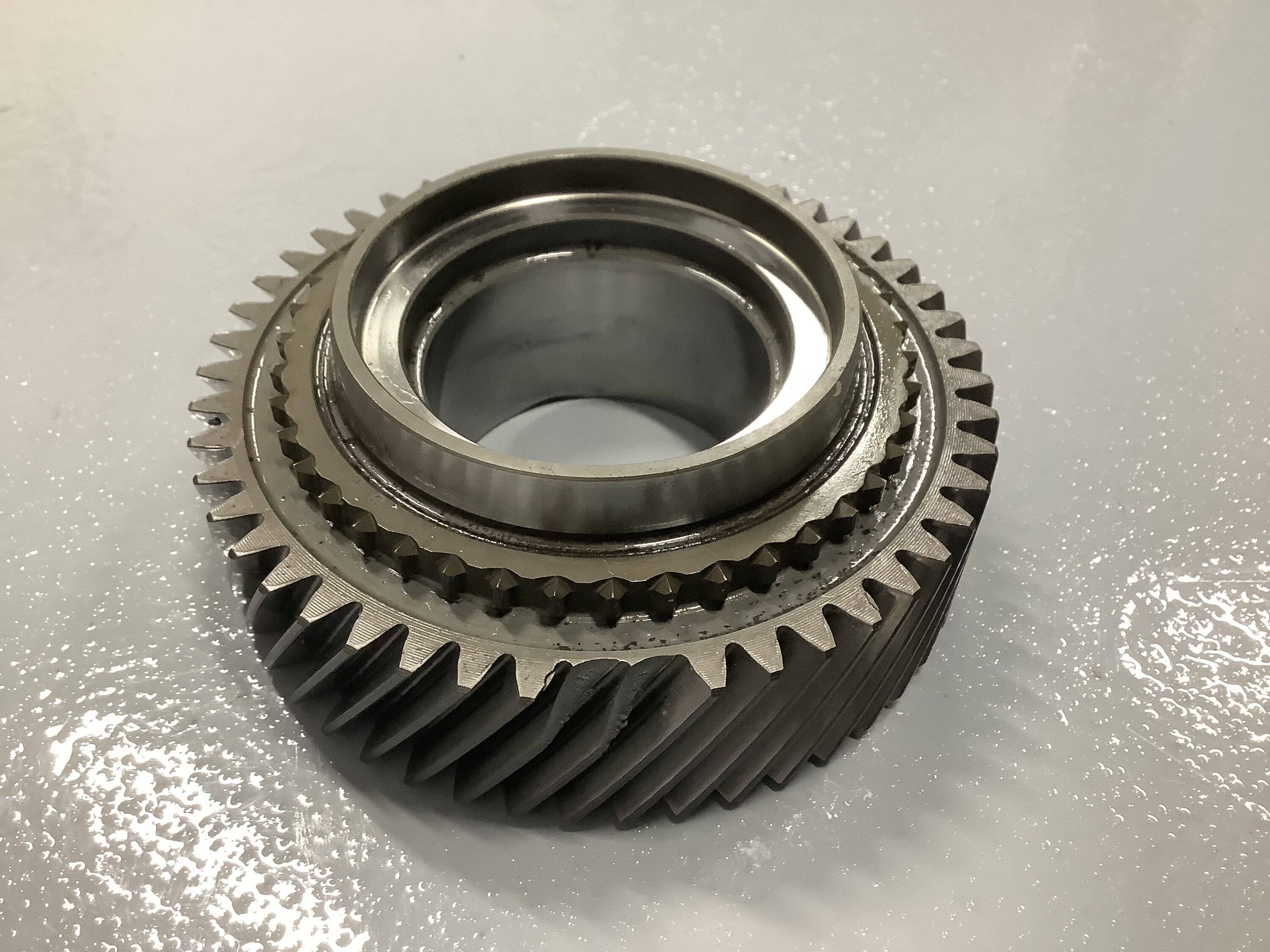

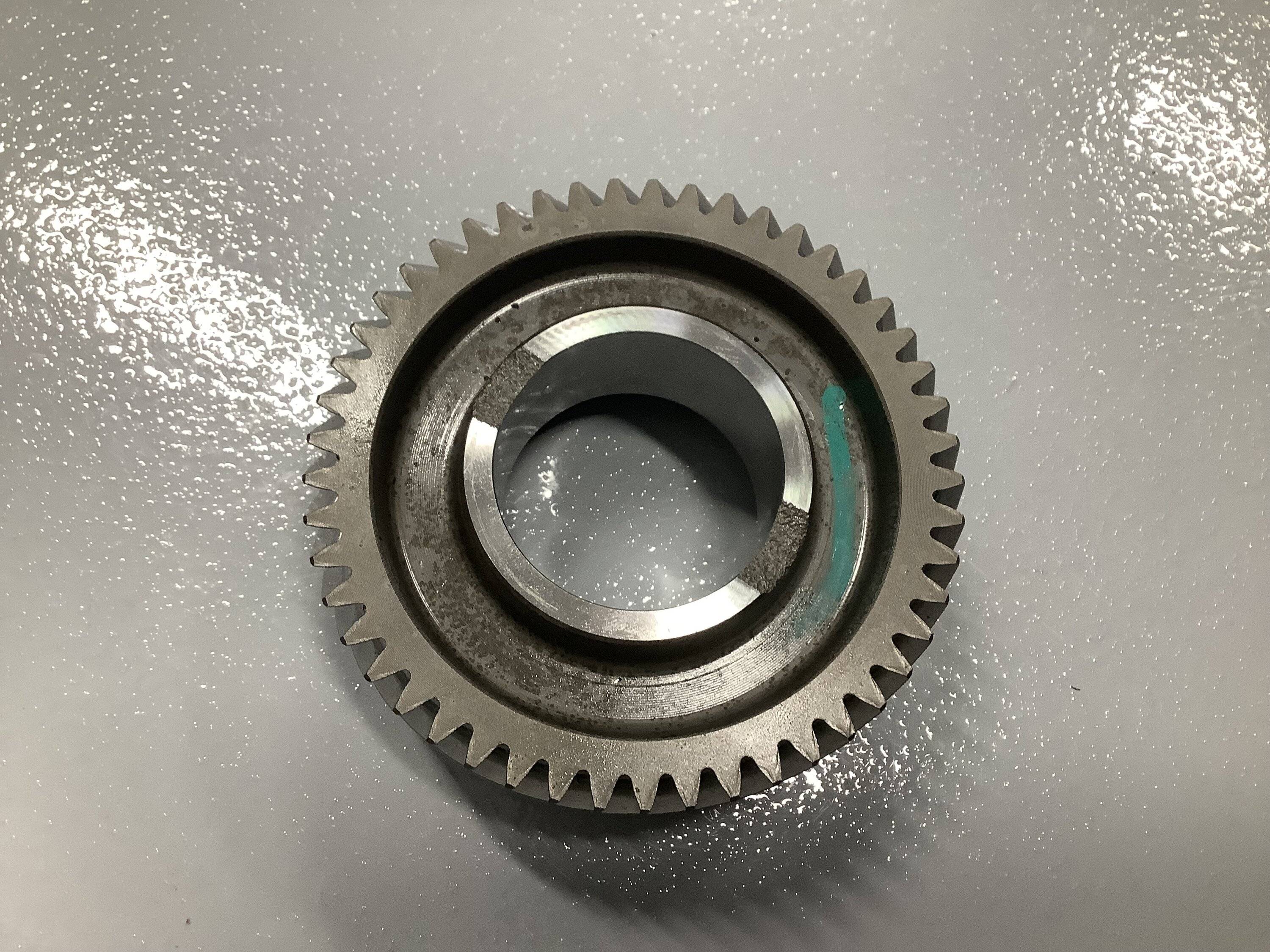

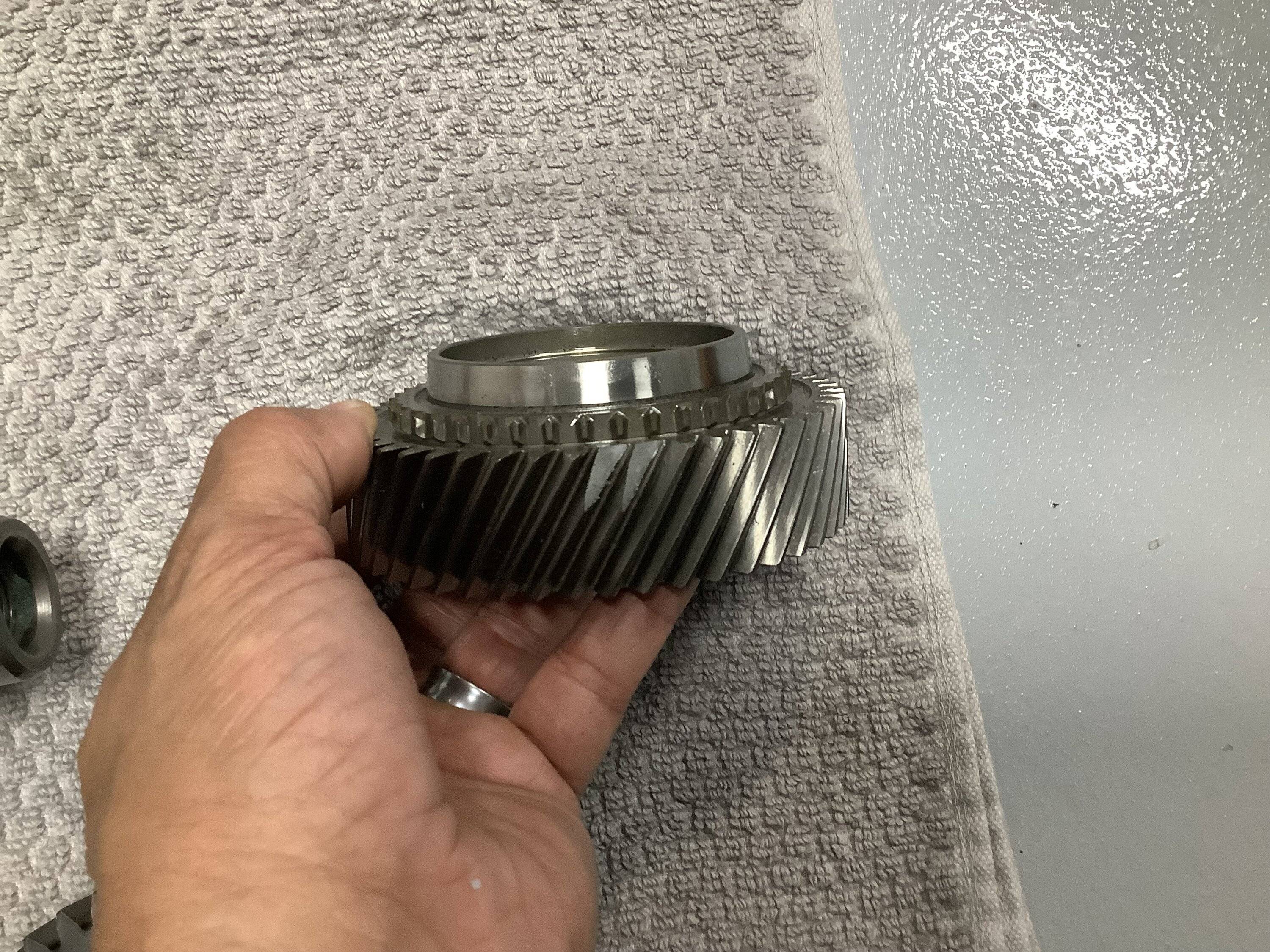

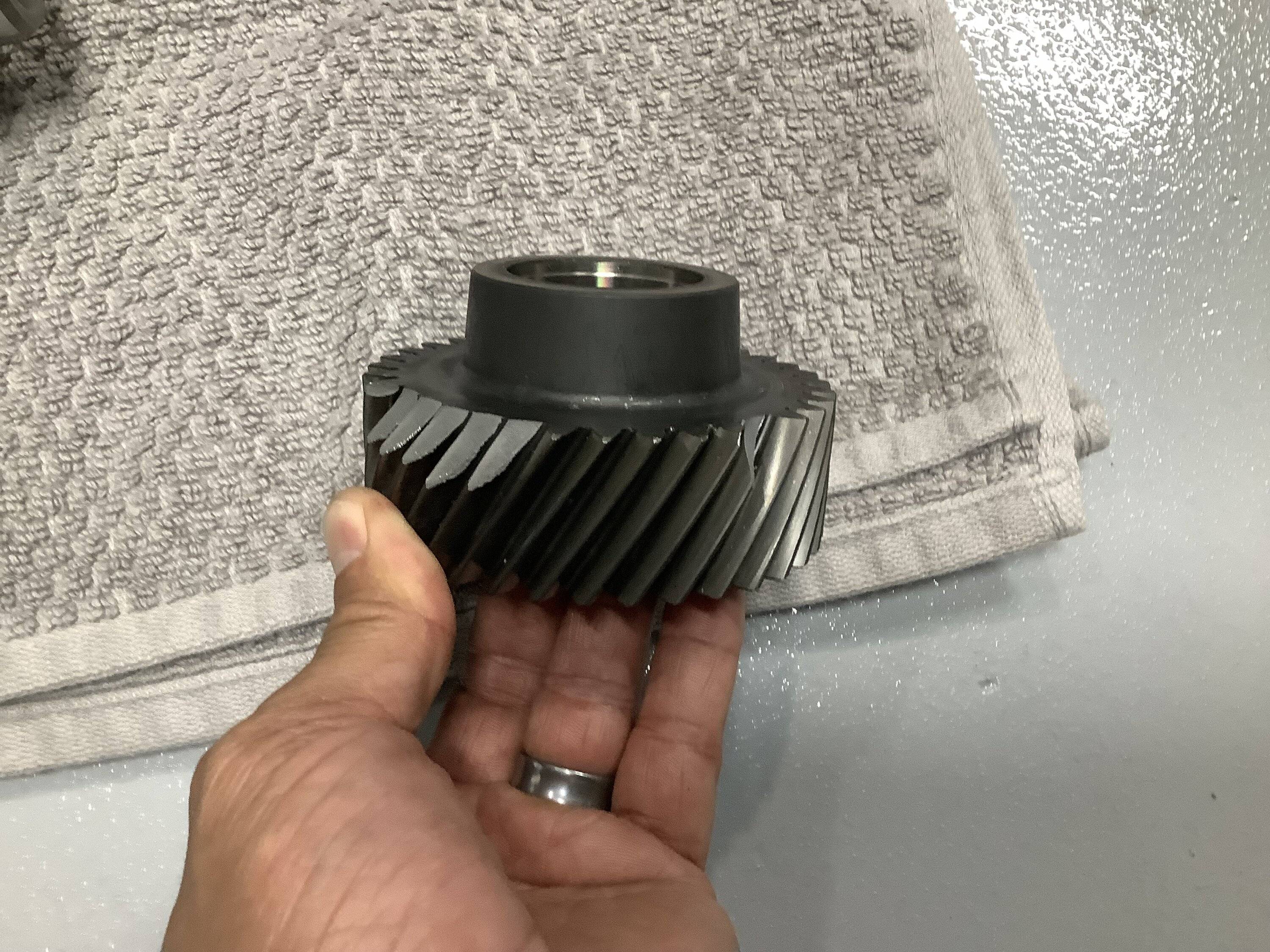

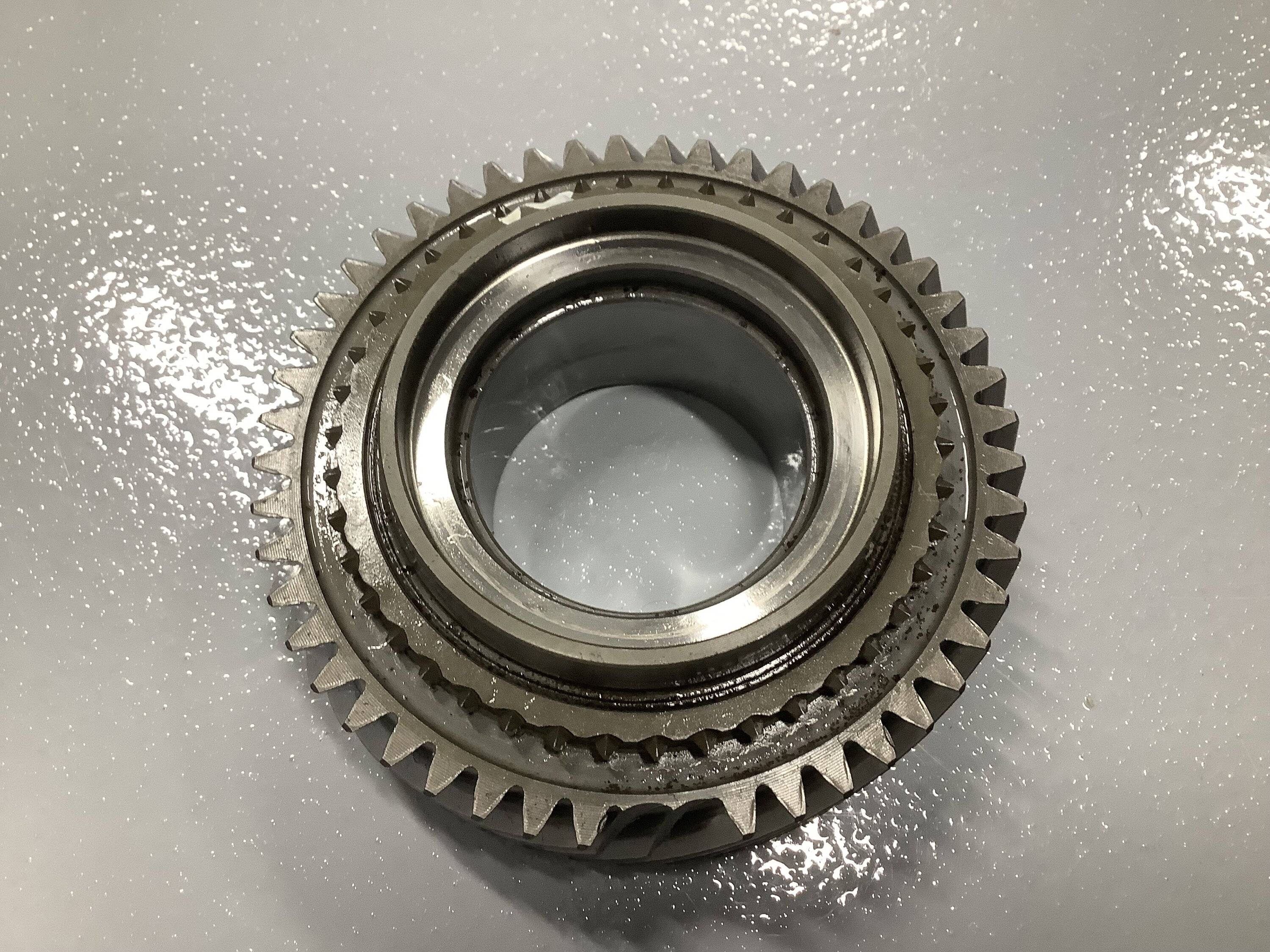

This is confusing to me, as Part number JR3Z-7K316-A, which is described as Gear 5th Speed Cluster, looks more like my countershaft 3rd gear and nothing like my countershaft 5th gear. See comparison photos below.
JR3Z-7K316-A (internet photo)
My actual countershaft 5th gear (different angles)
My actual countershaft 3rd gear (different angles)

@stang1087, thanks again for going out of your way to post the information that I needed. Although there was some confusion in looking at internet photos and the actual gears from my tranny, I feel confident that the info. listed in your RO is accurate. With that being said, I placed an order for the gears today. Hopefully I’ll have them by mid Nov. I’ll definitely post an update once I get them in hand.
