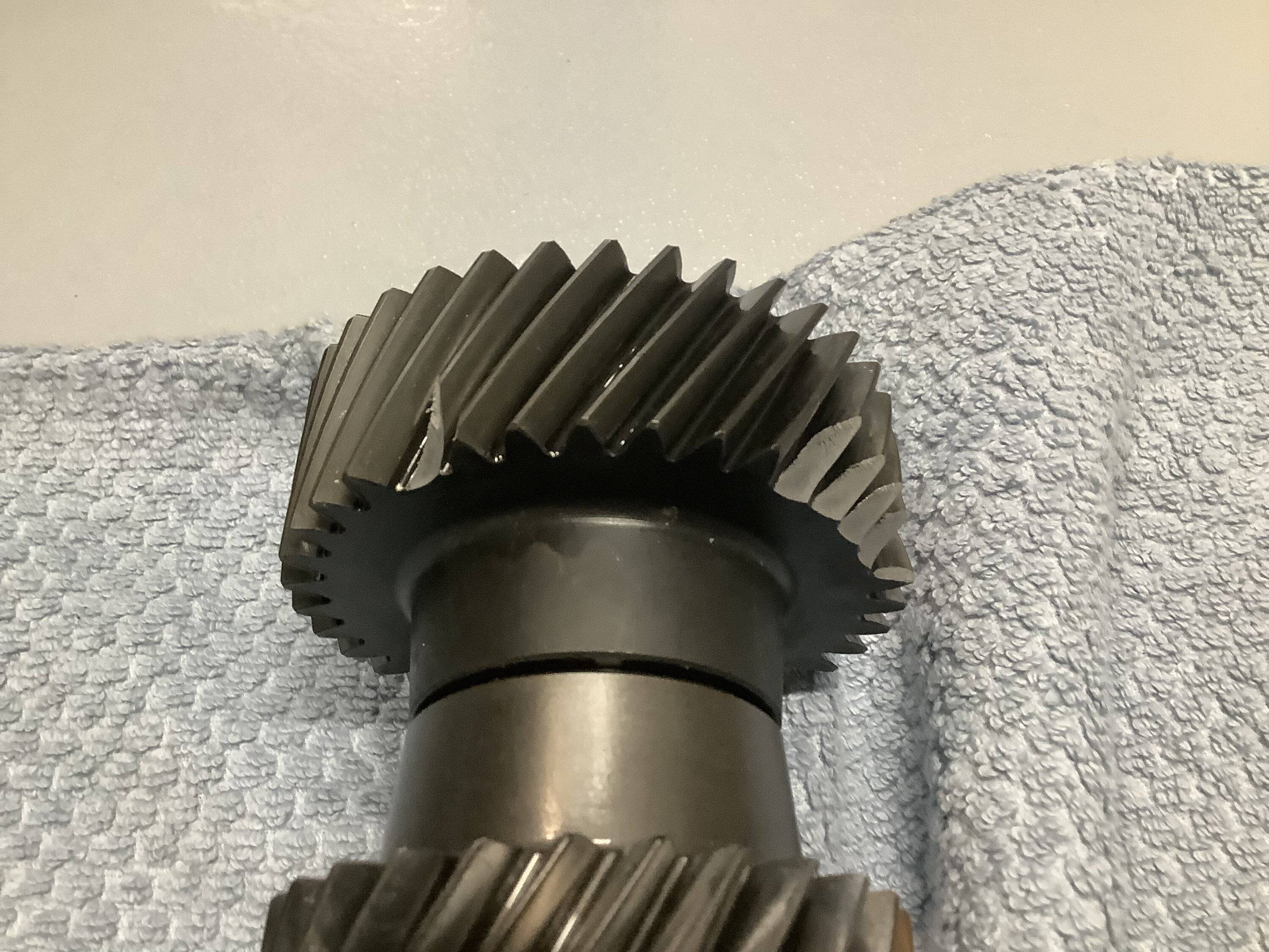

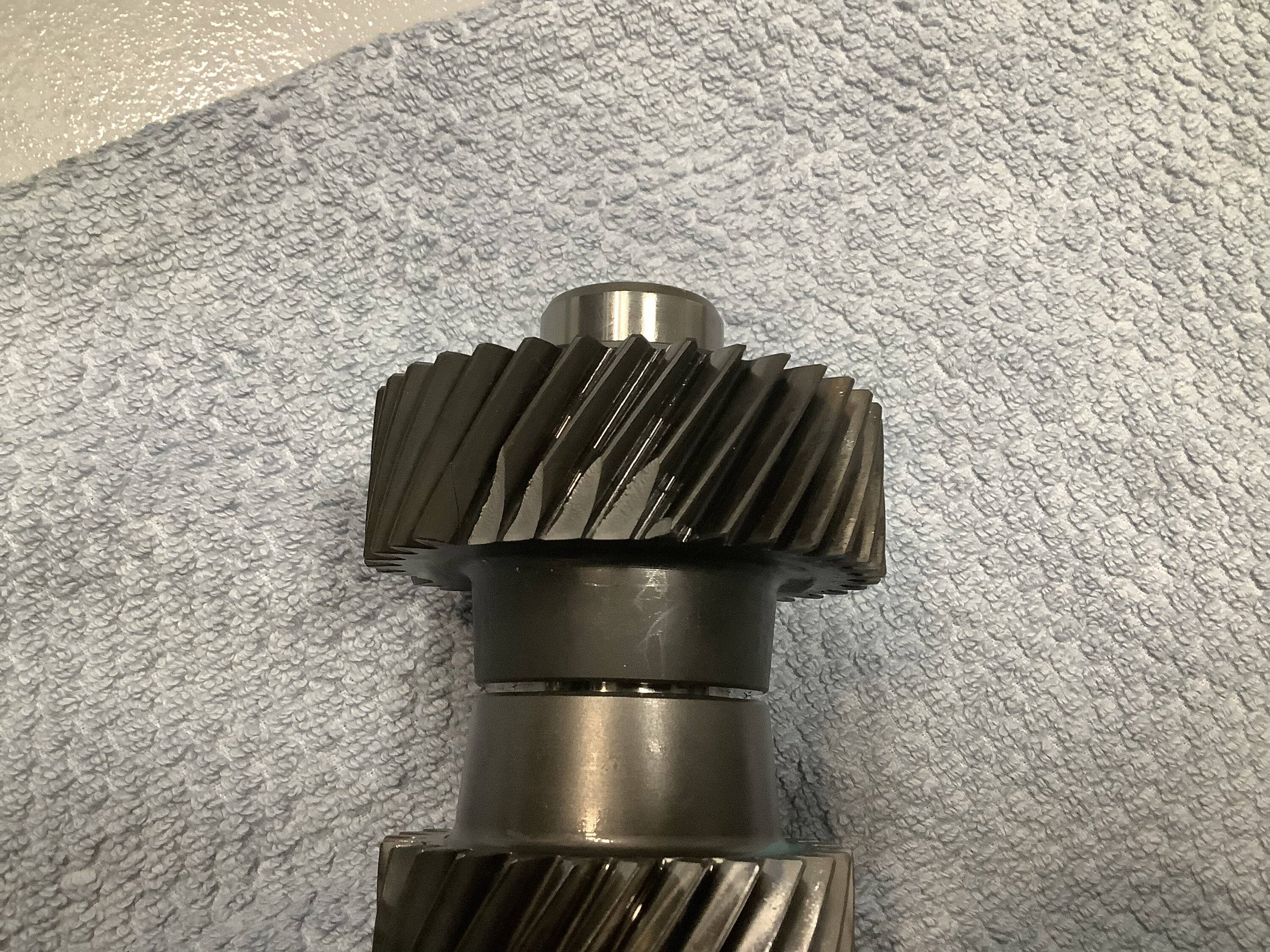

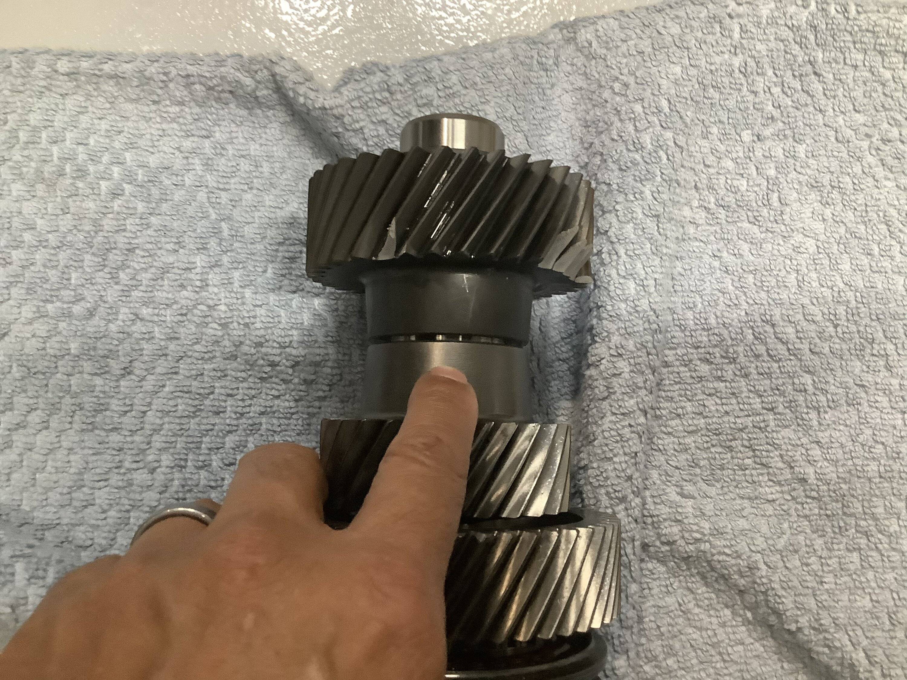

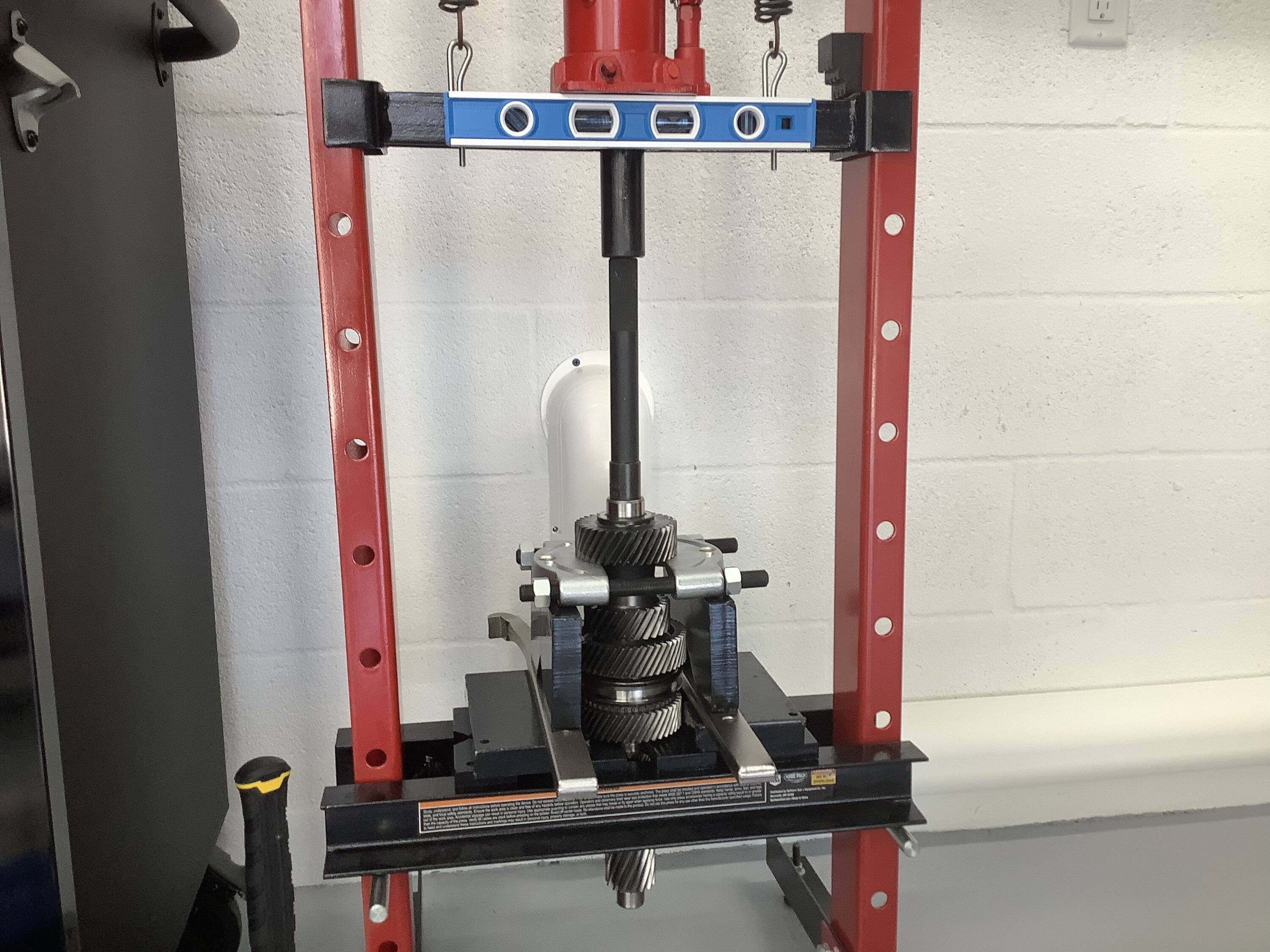

Uh oh!!! I was pressing 5th gear off of the countershaft and several of the teeth just popped right off of the gear. It only pressed off the shaft about 1/8” and wouldn’t budge anymore. Note: I had read that 5th gear was very week and brittle (Calimer even says so). If you look closely you can see that it’s dark in color, whereas the gear above it is gunmetal gray in color.
While I’m not happy that this happened, I’m glad it happened now and not once the tranny was back together. What’s on my mind right now is, I just need to get 5th gear off of the shaft, as well as the remaining gears, without any further issues. I hope to be able to find a stronger 5th gear, but if not, I’ll buy a new one and send it out to get it strengthened. My 12 ton shop press was screaming, as I tried to press the gear off the countershaft; so much so, that the uprights started to bow out. I‘ll need at least a 20 ton or more shop press to get these gears off.

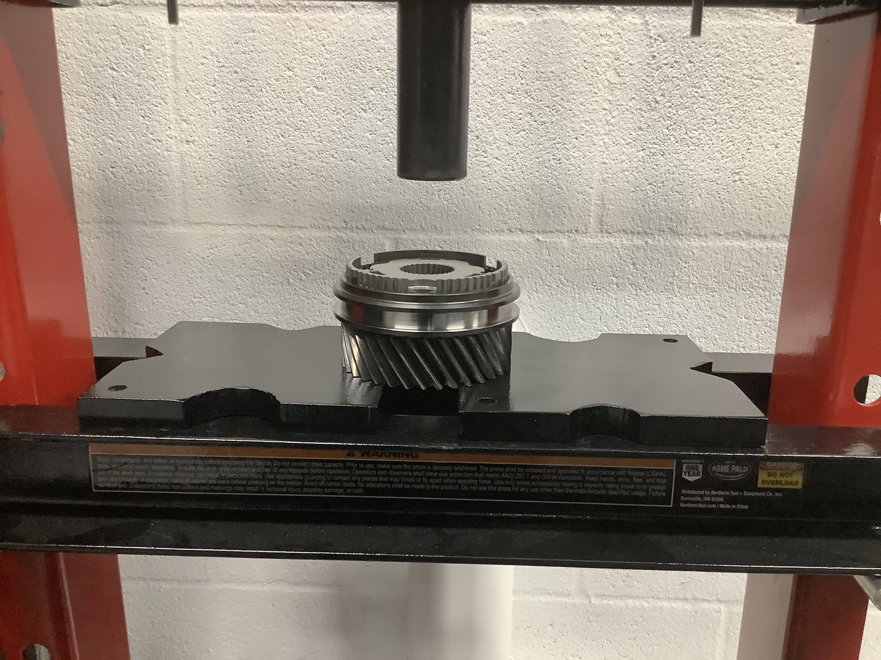

On a different note, I was able to remove the 5/6 gear synchro assembly from the output shaft without issue.

When can I drop off my trans? :wink:
After seeing your efforts, I'm convinced an extra trans is worth few hundred bucks.
Might need some half moon shims to keep the clamp and outer edge of the gear/ teeth from touching. At least on other gears

Haha! I have to get out of the weeds on mine and make sure it works properly before I could consider building others, lol.
That’s a good idea about the shims. If only I could just figure out a way to relieve the tension on the gear without damaging the shaft, so that it would press right off. The FSM says not to heat the gear, so I wonder if putting it in the freezer would be of any help?

Any suggestions on how to get this gear off of the countershaft would be greatly appreciated. i might sneak it into the freezer tonight and let get nice and cold and try again soon. The FSM said it could take up to 18,000 lbs to press them off, but if that were true, 12 tons should have been more than enough.
