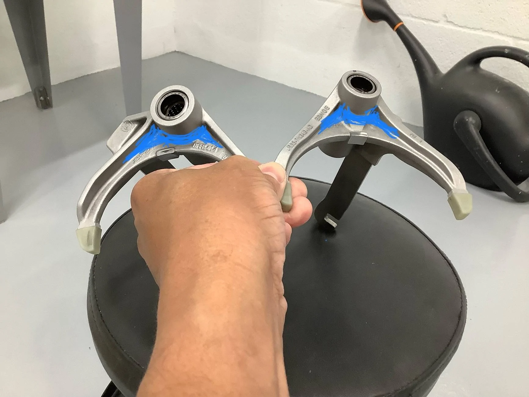

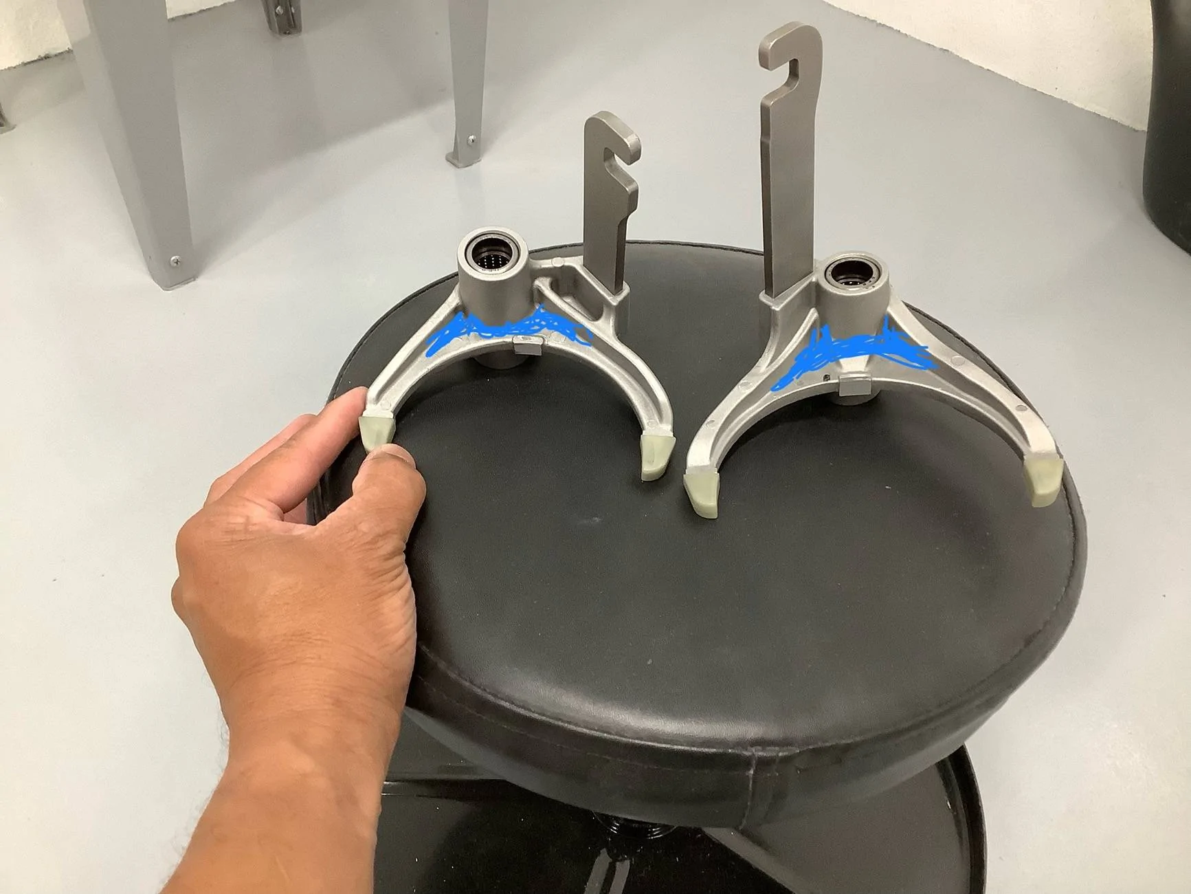

Here are my 1-2 and 3-4 shift forks. The areas highlighted in blue are what I believe to be the weak areas.
I believe a highly skilled Tig welder, who has experience in welding aluminum could weld up these areas with some solid beads and make them much, much stronger. Couple that with a cryogenic treatment and that should produce some solid shift forks.
I wouldn’t worry about strengthening the 5-6 forks, as most people probably won’t have the need to be shifting fast and hard into 5th or 6th, unless they’re running a 4.88 gear out back.
Nice! I'm all for putting some investment with someone who can build these too. Like a start up mt82 billet shop. I'm most certain there would be many interested parties wanting billet parts.
I was surprised on how many people break 5/6 gears components though.

Some water cut aluminium webs (easy to draw up with a sample shift fork in front of you), in a suitable grade, could be welded in position to really stiffen / strengthen that assembly up :like:
