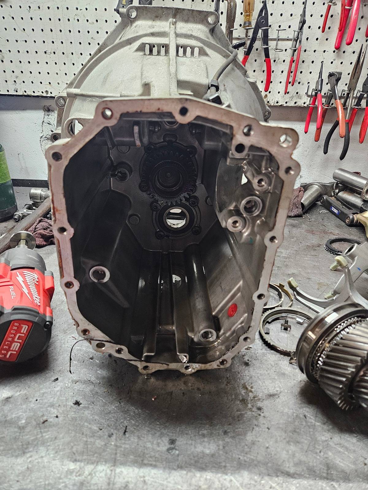

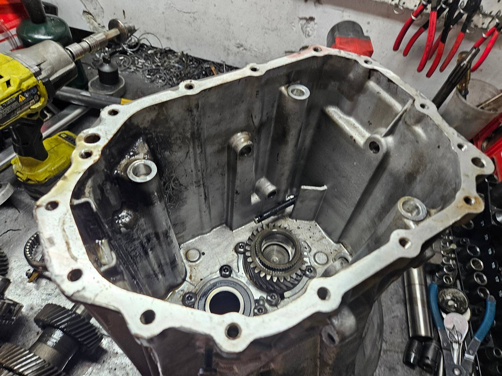

60k. broken 1-2 shift fork, worn 2nd gear engagement teeth and slider, bad 3rd gear engagement teeth, definitely needs replacement. Nothing catastrophic, mild wear. Definitely worthy of a refresh.
