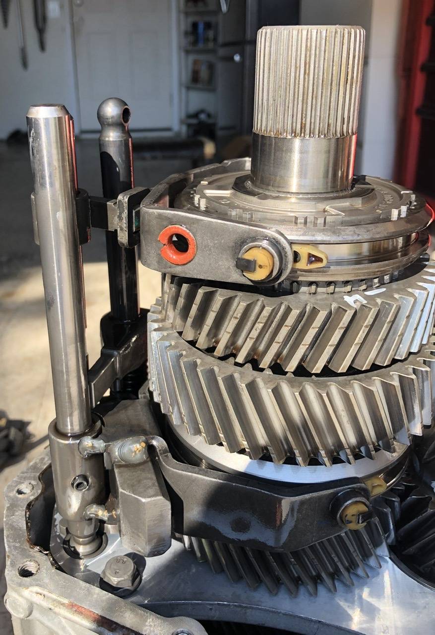

2011-2017 MT82 steel shift forks, which are welded in key spots to help strengthen them.

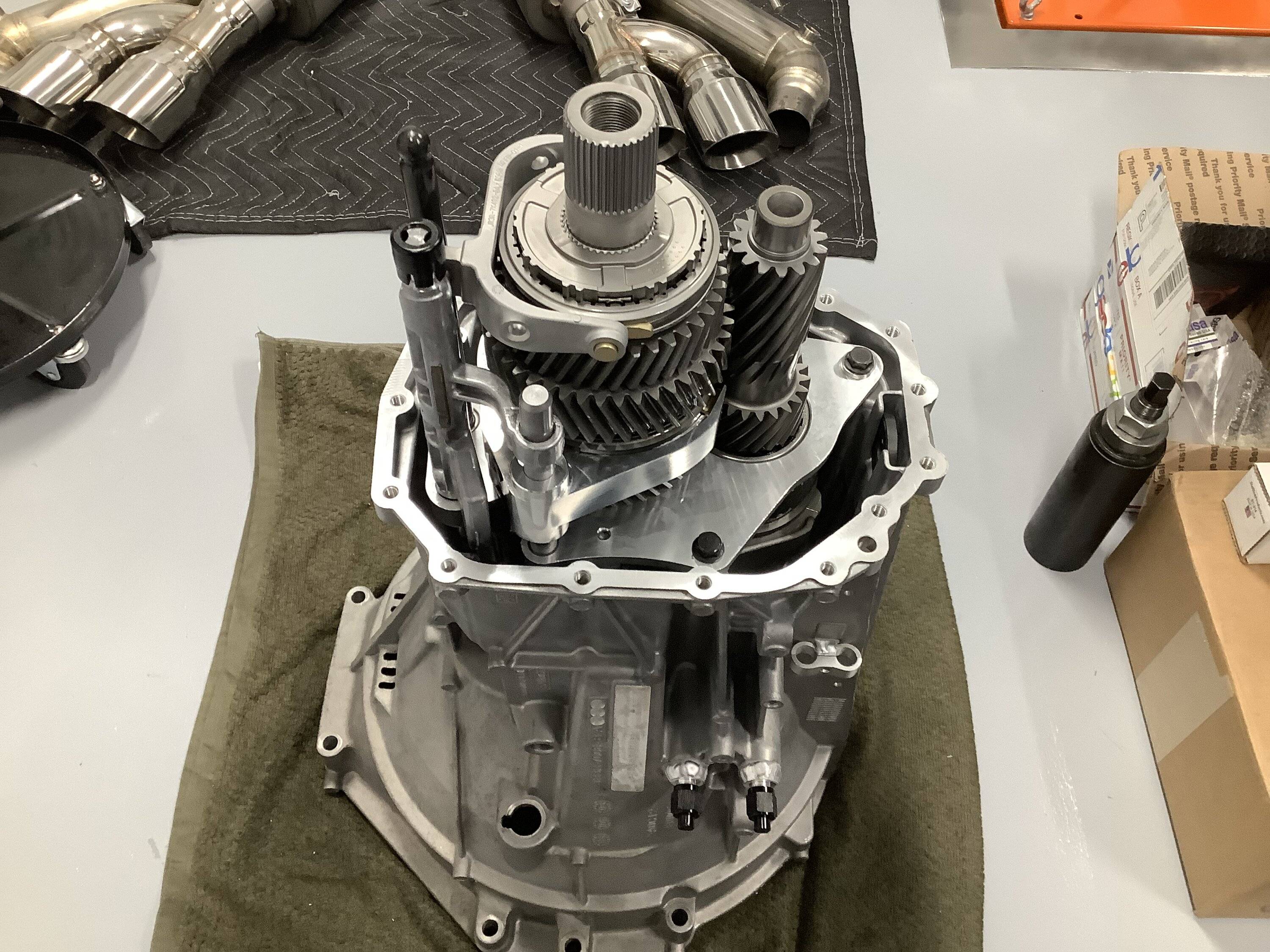

2018+ cast aluminum shift forks. The only upgrade here is to swap out the 1/2 & 3/4 forks for billet ones.

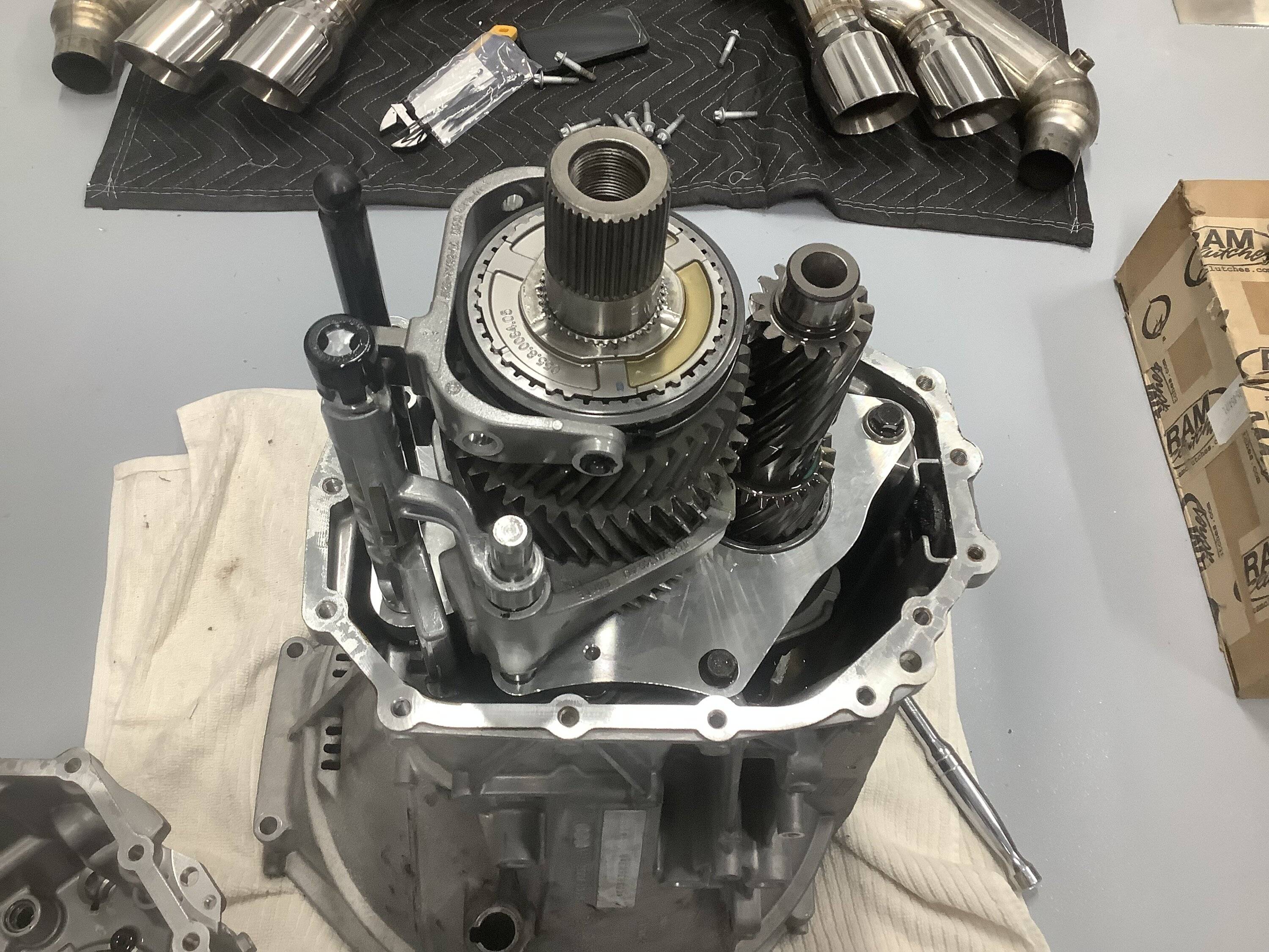

With billet forks installed. Note: Reverse, and 5/6 cast aluminum forks were reused, although the plastic shift pads on the reverse forks were replaced with bronze shift pads.

From the factory ?
The weld enhancements are made post factory. If you ever have to open yours up, I’d recommend doing it. Welded forks, bronze shift fork pads, plus already badass gearing will make a killer combo.

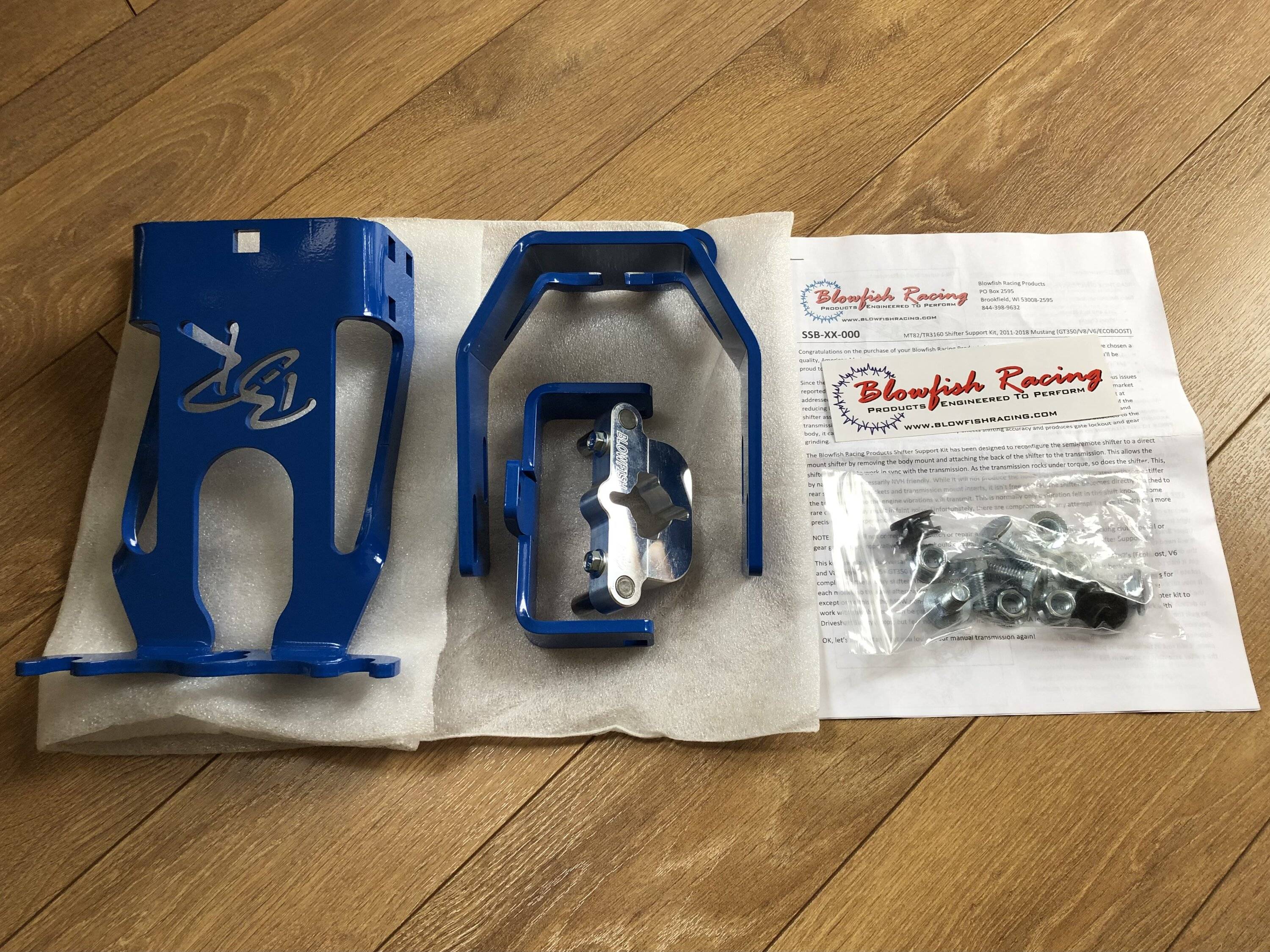

The first thing I added to my 17 with a MT 82 was a blowfish racing shifter support bracket. The bracket mounts the shifter to the trans to stop the misalignment during heavy throttle shifting and basically eliminates about 90% of the root causes of trans failures. The blowfish bracket is no longer made, but you can buy an aftermarket shifter that integrates a similar bracket into their shifter.
I've made several 7K rpm powershifts and never had a problem with mine, six years and the trans and clutch is still stock and never been out of the car.
You can still find them 'new' (not the slightly different / new one that's now offered on ebay) if you look and are patient.
I picked this one up off this board for a reasonable price (even including the shipping to the UK) quite recently :
Even an old second hand one from a salty state would be a good buy. A blast, fresh powder and a new bolt set would have it looking like new :like:

I'm wondering if your car has a 2018 production unit. The cast aluminum forks were a cost saving for the early revisions of the D4 trans, but they went back to steel forks at some point in 2019.

Not sure. I thought I had read that somewhere too, but haven’t heard of anyone else with a 2019+ that can confirm that.

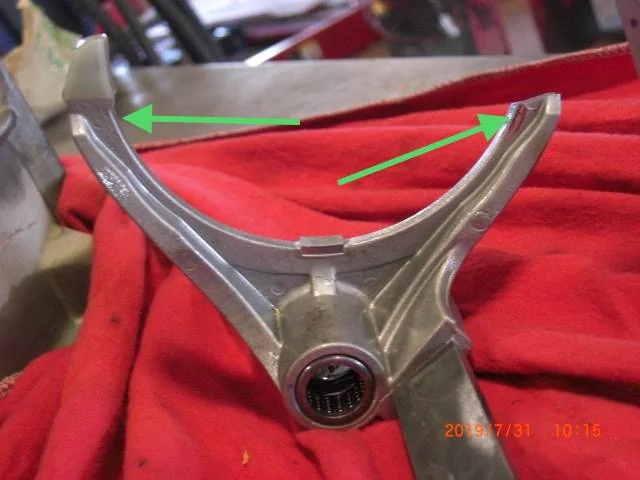

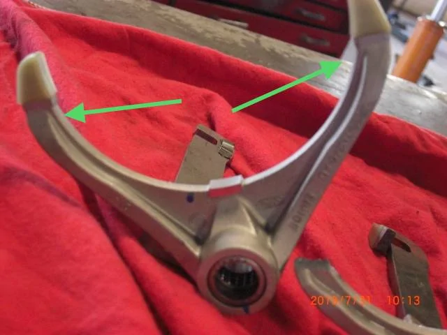

@ice445 I just did a quick search and found this pic of a broken 2018 GT shift fork on another site. It appears that the new and improved fork is still cast aluminum, but has been strengthened by adding more material as indicated by the arrows in these pics.
New revised fork
Old fork
While this is an improvement over the original 2018+ fork, I still think enhanced welding of 2011-2017 steel forks would be stronger.
I hated that I had to reuse the reverse and 5/6 cast aluminum forks in my rebuild. I will never speed shift into 5th gear knowing this.
