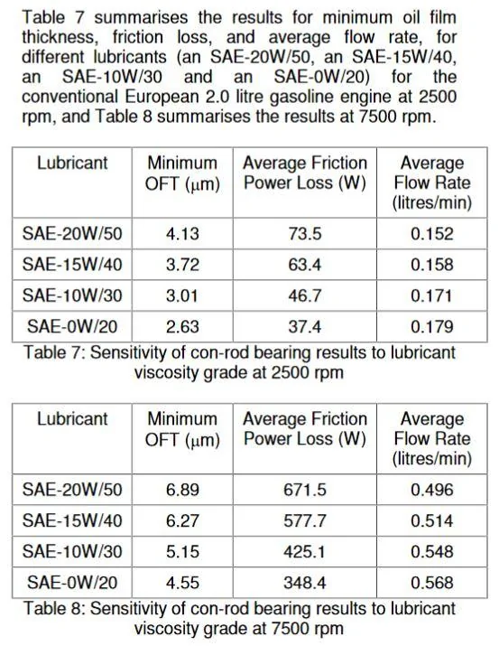

You might find this interesting. As you can see, the MOFT (minimum oil film thickness), which is what keeps the bearing from making metal-to-metal contact, increases with thicker oil. And yes, there is some increased frictional loss (more oil shearing) and slightly more temperature increase. But IMO, the MOFT is the most critical factor in keeping bearings from damage with elevated oil temperatures. The flow value shown is what the bearing flows naturally without a pressure fed oiling system (ie, positive displacement oil pump), so I'd suspect with the slight increase in oil pressure with the slightly thicker oil that the flow values through the bearings would be a lot closer to each other. Also notice that MOFT increases simply from RPM. That's why it's bad to "lug" an engine, especially if the oil if very hot and thin when the MOFT is the thinnest.
