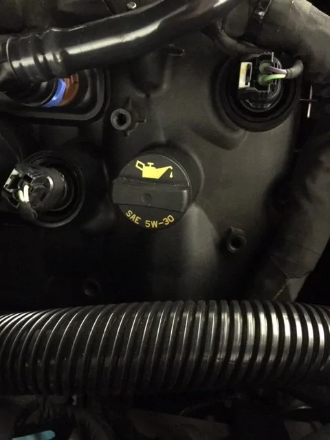

I'm going to switch to M1 5/30 (or most likely 0/30, for better cold lubrication) at the first oil change at 1K miles. In fact, my engine already had that change :D.

I'm actually going to switch to M1 0/30, for an even better 'compromise' :D. BUT the question is when. I'm at only 300 miles now. Does anybody know what kind of oil is the factory fill for GTs? My Bullitt has some GT350 parts, but assume it has the same oil as GTs. Not sure if it's a special 'break in' oil, or just the run of the mill semi-synthetic Motorcraft, and which grade. Does anybody know for a fact what it is? Thx.
Like many here, I was also thinking of changing it at 1K miles, but not set on that yet. I usually do it between 1K and 3K. On my 3.5EB truck, did it at 3K.
