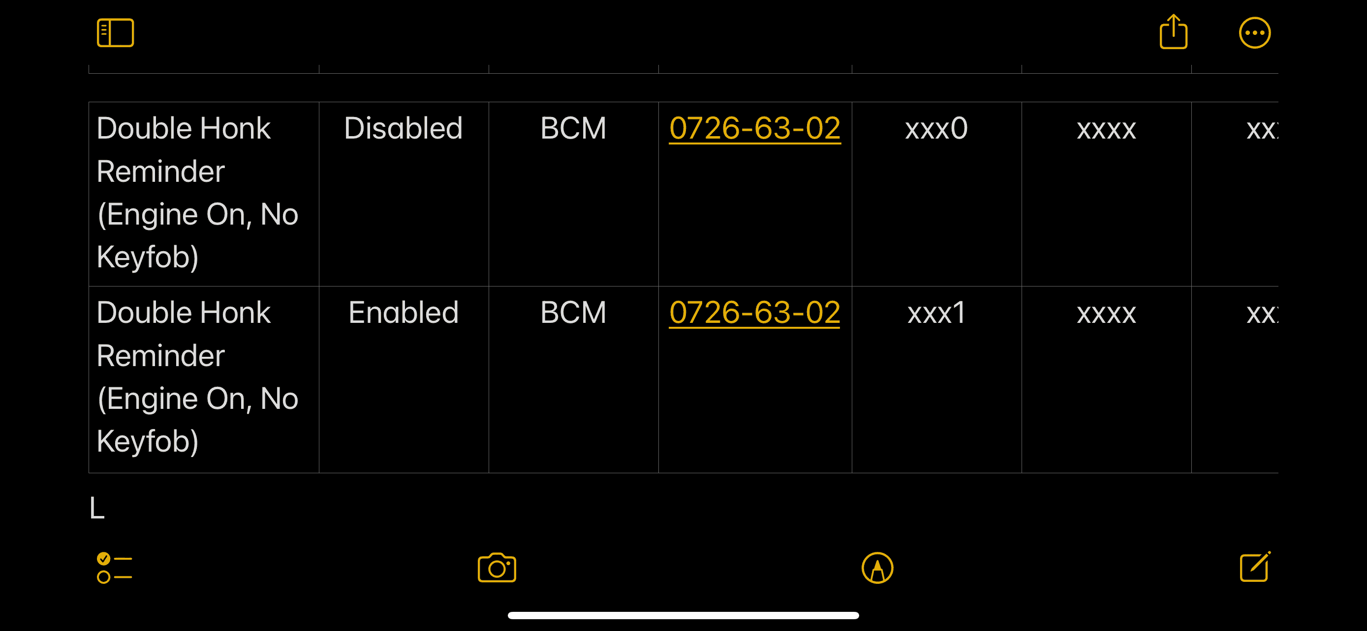

trying to turn off the double honk when I get out of the car, engine running, to go lock the shop. I went into 0726-41-02 and changed 2001 0000 0091 to 2000 0000 0091 and nothing changed. Is there an up-to-date spreadsheet? 2022 Mustang ecoboost, if it makes a difference.
This is what worked on my 22 for this.
It does. That code works with 2019 or earlier vehicles. There was a change in the BCM in 2020. See my answer from the other thread:
To disable the double honk I used the code I found in the online spreadsheet. Be aware that there's one code until 2019 and another from 2020 onwards. For 2020+ it's this:
726-63-02: xxx0 xxxx xxxx

is there a 2020+ spreadsheet somewhere that I ain't found?
No, I'm not aware of a spreadsheet that's specific to 2020+. But there's no need for one, as almost all of the codes are identical. It's just the BCM that has changed, and only a little at that. The double honk code is the only one I know to be different. There may be a few others, but not many.
