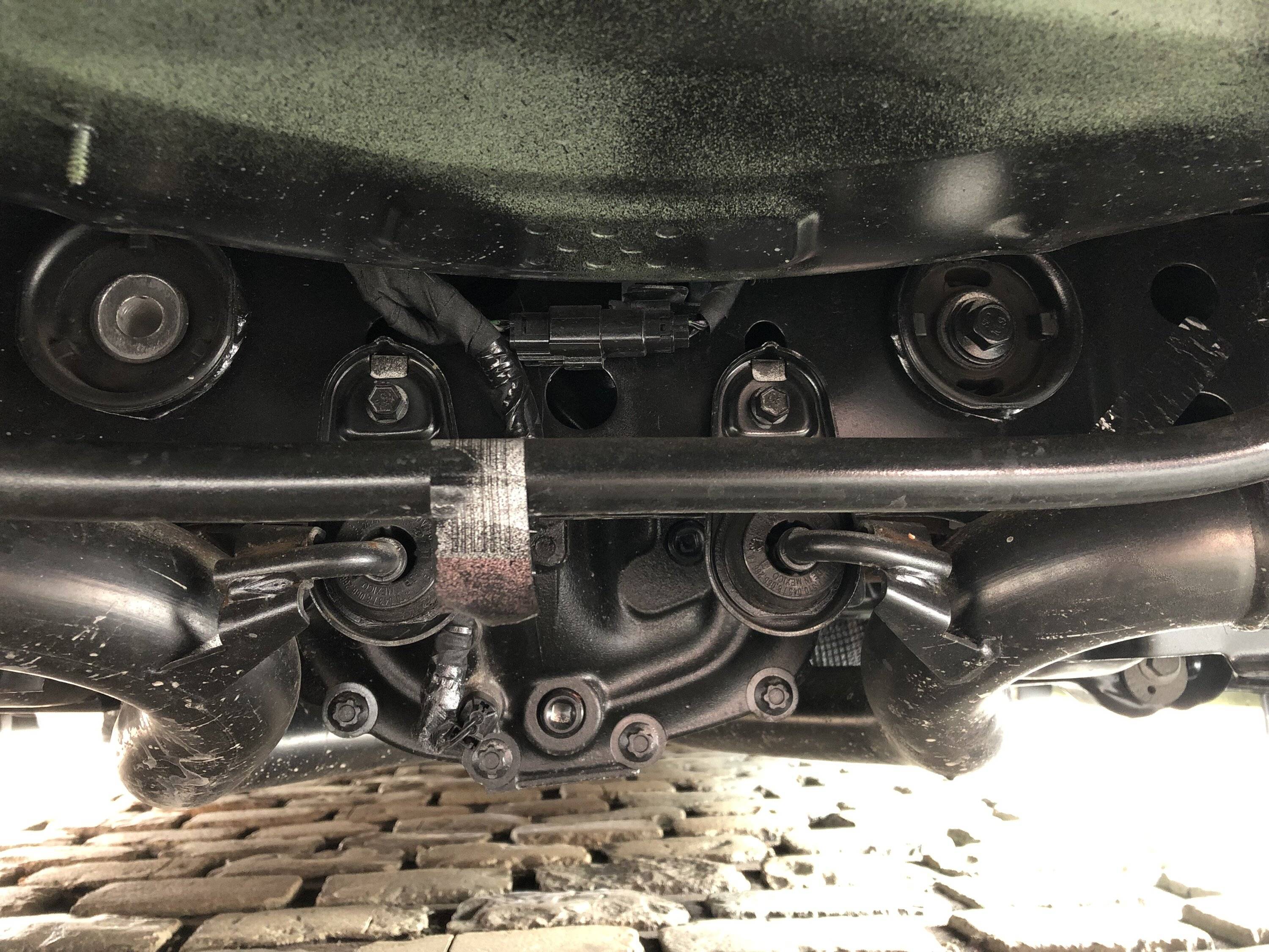

Have you guys looked underneath to check the diff to see if you actually have the sensor ? It’s on the bottom just to the left of the drain plug :
If you have the sensor but not the gauge, it’s ‘probably’ possible.
Based on my experience (2020 euro GT with digi dash), it was possible to turn the gauge on :like:

will check for this sensor tomorrow. Possible with analog dash? Or only digital?

Probably digital only. I have a 2018 and I had the Forscan setting to have axle temp. A bit of a non event. Takes forever to register much of a temperature increase and never while I had the gauge showing did it go high. I don't track it though.
