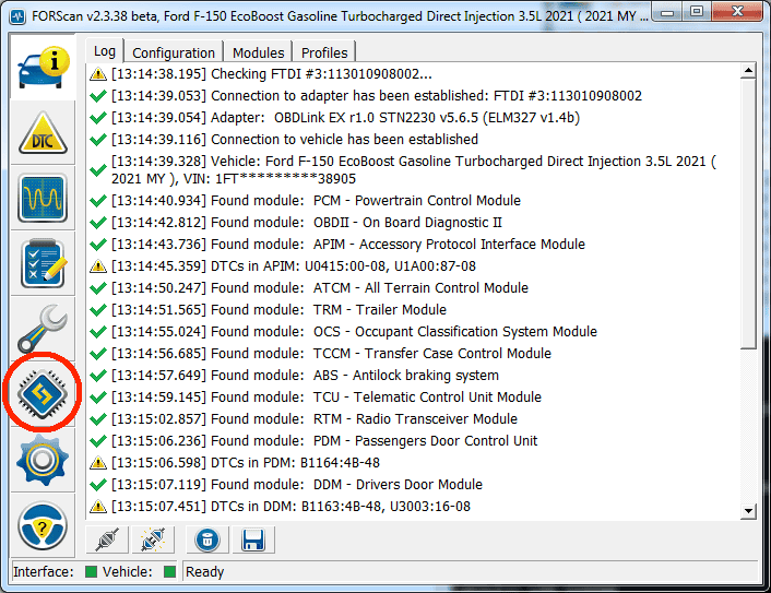

I'm trying to turn off the very annoying double honk when getting out of the car/engine running. 22 Mustang ecoboost. I'm in forscan now, and in the 'vehicle tests' but the only bodycm that shows is a module reset. Obviously I don't need to reset it, I need to modify it. On my other car it has a line that says "bodycm as-built" and I choose that and go into service functions to modify. I don't have that option on this 2022.
Is Forscan not updated yet? Or Is the car locked down tighter than a drum where nobody can do anything with it?
It's not in the tests, but in the configuration screen.
If you don't see that button in the left panel, then maybe you don't have a proper licence. Most of the functions are available by default, but the module configuration feature requires a licence. See the ForScan web site I linked above for information on how to obtain a licence. You can buy a lifetime one, or you can request a free temporary one (which can be extended for free, too, when it expires).
I have a license.
I have that button. There are no options for bcm other than reset it. I can get into the apim but. not the bcm
