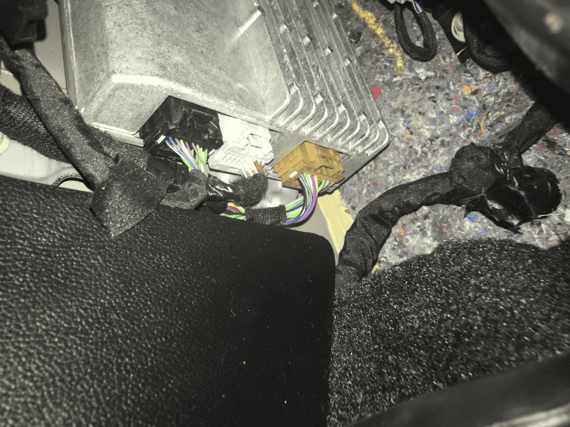

Yes. It will reset the amp as it controls the level of the chimes. Car doesn't have to be running. Just open the door and within a few seconds unplug the brown one. All you need to do is make sure the amp gets power cycled. Then press the start button then plug it back in. Just adding that you want to make sure you hear the tones come from the dash before you plug the brown cable back in.
That sounds like the better method.

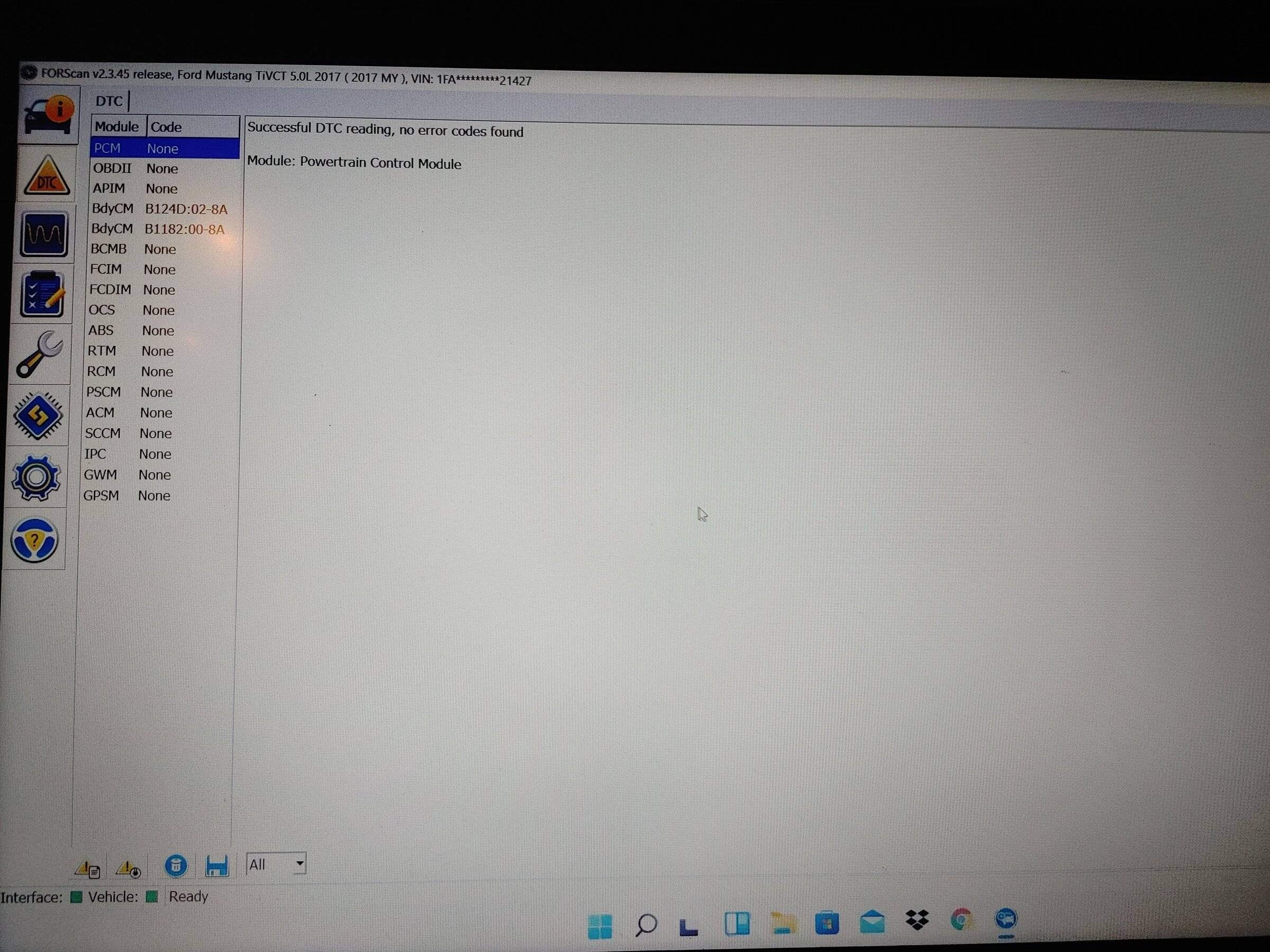

Man I shoulda got this awhile ago. Did a gear change, tire circle & fogs with highbeam on. Followed the instructions to clear the p160a.. Jackpot !
WildHorse
N/A or GO HOME
Jun 28, 2017
270
10,297
8,350
Home World: CLASSIFIED
Puddintane
'17 S550
Confirmed working on 2017 Mustang GT 300A car
Can confirm this works 100%. I tried changing it through FORScan to go thru IPC but I get a error and interruption when trying to flash. Probably need to wait for a new update that works better with the 2022
MrBD1348
Dec 12, 2021
427
439
Chicago, IL.
'22 GT MT-82
I take it back. Left the car for a few minutes. Came back turned on the electronics and it’s back to speakers at full volume.
EDIT: emailed FORScan and they sent me an update for the software. I am now able to write to the IPC module and all chimes have been sent to the cluster speaker and shortly after disabled. :)

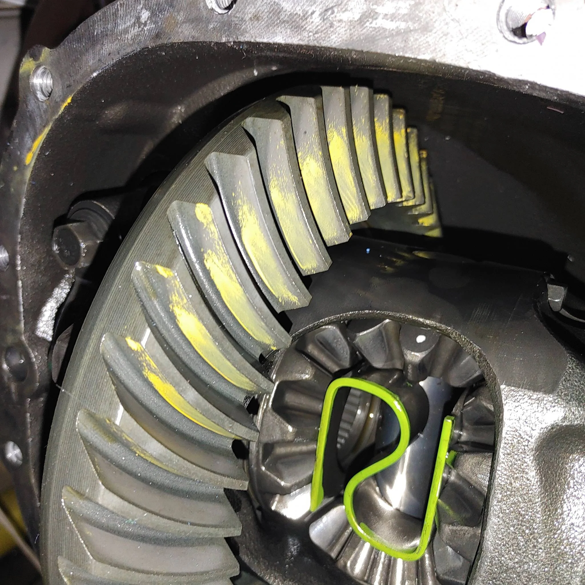

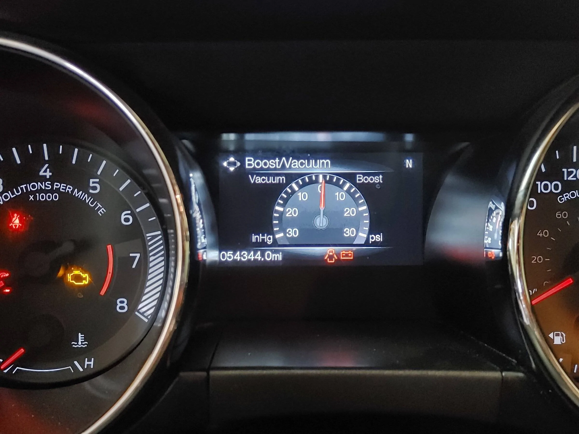

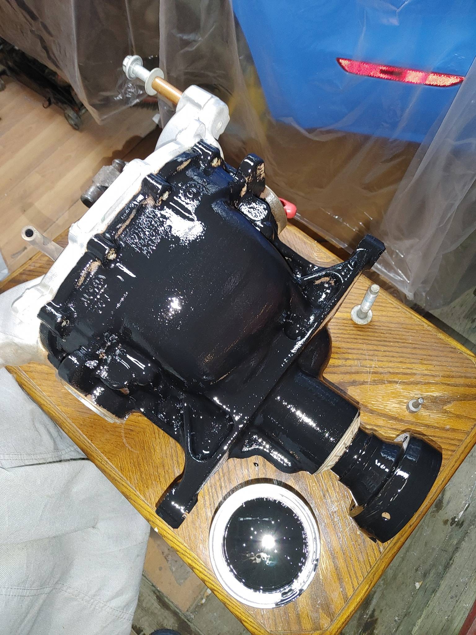

So for my 2017 GT base 300A;
~ gear change from 3.31 to 3.73 - confirmed working
~ tire circumference 2049mm to 2029mm - confirmed working (had to force PCM relearn)
~ fogs on w/ high beams - confirmed working
~ added vacuum/boost gauge - confirm working
~ disabled the TPMS in both IPC & BCM - confirmed working
Zero DTC.
Zero DTC.
Went back to pg 219 and reread all of your recent posts. I didn't see any mention of a gear change.
I'm going to be that ass that asks... You did actually change the physical gears, right?
