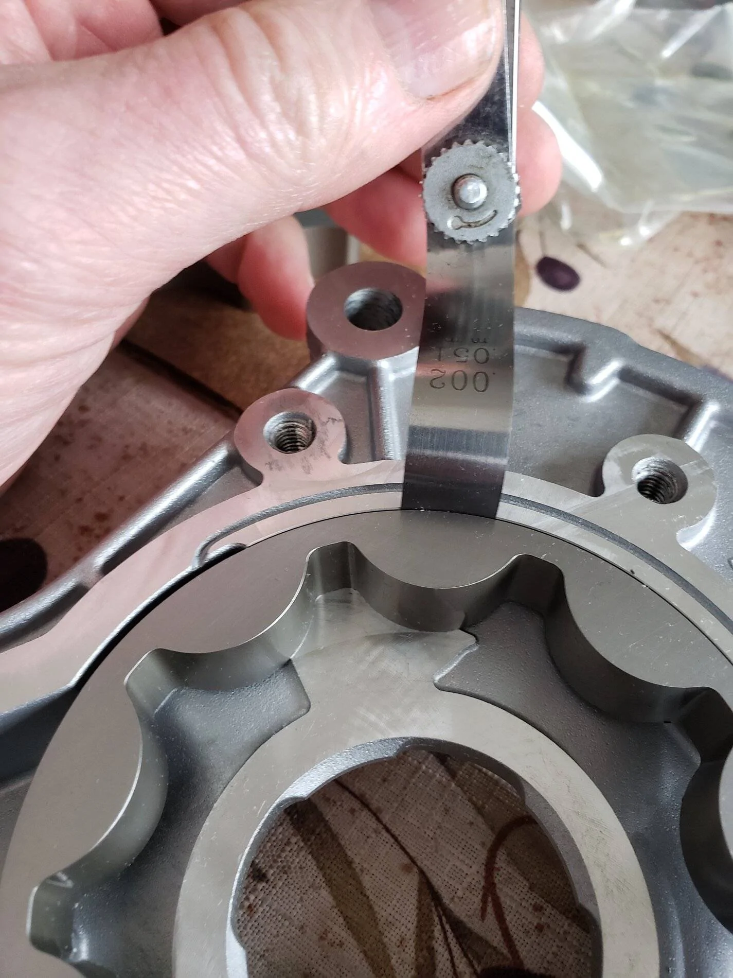

So I just tested my unused Boundary OPG and below are the results. The tester is within calibration and was verified with a calibration block prior to the tests.
Yeah, that's what the standard product runs. We keep all mill spec on our product for the last 20 years, along with all clearances for each pump and gear set since it's 100% inspect. All we need is the serial number to verify.
Martenwear gears use a progressive heat treat that surface hardens the gear to hrc 55-60. Those run 299.
I actually think for a core and good wear surface hrc 30 to 40 is ideal. The gear will deform before cracking if something large gets in it giving you time to shut it down.
Most of the gears you see damaged on the market are caused by debris, but some are clearancing issues or hardness related.
From our research
16 to 30 is 8000 or less
30 to 40 is 9000 or less
40 to 50 11000 or less
And our Martenwear have tested out to 13,000 which is 55+. We haven't found any takers going higher.
These can vary because of two step use, line lock, heavy crankwalk caused by extreme levels of forced induction.
If anyone has any questions happy to help.

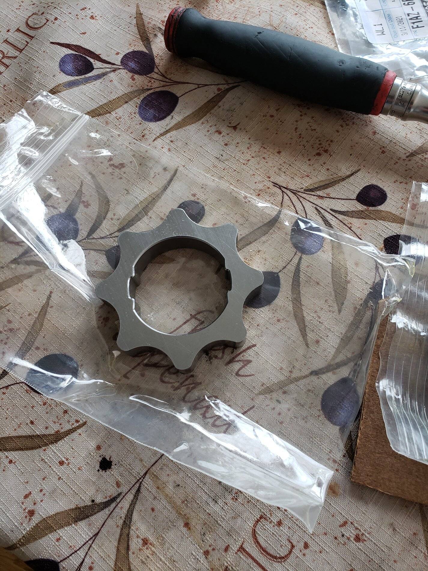

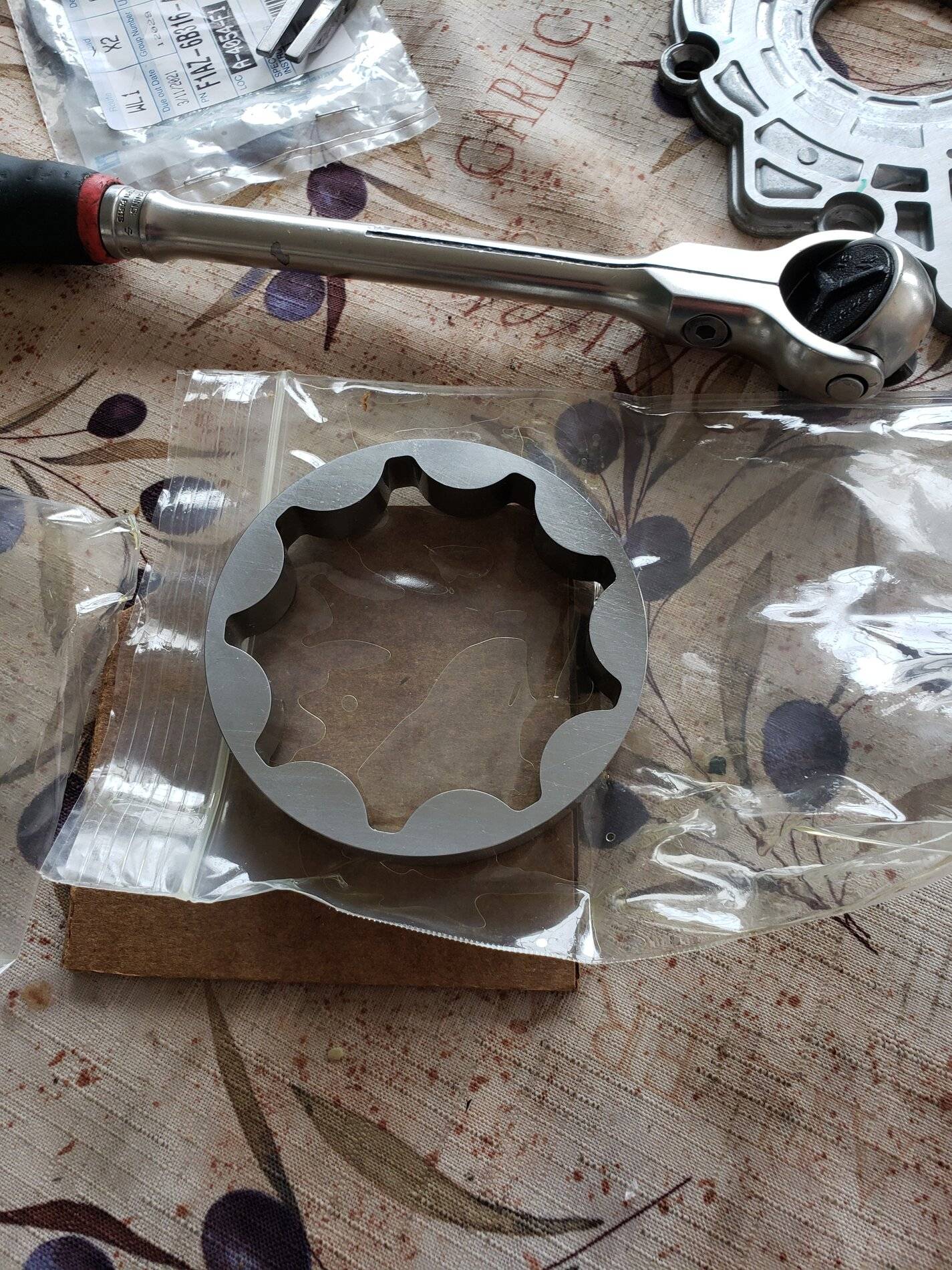

So Fedex came through fast as fast can be and the TSS gears just showed up. Sadly my machine shop closed 10 minutes before they arrived. This is very exciting. Up to this point i think they are money well spent but the HRC will seal the deal.
larr12
Jul 9, 2020
275
281
Alberto
2020 Mustang PP1
So Fedex came through fast as fast can be and the gears just showed up. Sadly my machine shop closed 10 minutes before they arrived. This is very exciting. Up to this point i think they are money well spent but the HRC will seal the deal.
Those are the Ford ones?

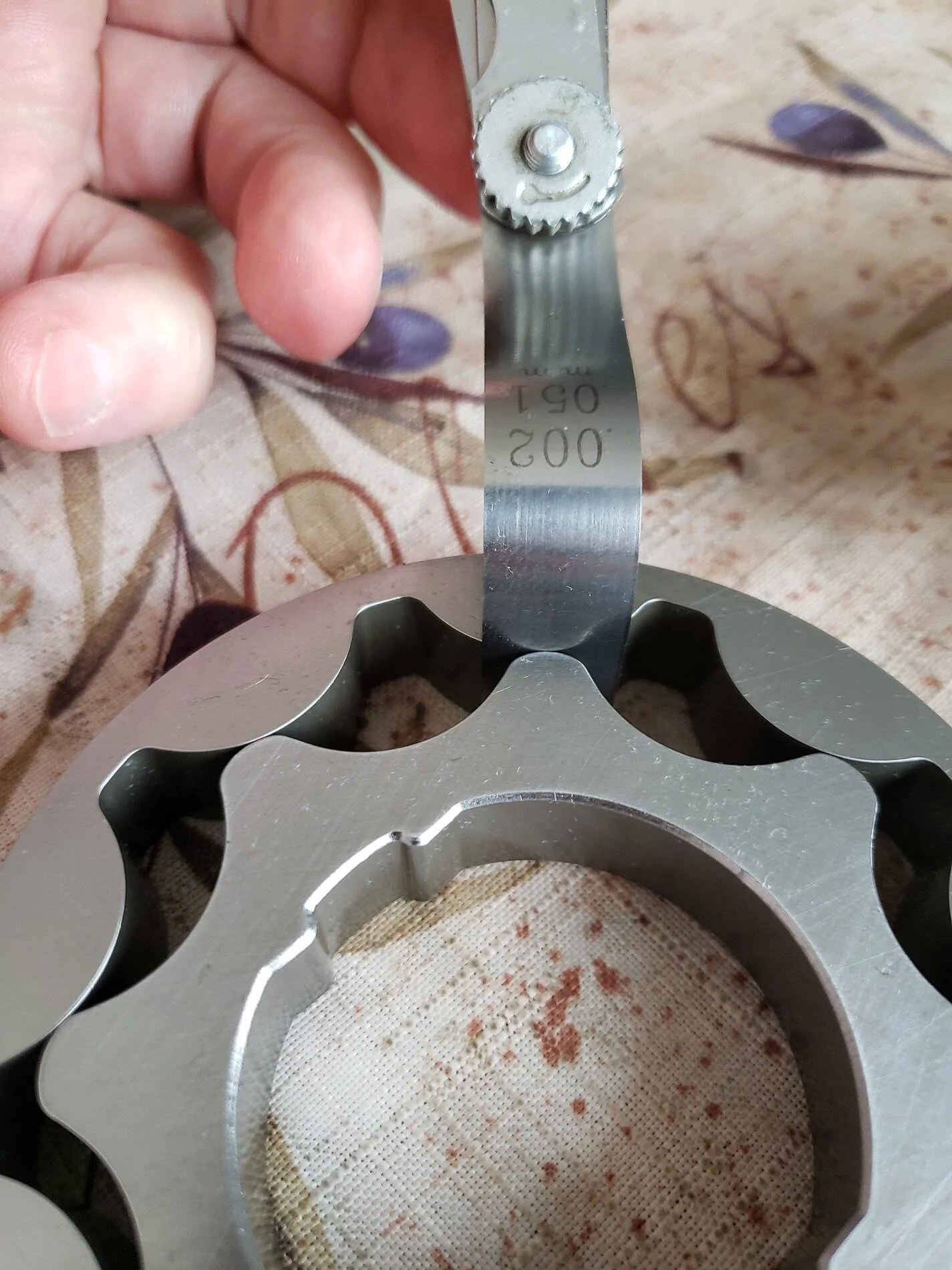

did you watch the video that i shared a link to.? I could be wrong but the outter ring will grow with heat more so than the center gear, pure speculation
BoundaryPump
New Member
Mar 19, 2021
Travis
2016 F150
.001 for width clearance. The distance between the housing top of the pocket and the top of the gear when placed in the pocket. The outer diameter to the housing is usually called the body clearance. We don't make them that tight because people find it hard to make them fit, and I've seen split housings if you get too much crank walk. It basically binds in the housing.
Also tooth to tooth between brands is hard to compare. It depends on the gerotor geometry. The tooth to tooth is a guide but isn't necessarily how tightly the gears mesh and seal. .002 to .0055 is the general range tip to tip should be in. Past that performance really starts to suffer.
socketman
Aug 22, 2018
201
46
Whitehorse Yukon
Richard
2016 Mustang GT / PP
  • Thread starter
  • Thread Starter
  • #120
I just re watched you video and i don't see that any of the clearances are too small or have you changed your criteria.
