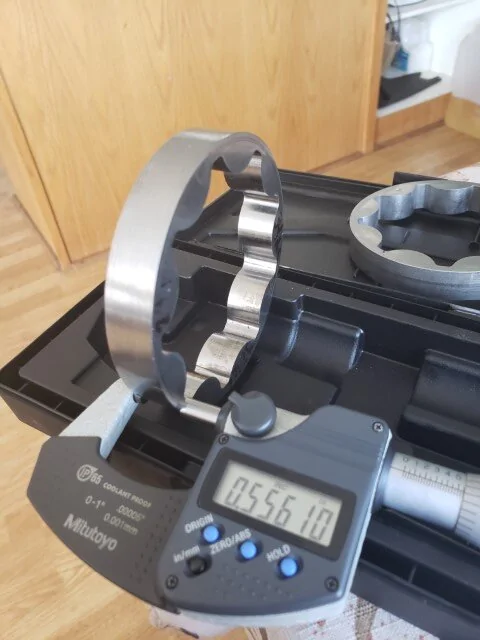

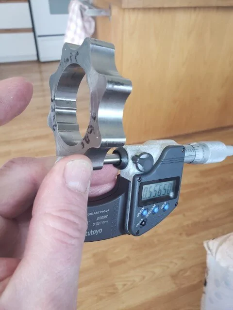

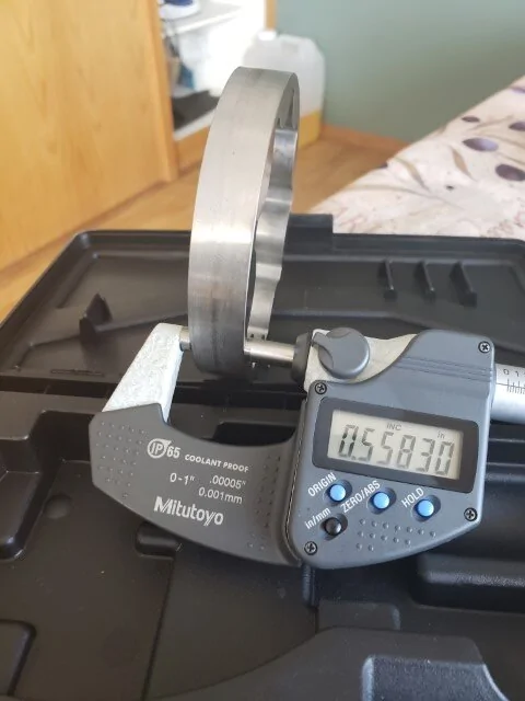

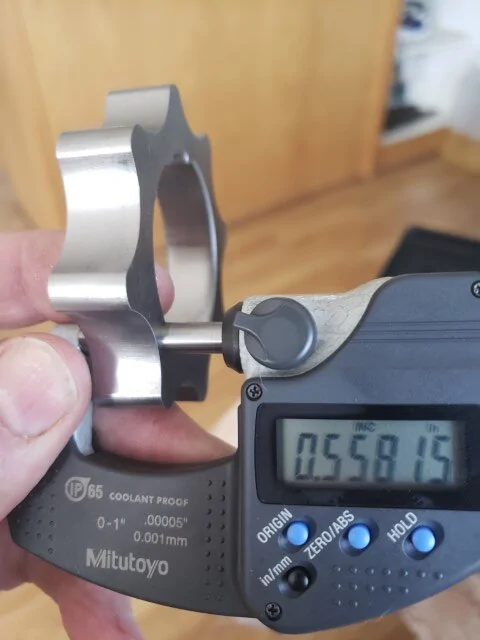

Some more measurements , mitutoyo micrometer brand new.

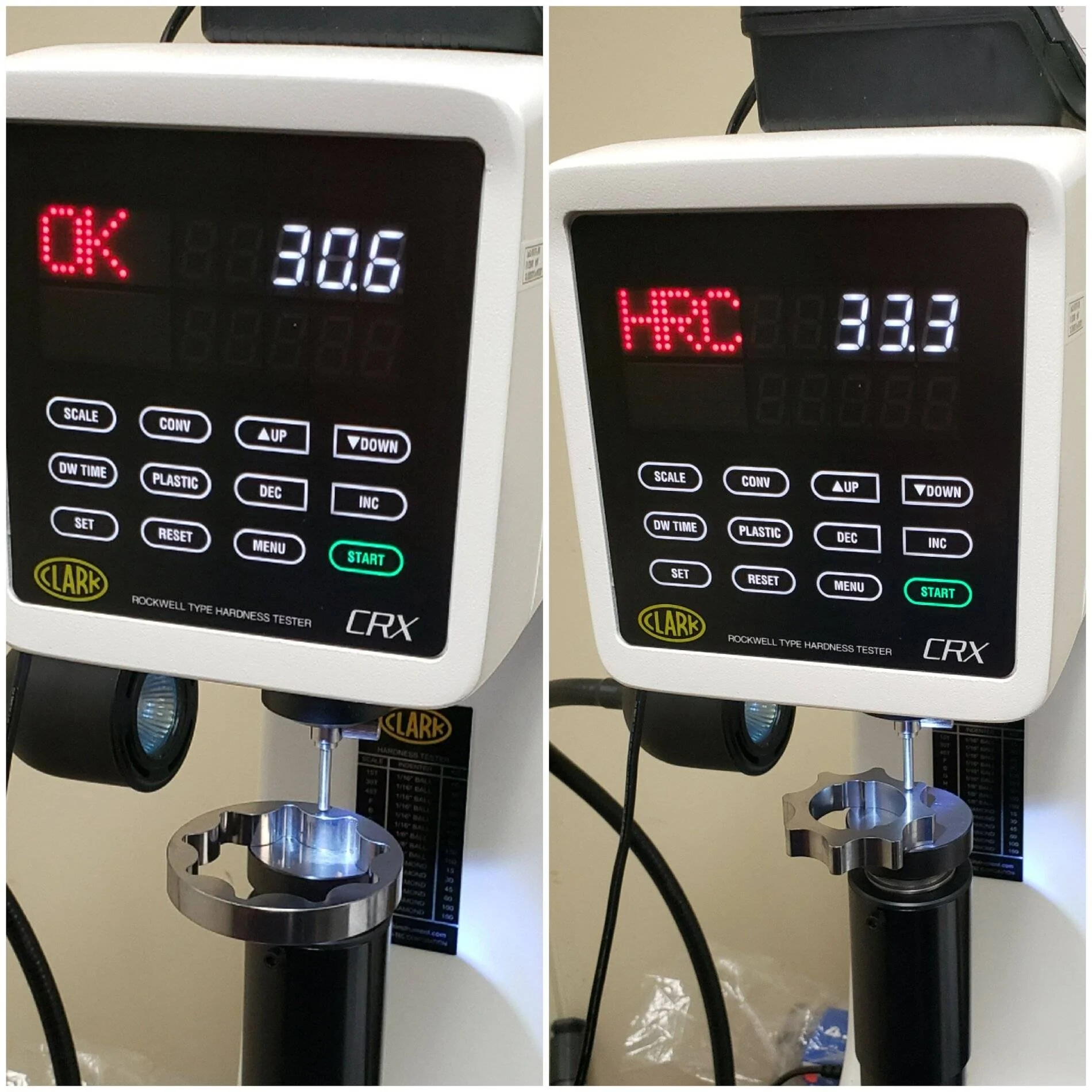

ZPD
Jul 10, 2018
200
89
TX
2017 GT Premium
So I just tested my unused Boundary OPG and below are the results. The tester is within calibration and was verified with a calibration block prior to the tests.
socketman
Aug 22, 2018
204
55
Whitehorse Yukon
Richard
2016 Mustang GT / PP
Thats pretty much in line with what i have been told but maybe a hair low though the Vickers test tells a lot as well. MIne were HRC 26 on the gear in the middle which is the one that was shedding which is way to soft imho.
