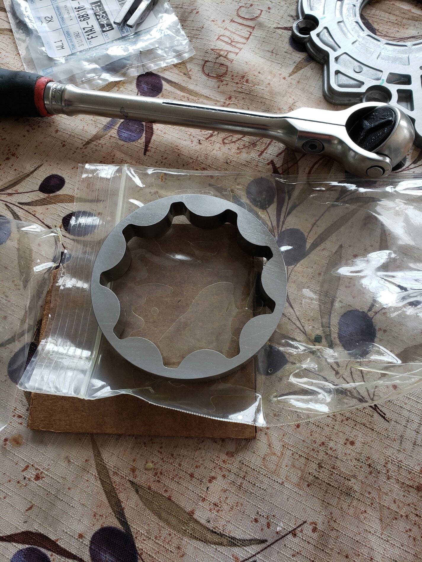

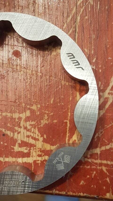

Only waiting for my crank gear from FPP. I am completely satisfied with TSS thus far and the the finish is of good quality compared to what MMR sent me You really have to hold them in your hand to see how much better the TSS gears are. See the image of MMR. I have decided to not hardness test since i dont want anyone blaming that for any kind of failure.

larr12
Jul 9, 2020
1,123
1,723
Alberto
2020 Mustang PP1
Thanks. Really good info.
