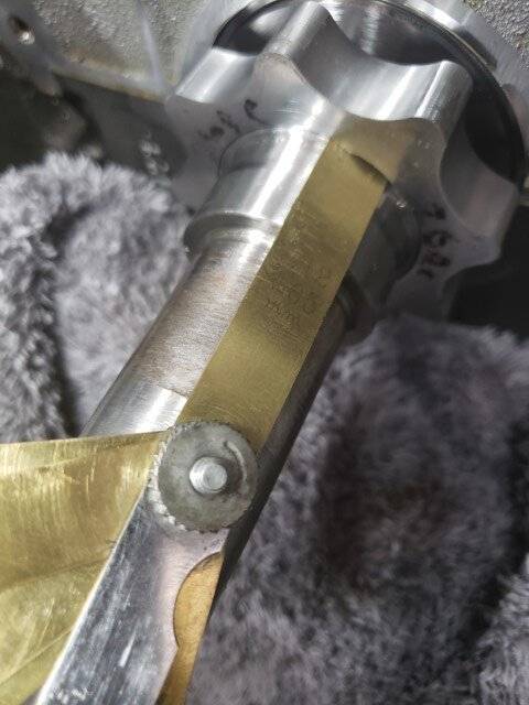

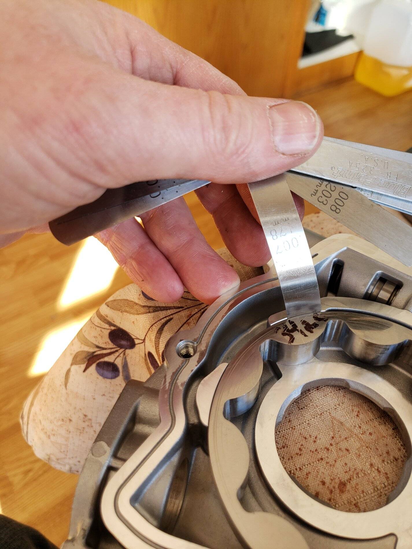

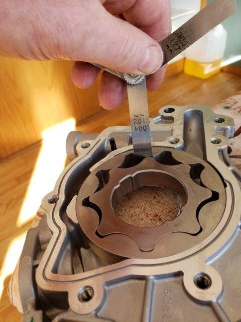

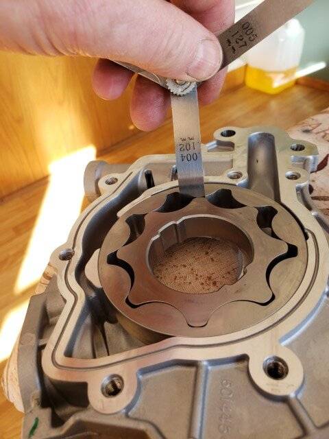

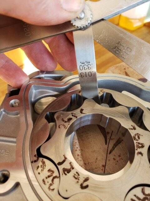

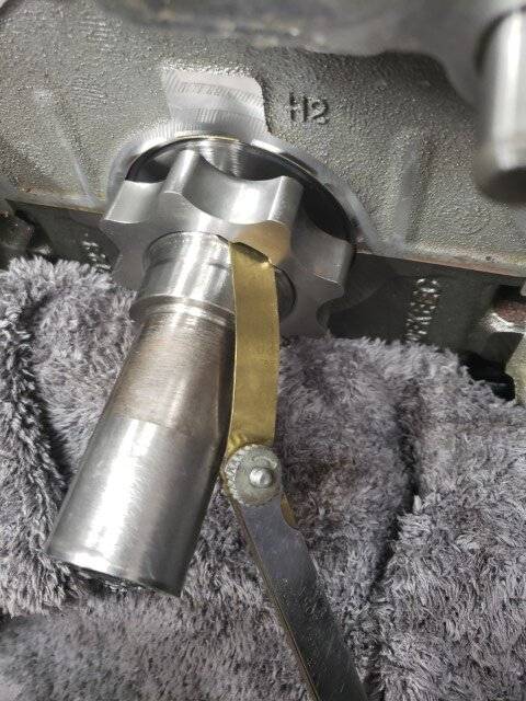

I got my new ford pump and these are the comparisons of the new pump body and gears vs MMR gears in the new pump as well as both crank gears being measured..004 more play on the crank with MMR over the factory set. I will update when i get the tss gears.

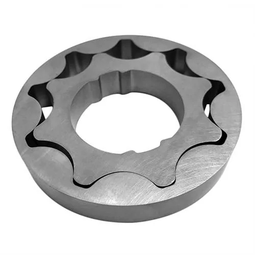

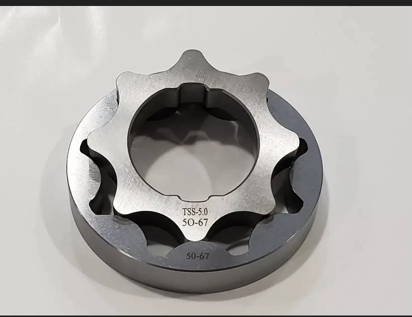

So are there varied versions of the MMR Coyote oil pump gear sets out there? I’m seeing online images where the gear sets look different. Some appear to have etched laser logos (and what appears to be a dull composition) as well other images with stamped logos and a higher quality advertised “billet” surface as the example pics show:
Look at the logos and surface quality when making these pics really large:
Supposed “billet” quality and in these images you can see what appears to be a MMR part or serial #:
I can't make out the markings on the brass shims. What was the factory value? How hard/easy was it to slip the Ford part onto the shaft and the keyway? What is the diameter of the shaft?
MMR gear on crank was .012 and the Ford Gear was .008 .The two gerotor gears are going to touch but i mean its the oil pump shouldnt be any metal to metal with all the oil.
yikes. That's WAY worse than a class 1 fit which is 0.0012-0.0055 and considered damn loose.
I hold better than 0.004" tolerance on my cheap-shit Chinese 9" lathe with manual dials and cheap-ass insert tooling and brazed HSS cutters !! And I'm not a trained machinist nor have commercial experience.
So if gear tip to hump is supposed to be 0.004, all you need for the metal surfaces to crash into each other is the crank gear to move just part of the way in it's slop. No wonder these things get beat up!
A *roughing* pass on an EDM can achieve +/- 0.001” and a clean-up can get to 1/2 that and if you're REALLY precise you can halve that again.
I want to see a quote for making the inner gear bore a class 2 fit. Geezus Ford, who's running your tolerancing standards over there? Are your manufacturing facilities run by high school dropouts who think CNC machining is woodshop? Are monkeys from northern Burma chiseling these gears out of bar stock?
Seriously, WTF?!?!?

I couldnt agree more. i would think .004 minimum. In my minds eye i can picture the center gear moving around and the outter gear moving in its bore and with these tolerances no way they wont crash. My TSS are enroute going to be an intolerable wait lol

Ford says .004" +/- .0005" for the 5.0l & 5.2l. Remember, 5w20-5w30 (gen1/2/3), & 5w50 (boss/voodoo) has to slide through there.
