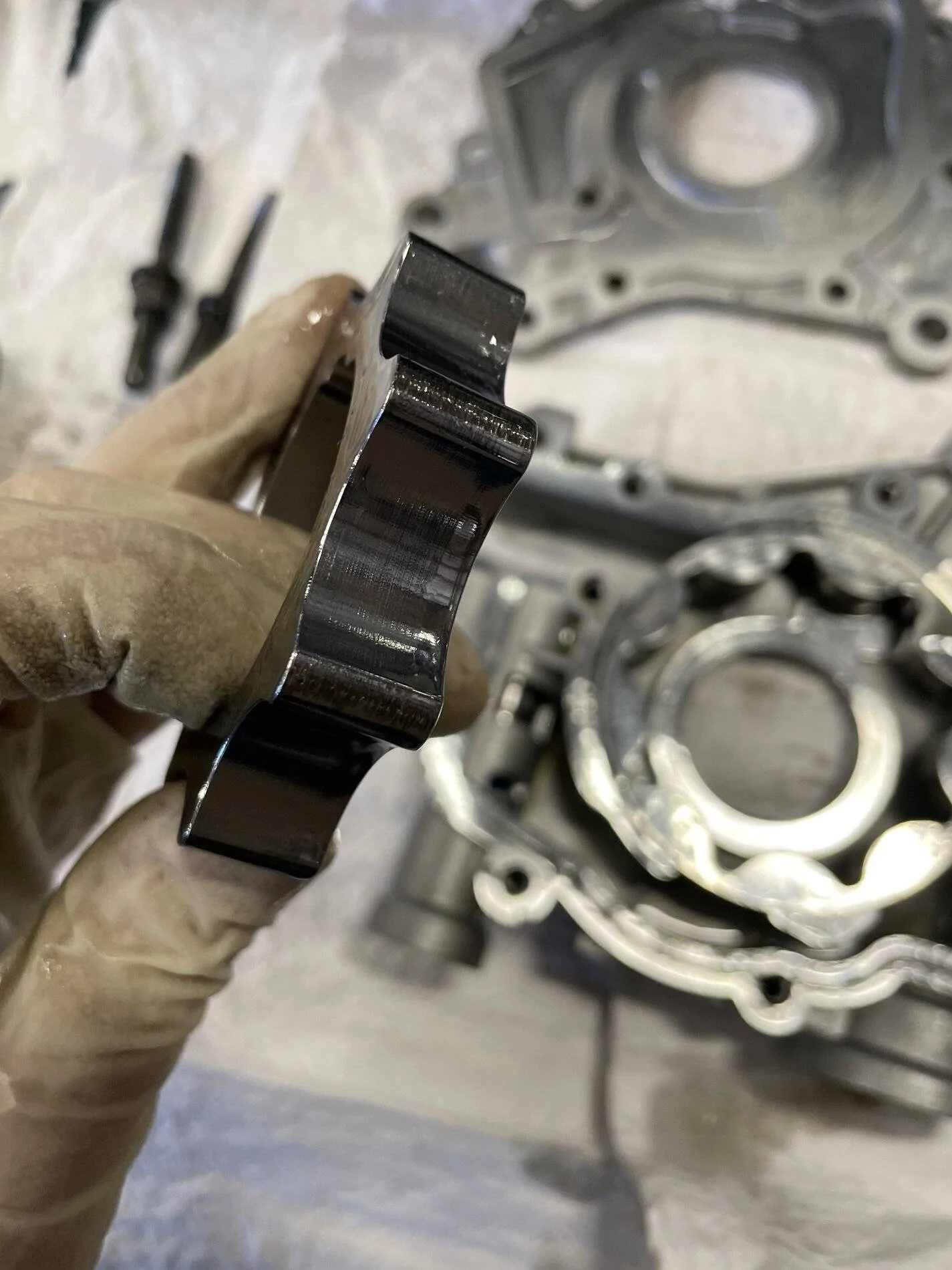

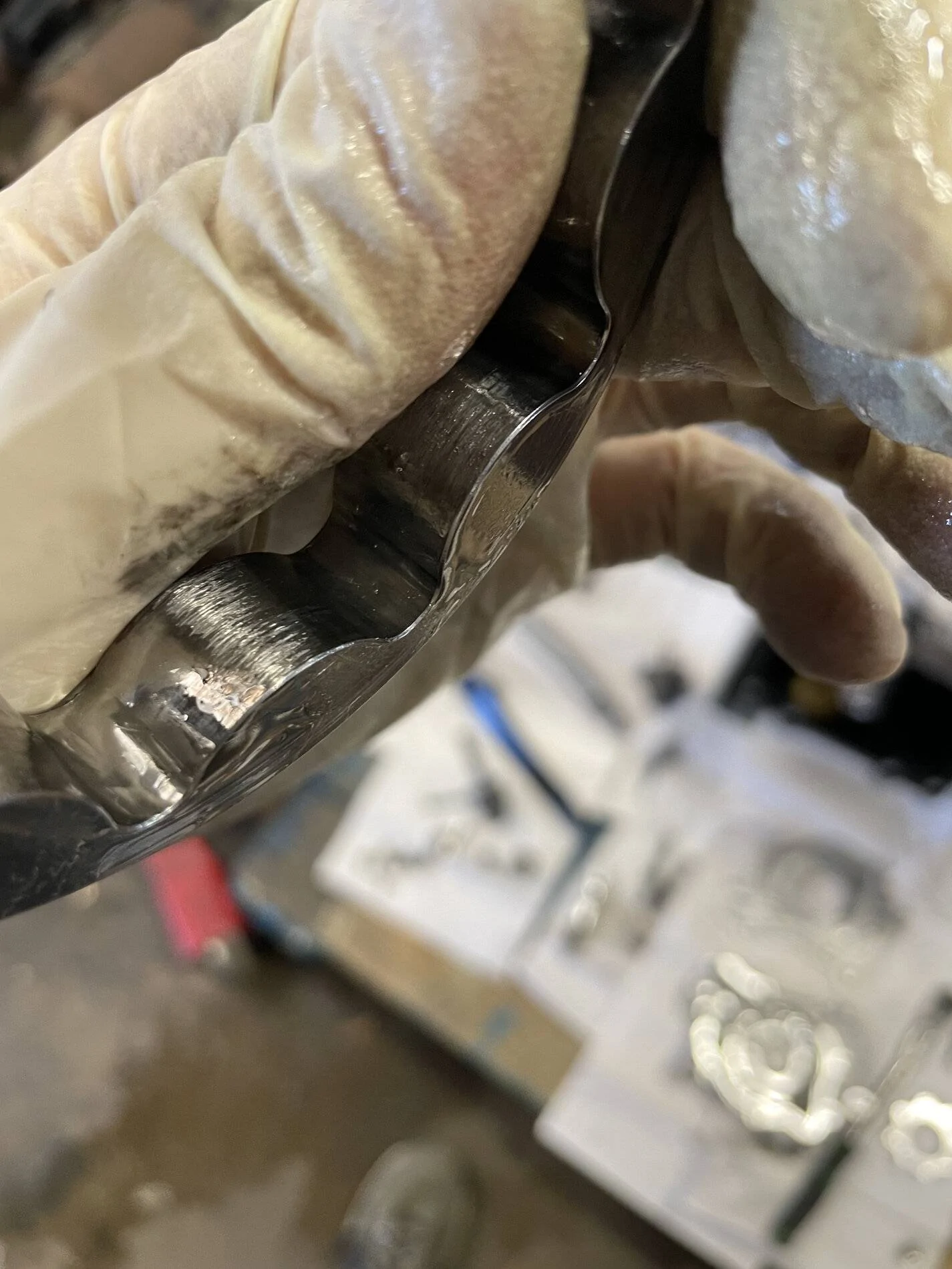

Brand new built engine, new OPG and new pump only rotated by hand a few times. Pulled it apart at request and found this…
Cobra Jet
Feb 12, 2015
771
17,598
20,043
Any identifying marks on the faces of what you pulled out?

Wow that sucks! I have an OPG set that I am going to install. Guess I’ll have to spec mine. But...that steel is way too soft to score like that from hand cranking.
