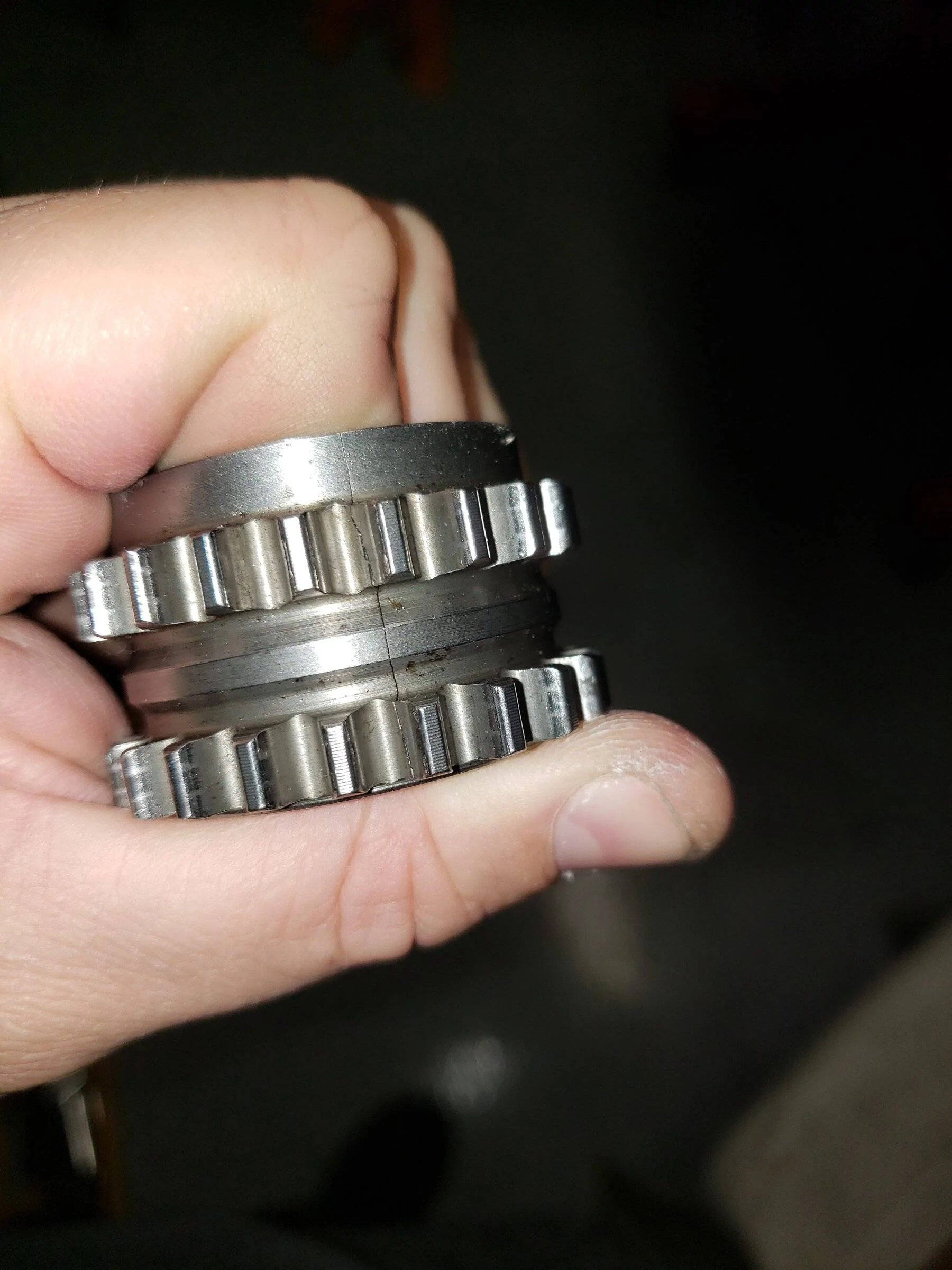

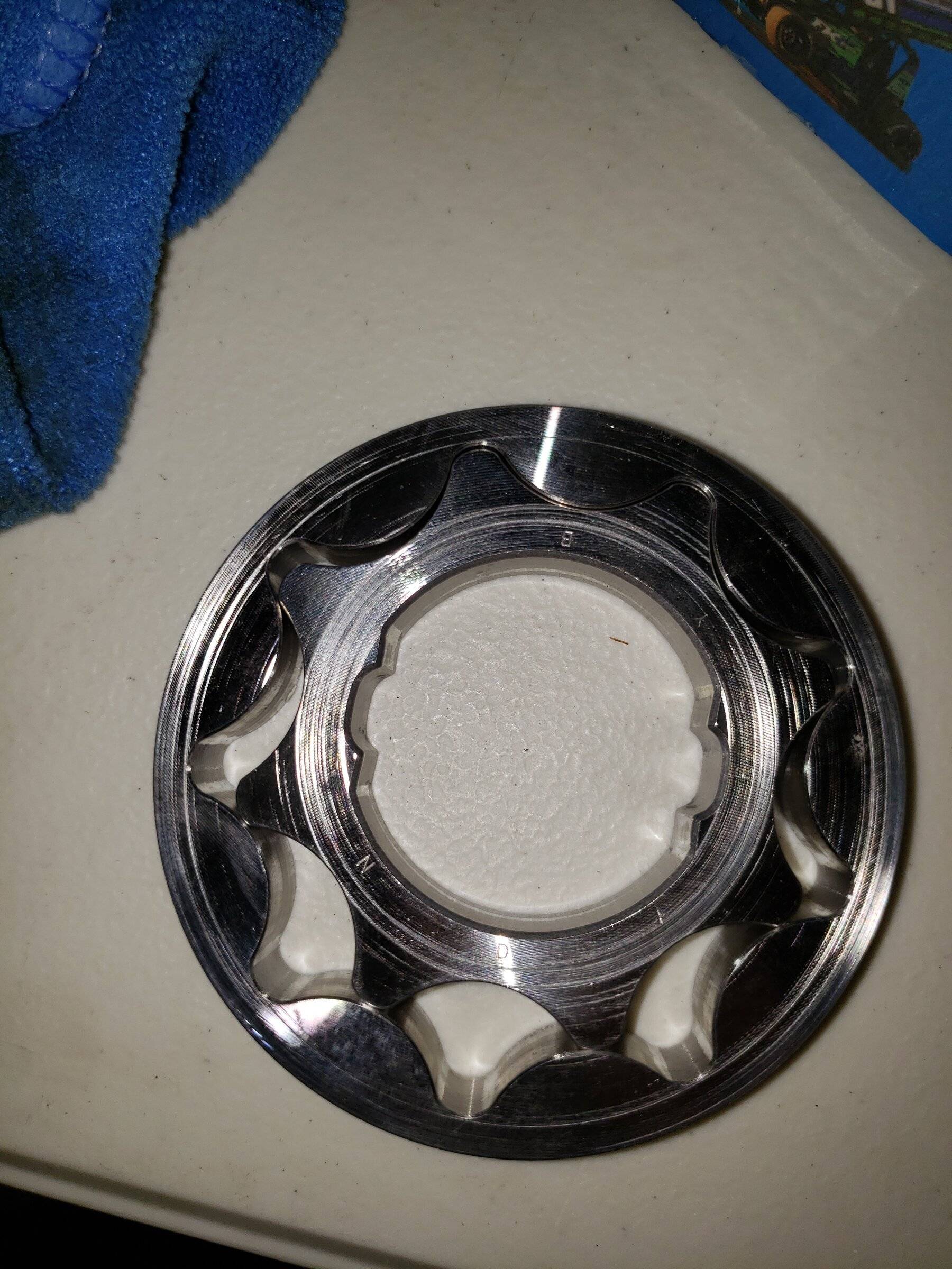

Agree. Still, the gears are certainly tore up quite a bit. I wouldn't think they would get so trashed just hand cranking. That isn't hardened steel.I wonder what the runout is on the crank snout.
I know when I was building HD twin cam engines if the crank runout was over about .007 the oil pump gears would score.
Hmmm, that makes sense too....I wonder what the runout is on the crank snout.
I wont categorically say they told him to but he did maybe on his ownWhy did they ask him to take the video down? Are they threatening suit or something? I mean if there's an issue with any product, the consumer has every right to relay their concerns to others, no?
Agree with that ^^^^ 10000%…. There’s no way in hell “hardened steel” would get damaged from a manual human hand cranking…. Something is really amiss….Agree. Still, the gears are certainly tore up quite a bit. I wouldn't think they would get so trashed just hand cranking. That isn't hardened steel.
