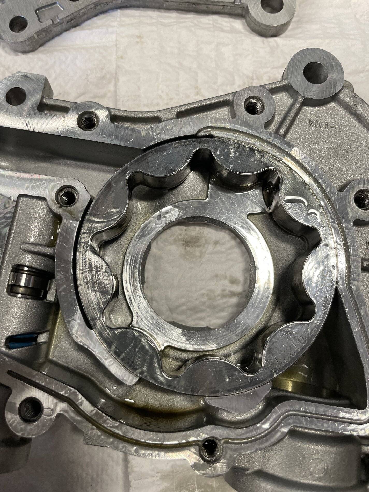

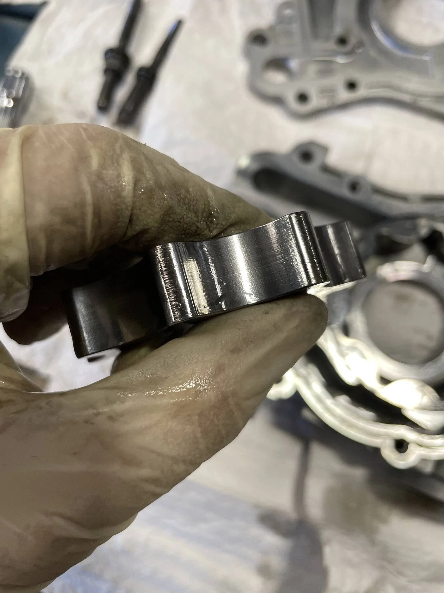

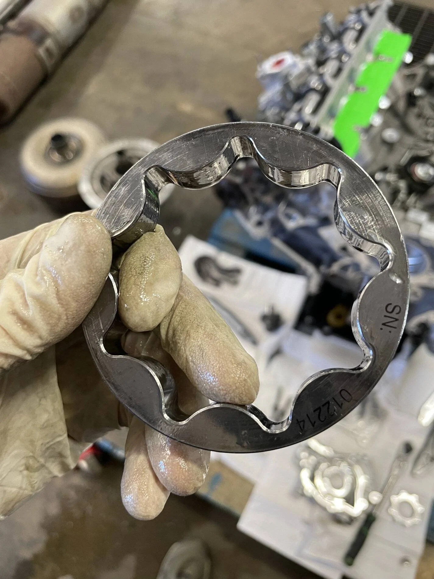

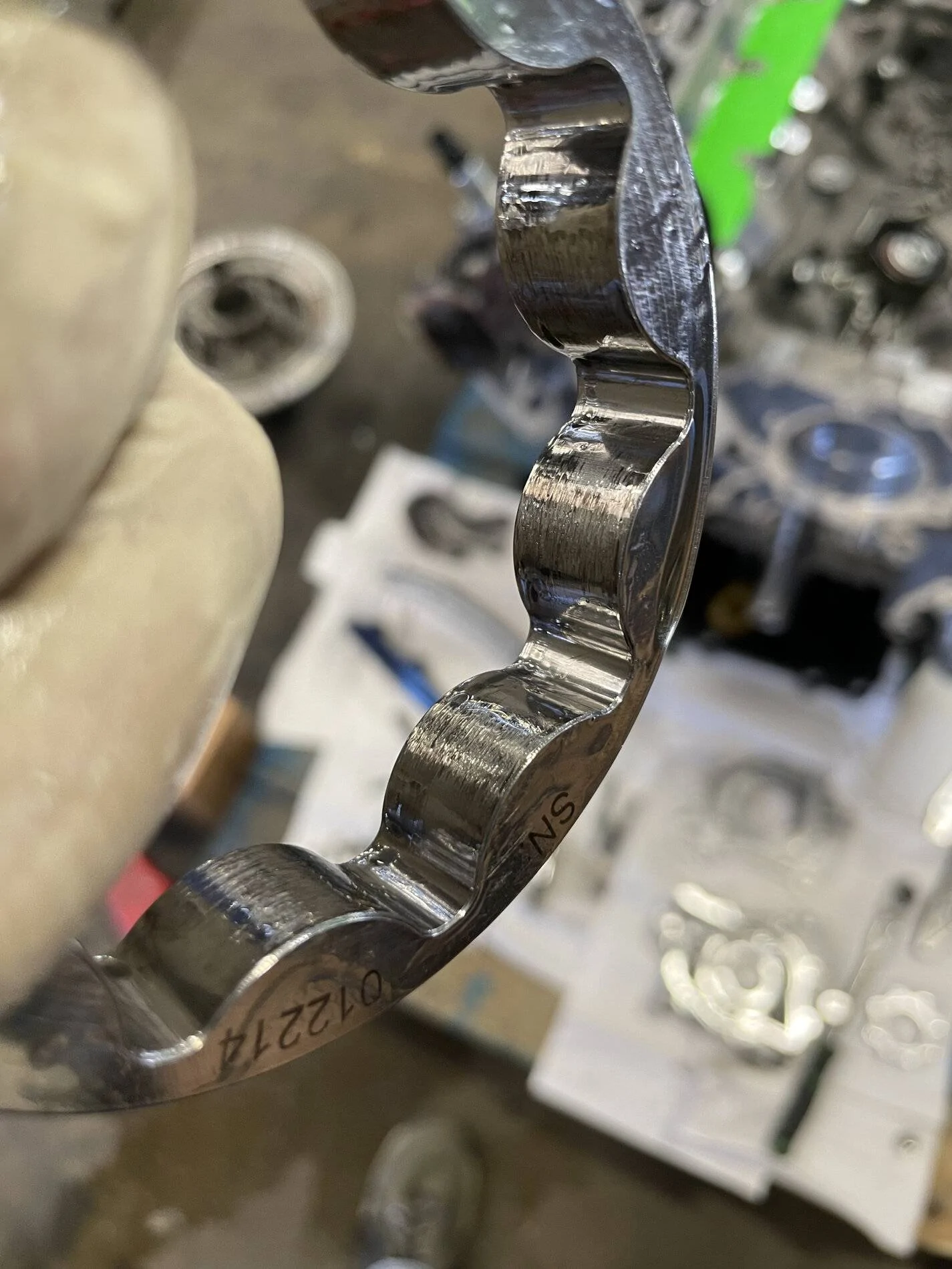

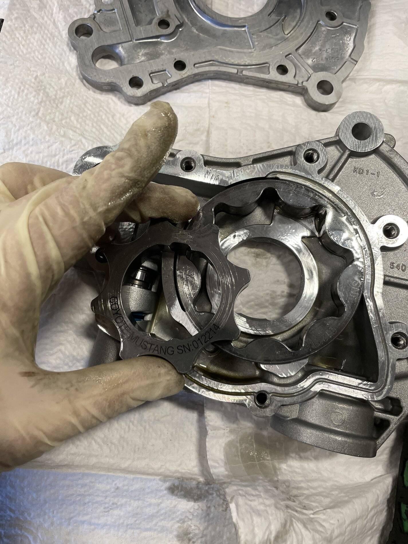

Again this was a sealed engine all brand new only turned over by hand with NO spark plugs with no compression. Please check your gears. Only posting to help others.

You said pulled it apart at request. What were the warning signs?

Warning signs were I know 2 others personally that had that had failure and my engine builder asked me to

Who was the engine builder? What are the brand of gears? Is this a Ford built engine?

So...how could there be damage like that? If you spec them on a bench and turn them in the housing before install they seem to not bind. How then do they get so scored when installed? Maybe they are not concentric?
I don't get it.
