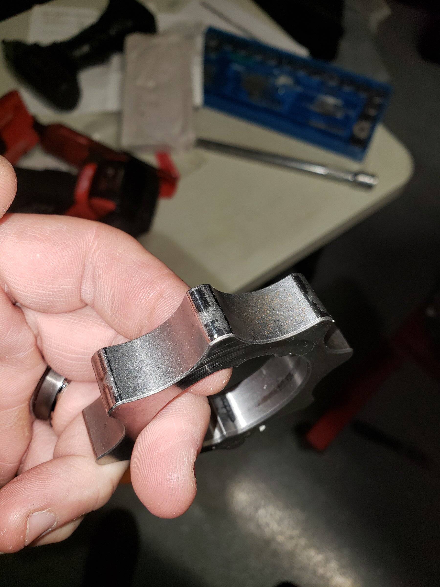

Failed boundary crank sprocket
Do you have a pic from the side? Curios if it broke in the same place that the stock sprockets are breaking. Could anything else have lead to this failure? Having held the stock and boundary in my hands, I don't see how it couldn't be stronger than stock
So you can hold two crank sprockets in your hand and make that determination? Nice.
How did I know that that was coming... I'm certainly no metallurgist and have no way to determine the composition of either, but the stock is extremely thin in the area of the keyway and boundary has done a good job of addressing that.

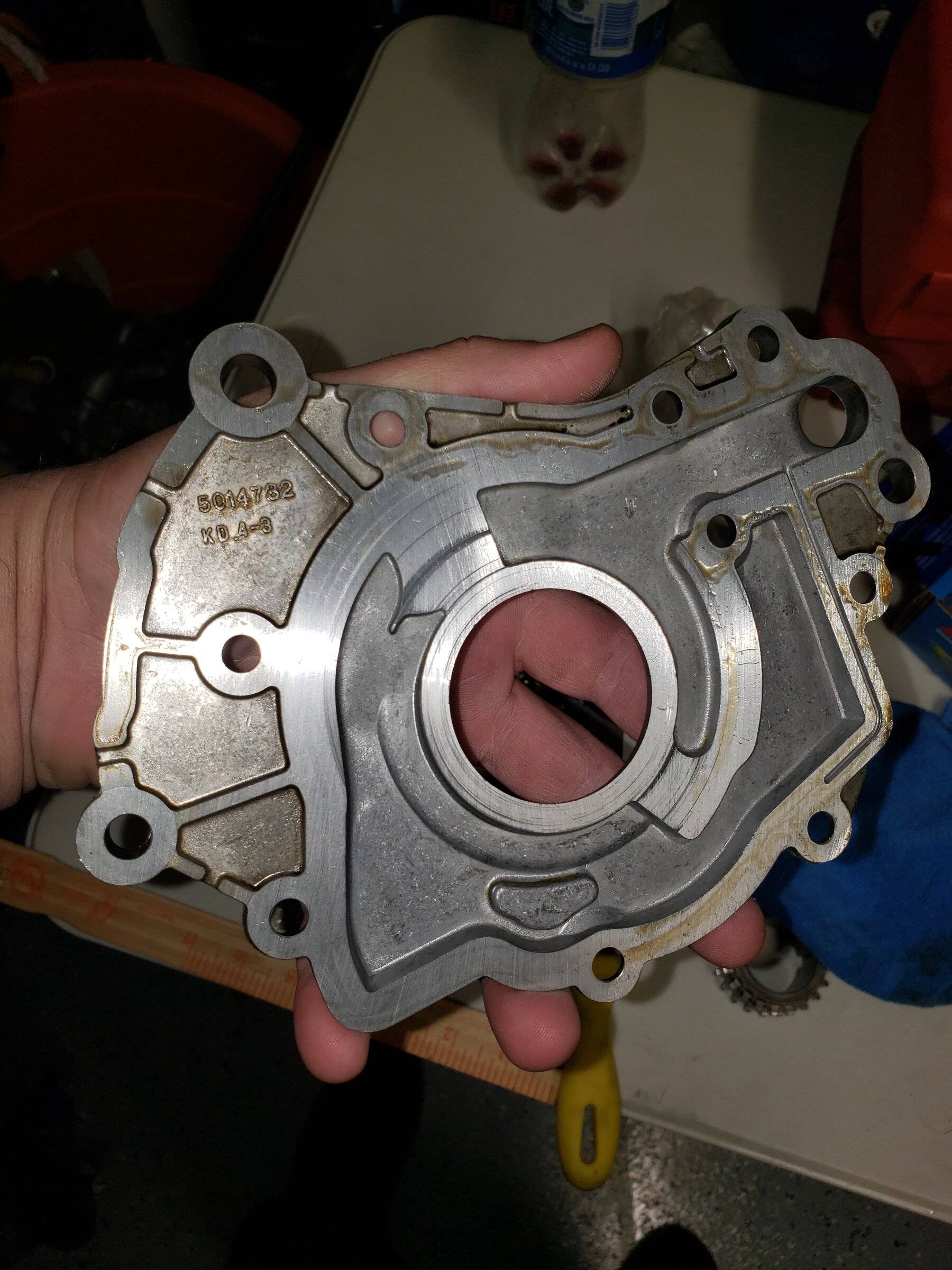

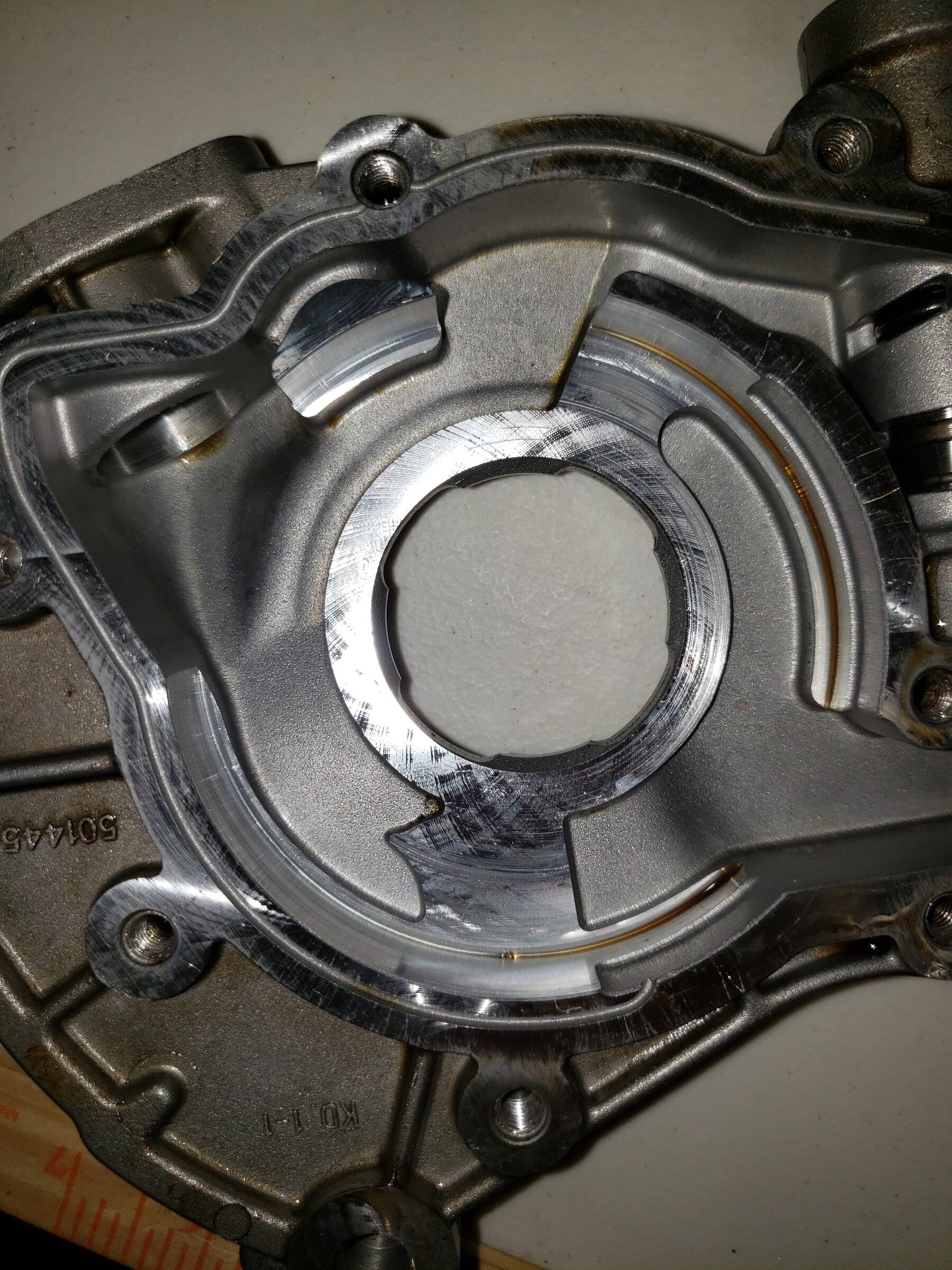

When the crank timing gear was on the end of the crank the crack was open quite a bit. It was a very snug fit when they went on. If I had to guess they are cracking due to it being too tight and when the metal expands from heat and it's running at a high rpm they crack. They do look beefier then stock but don't seem to hold up any better. As far as the Oil pump gears they make it did turn fine when it was installed and was greased and oiled before being run but it did rub the oil pump housing pretty bad. Bad enough that I had to replace the oil pump housing. Not trying to brand bash just letting people know my experience.
