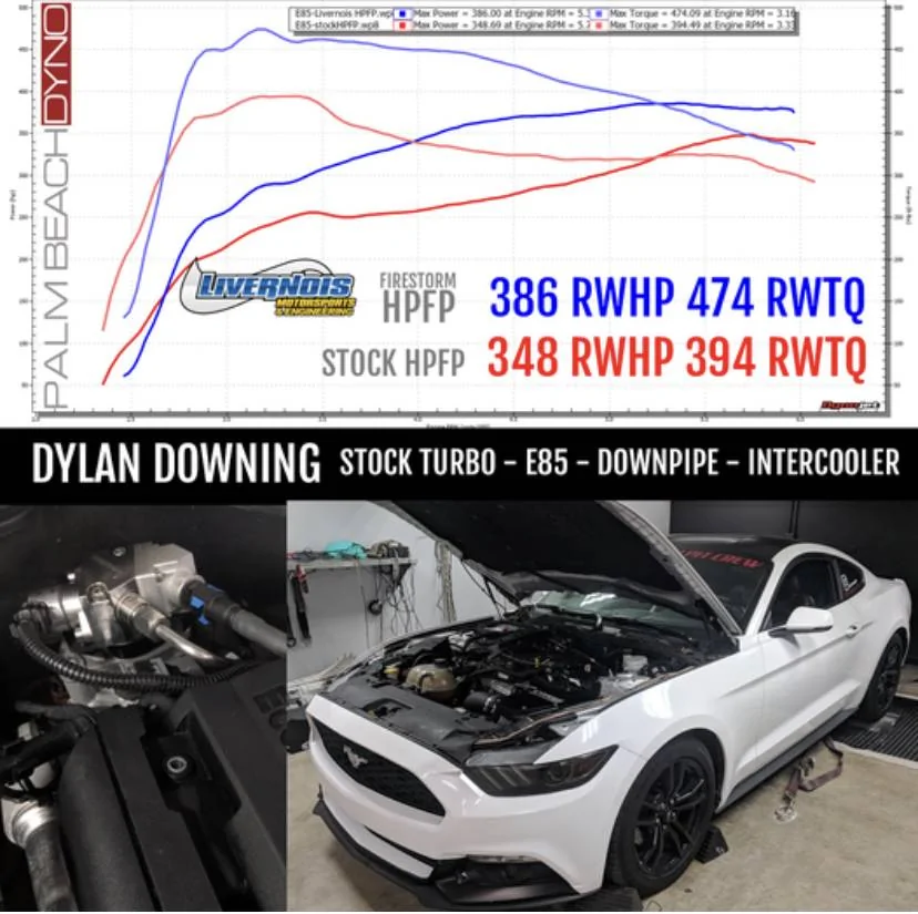

This is my goal if I keep the car instead of a new GT. E85 has insane gains throughout the curve. It sucks that it costs $2k just for the fuel parts to run e85.

Im not gonna lie, either their dyno reads dirt nasty low, or their tune is crap
380 whp and 474 wh torque is extremely low for stock turbo and bolts ons, unless they capped it for engine safety
im telling you guys, the big name tuners like lund, palm beach, etc dont tune these cars enough and dont do more than add some boost and timing to a point they think is safe. Smaller tuners who specialize in ecoboosts can get you to the 370-390whp and 450-480wh torque area with stock fuel system pump gas 93

I’m ok with a safer tune. It would suck to spend $5k on a shortblock instead of upgrading to a Coyote.

Thats totally fine, but having more hp doesnt always correlate to a safer tune
A safer tune can have more power if its tuned better and with a better approach than a lower tune
unfortunately its very hard to get a great tuner for the high hp on this platform
but still, full boltons would be a great solution to crank out some better times for you!
