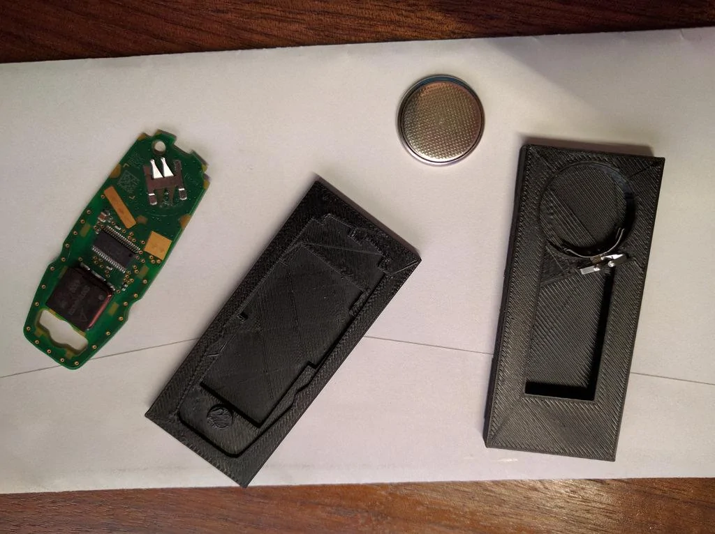

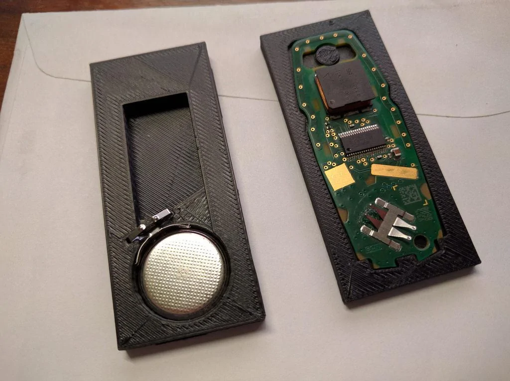

After some discussion at work, I don't think we can reduce the size of the PCB without designing a new one. The only possibility I see is chopping off the end of the board with the battery and relocating the battery to be above the remainder of the board and connecting it with wires, but that doesn't buy us much and won't really reduce the thickness. If it wasn't for the antenna, we could cut out quite a bit.
