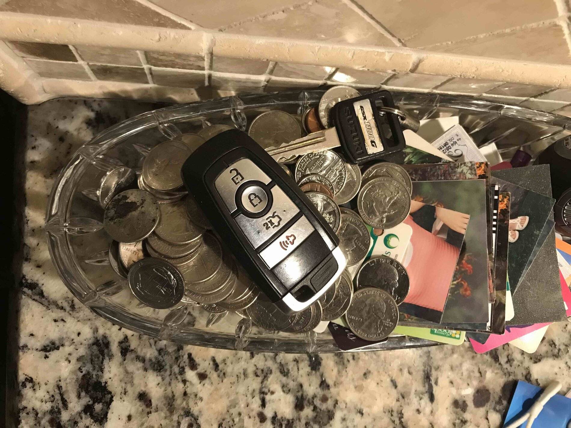

I looked into local locksmith programming coupled with ebay purchase, and decided it wasn't worth it - I eventually went to a local dealership and plonked down my $200 for a fob that now sits in my change dish just in case.

I bought my car from an out-of-town dealer with one fob (lesson learned! *smack* I coulda had a V8!) and had been scraping by with the FordPass app that can open my doors if I really needed it. But then, the car is pretty smart about not letting you lock the keys inside as long as neither the car's nor the fob's battery is dead.

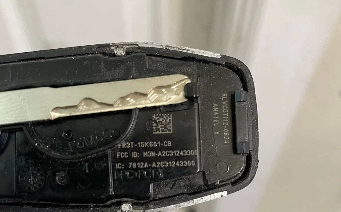

first. these numbers on the inside determine if it will work or not. Doesn’t matter what Ford it came from.
second. I purchased mustang 2015 with one key. Purchased a spare on eBay with matching numbers then programs it my self even though I only had one working fob. You just have to know what you are doing and have forscan. Now cutting the key you are on your own. Also any locksmith worth his salt can program afob in 10-20 minutes
