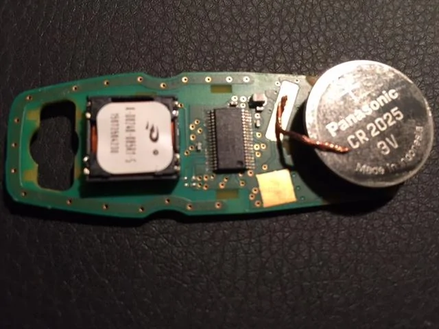

Just for other people's benefit, the pliers pull off method is not recommended. You pulled the metal pads off the board so there is no going back, and it is possible that you could short them doing this (pull up the metal trace attached to the pad and it touches the neighboring pad). But glad it worked for you!FINISHED! SUCCESS!!!
Forget about soldering. Forget about nylon washers. I just went for it with a pair of needle nose pliers. Gripped the whole button assembly square head on and gave the smallest of pulls. Came right off the board. Could not have been easier. They are barely stuck on at all. Used the needle nose pliers to just knock down any remaining pointy stuff (there wasn't much). Reassembled the battery, etc as before, and . . .
Ta-Da!
It worked perfectly. No buttons. Just a passive key fob that fits in my wallet. As long as I have my wallet on me (and I always have my wallet on me) I can use my car.
Done. End of story. It's a really simple $50 mod.
EDIT: Here is a better photo of how the battery is hooked up (before I applied the tape)
