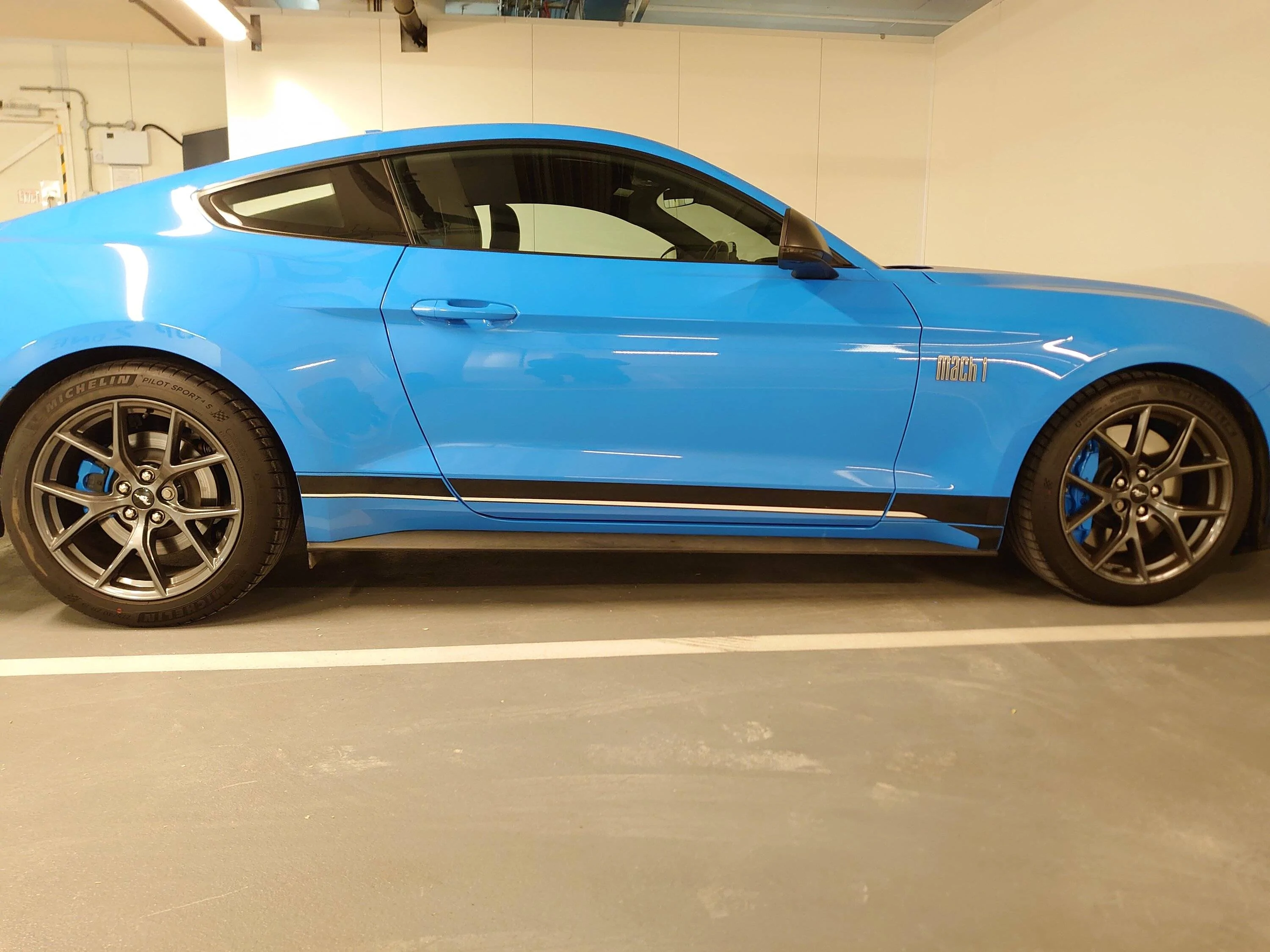

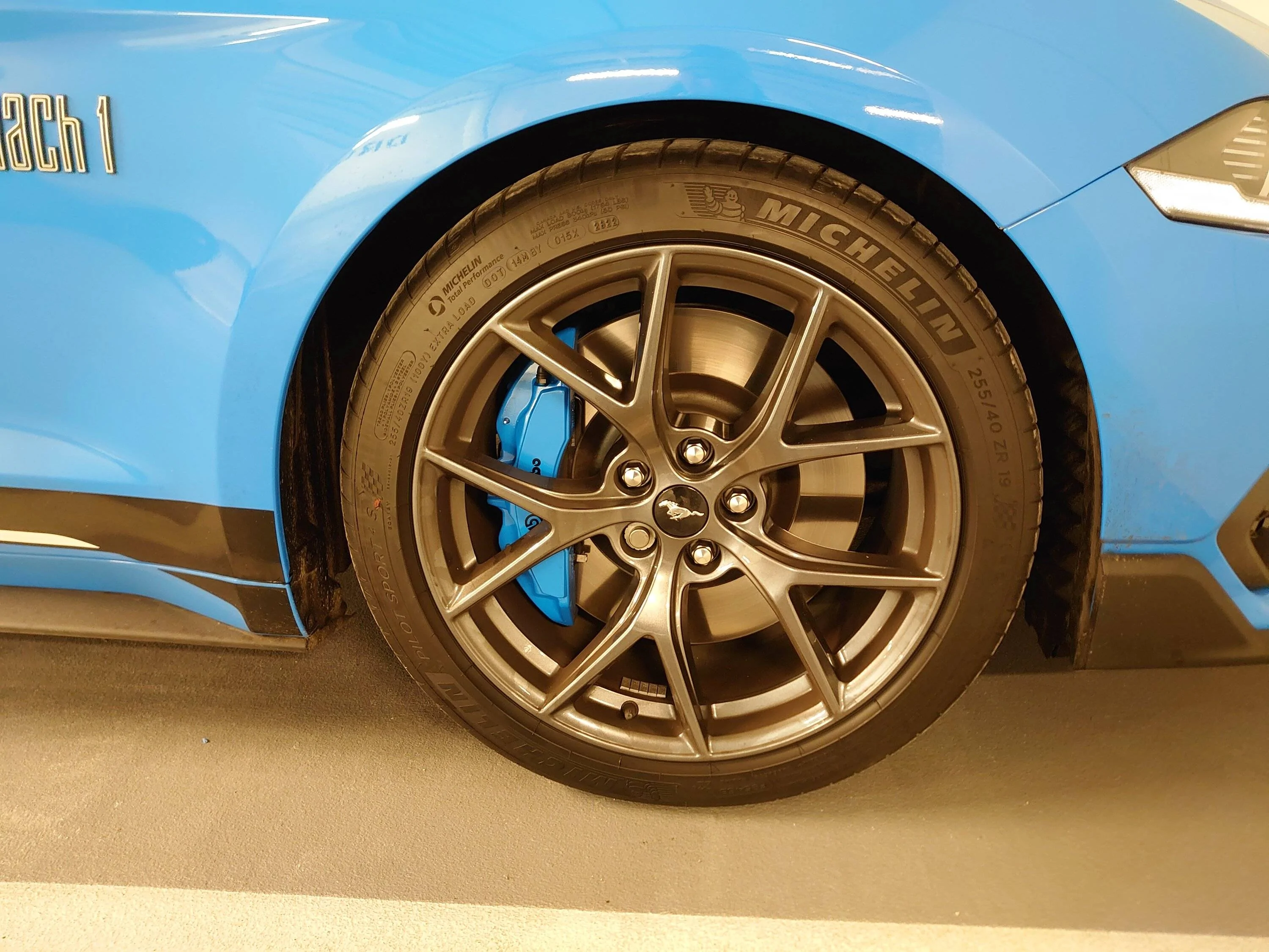

Its a looks thing more than performance. Thank you for responding
I felt similar regarding looks. I had all 4 of my brakes removed and painted Grabber Blue.

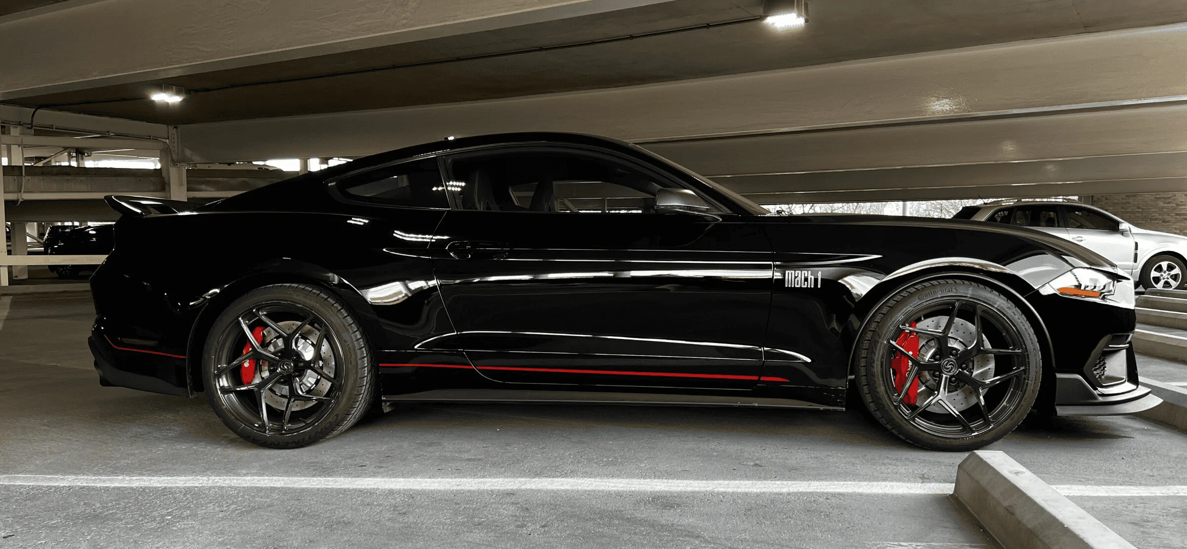

If you really want a brake upgrade this is @PBM457 beautiful Mach. This car has the M-2300-Y set up from Ford Performance.
The only thing is you cannot use the factory Mach 1 wheels, as they will not clear the front rotors. If you are daily driving, this is an expensive upgrade.
By far the best looking brake/wheel combo IMO
Looks great! I almost... was going to do the Whipple in yellow then the brakes to match. So so glad I didnt (due to the problems I had with the Whipple unit)
