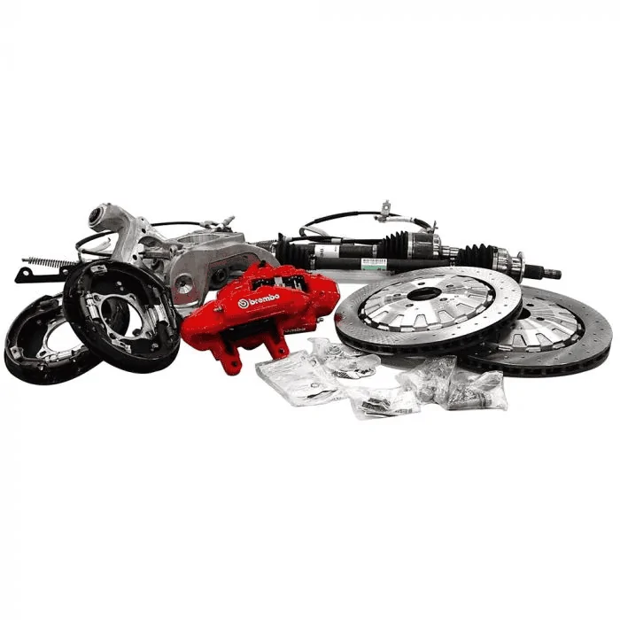

If you really want a brake upgrade this is @PBM457 beautiful Mach. This car has the M-2300-Y set up from Ford Performance.
The only thing is you cannot use the factory Mach 1 wheels, as they will not clear the front rotors. If you are daily driving, this is an expensive upgrade.
Down side/Up side is you have to run 20 inch wheels. If you are daily driving, this is an expensive upgrade.
They're GT350 brakes, most definitely do not need 20" wheels.
According to the guy who installed them, the front brakes in that package will not clear the factory HP wheels.

The kit has rotors and calipers from the GT350, which increases the rotor size in the front from the stock Mach 1 , 15 to 15.5 and the rears from 13 to 15 inches. You probably could use a 19 inch with a different offset, but factory wheels are a no go with this kit.
That's great, but before making those claims, someone should have checked what diameter wheels GT350s come with....
I really wasn't making claims, only trying to share an upgrade from one of the members. I edited my original post as to not send false information.
I know it probably was whoever you quoted. Anyway, 19" fit over those, just not all of them.
