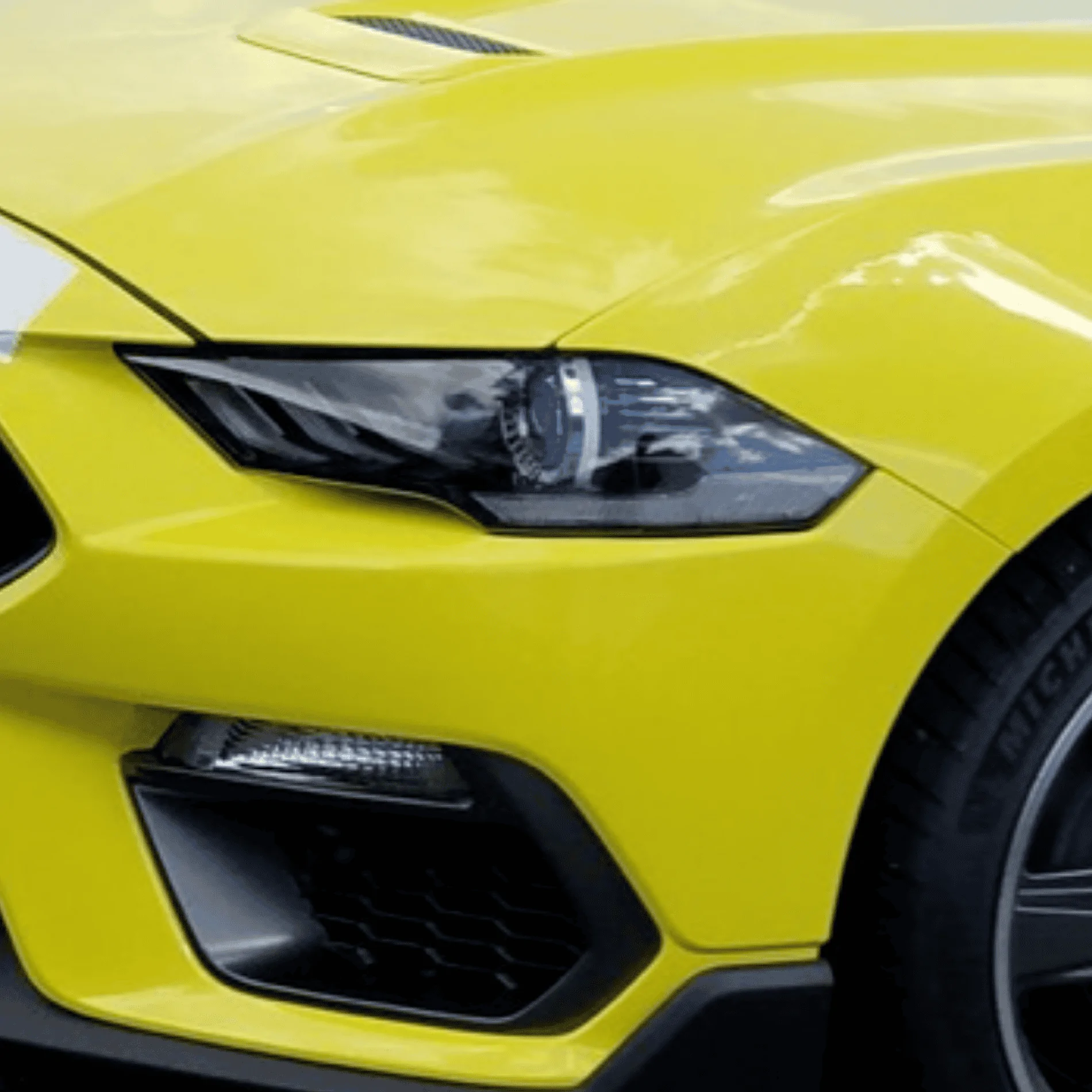

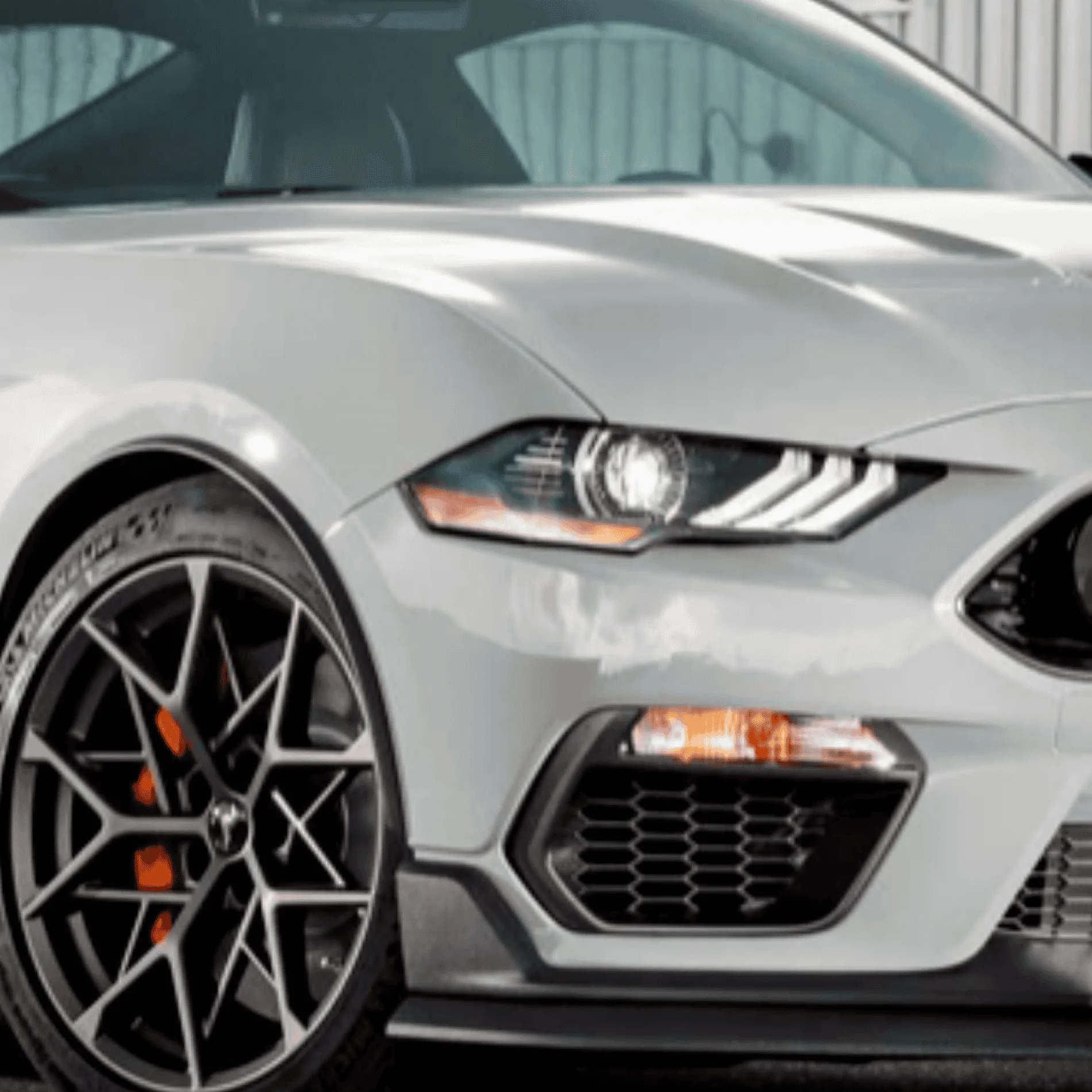

What's up with these headlights? 🤔
Don’t have the orange reflectors!!
not officially legal in the states but I’m somewhat of a rebel:cwl:
*EDIT* you guys get the better looking headlights and don’t have the orange turn signal below it either

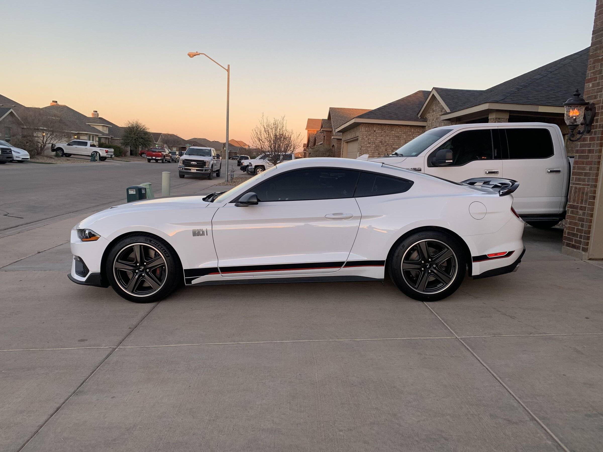

Thank you. Wheels are actually from the US. Prefer all original. To tell you the truth, the ones offered here in AUS although come close, are different. The edges of the spokes have a sharper contour/profile and the colour is not quite the same, also some other small differences. Also they are 20”, not 19” like the HP’s. Not to say that there’s anything wrong with the ones offered here, but I simply prefer what is meant to come with the Mach 1, the Original US HP wheels. And at US $1000 for the set of 4, + US $800 FedEx delivered to my door in 10 days,…you can’t go wrong. The only mistake I made was that I should have gone 295 front and 305 rear. I went 275 front and 295 rear. The rears are a little stretched.
As for the rear splash guards, have got them on also. All original from the US.

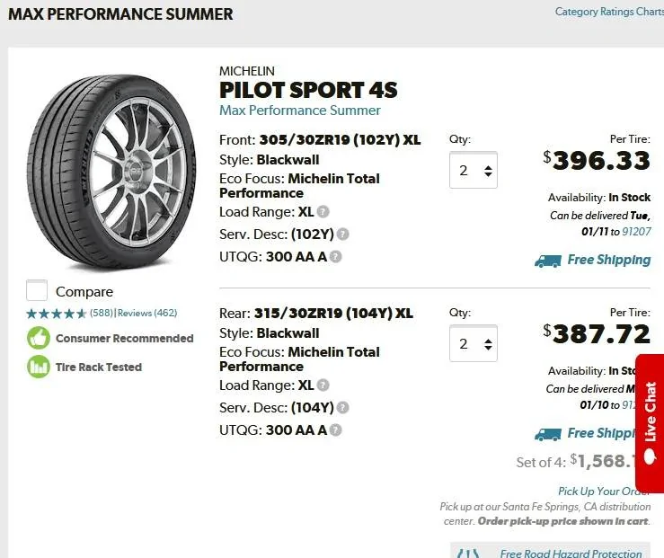

Surprised those 275s look as good, stretch wise as they do. Looks good.
Great photos @OZMACH Looking forward to my wheels for summer already. I too wish PS4S were available in 305/35 R19, but alas, won't go with the older Pilot Super Sport so will stick with 295/35 R19 for the rear too. The slight stretch looks pretty much the same as with 275/40 on standard 10.5".
What's wrong with the 305/30/19 that fit the HP?
30 series tires throw the speedo out, the standard non HP 40 series 275 rear tires are closely matched (in rolling diameter) with a 305/35 or a 295/35.

Even if the diameter didn't have too high -5.4% difference, I wouldn't really like such skinny tyres for our roads. Hopefully Michelin will finally replace Pilot Super Sport 305/35 with PS4S in the future.
The tread on those looks like the BFG All Terrains on my F1. 🤠
