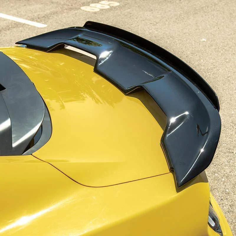

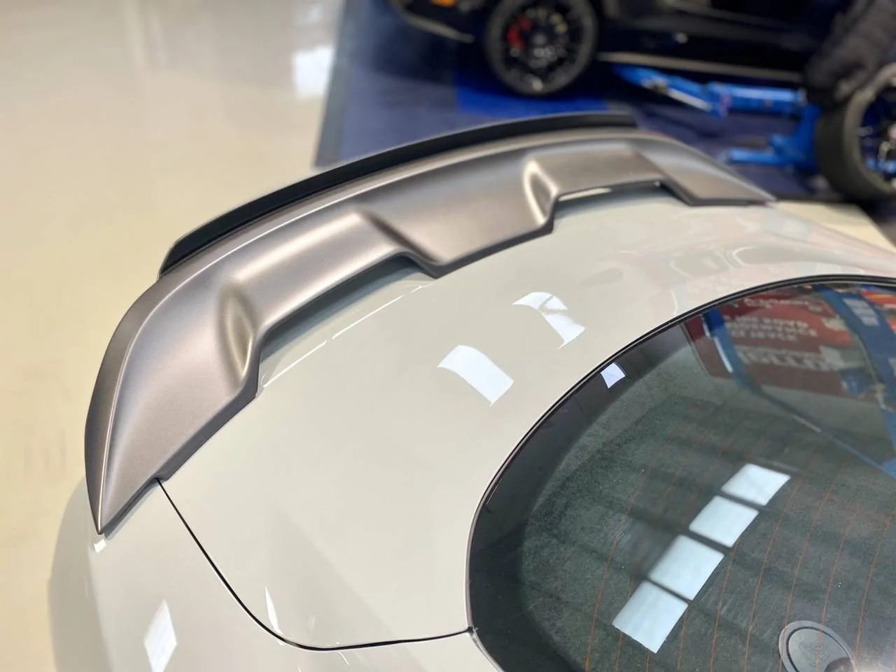

It has been almost TWO YEARS, and nobody seems to be providing the Mach 1 spoiler. I don't mean the GT350/GT500 gloss spoiler. The Mach 1 HP has a Mach 1 specific finish on the spoiler directly from factory. To my best knowledge there is only one supplier in Australia who claims they get it directly from ford like that. It is over $2000 when shipped to the USA and they refuse to supply me the part code or how to get it from ford. I sent out a few requests to old dealership sales people I know and none responded.
GT350 / GT500 Gloss Spoiler
Mach 1 Metallic Satin

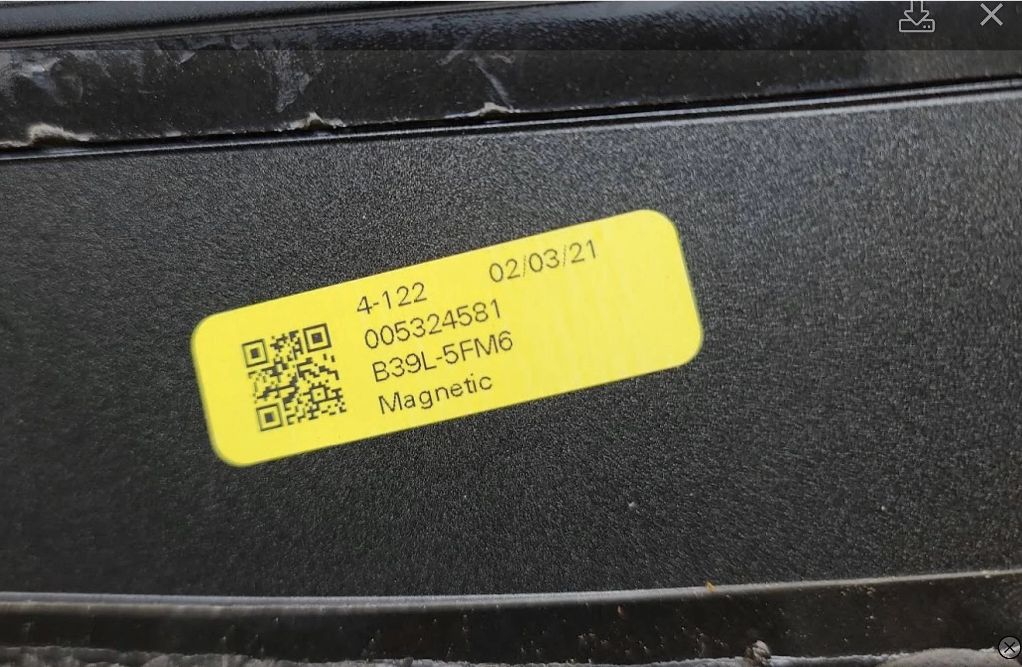

There are several now dead links regarding this issue but I believe it is the equivalent of a GT350/GT500 Primed spoiler + Dark gray base + Ford Magnetic Metallic paint 5FM6 + satin clear coat.

It’s just J7 Matte. Ford’s famous (and good looking I might add) Magnetic Metallic from 2015-2018.

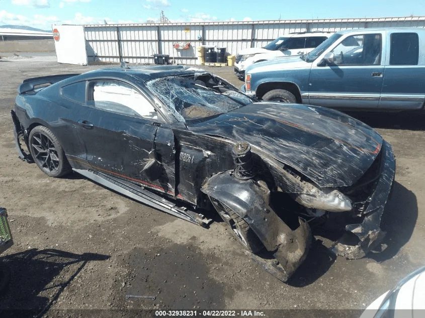

Ehh its not "just anything" if you cant buy it. @Obsidian your best bet is really just getting it off a wreck or buying it black and getting it painted this is probably how Ford is making them. If that's the code, a good body shop will have software that gives them the exact OEM mix.

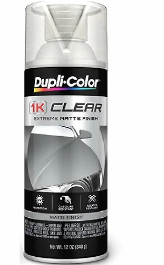

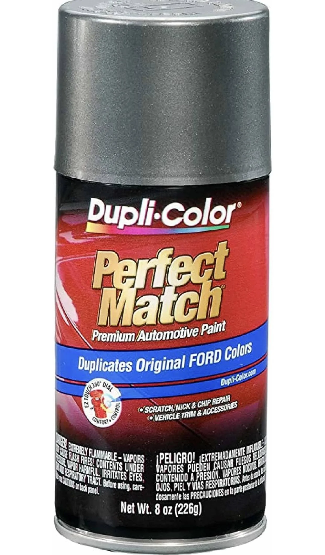

Now you can “buy it”. See below…

That is indeed the paint code for all the Mach 1 HP parts that are the satin gray color. J7 Magnetic Metallic, it is just a matte/satin finish for those parts (vs the gloss finish that was used for the S550 body color). A good paint shop would be able to do it no problem.
