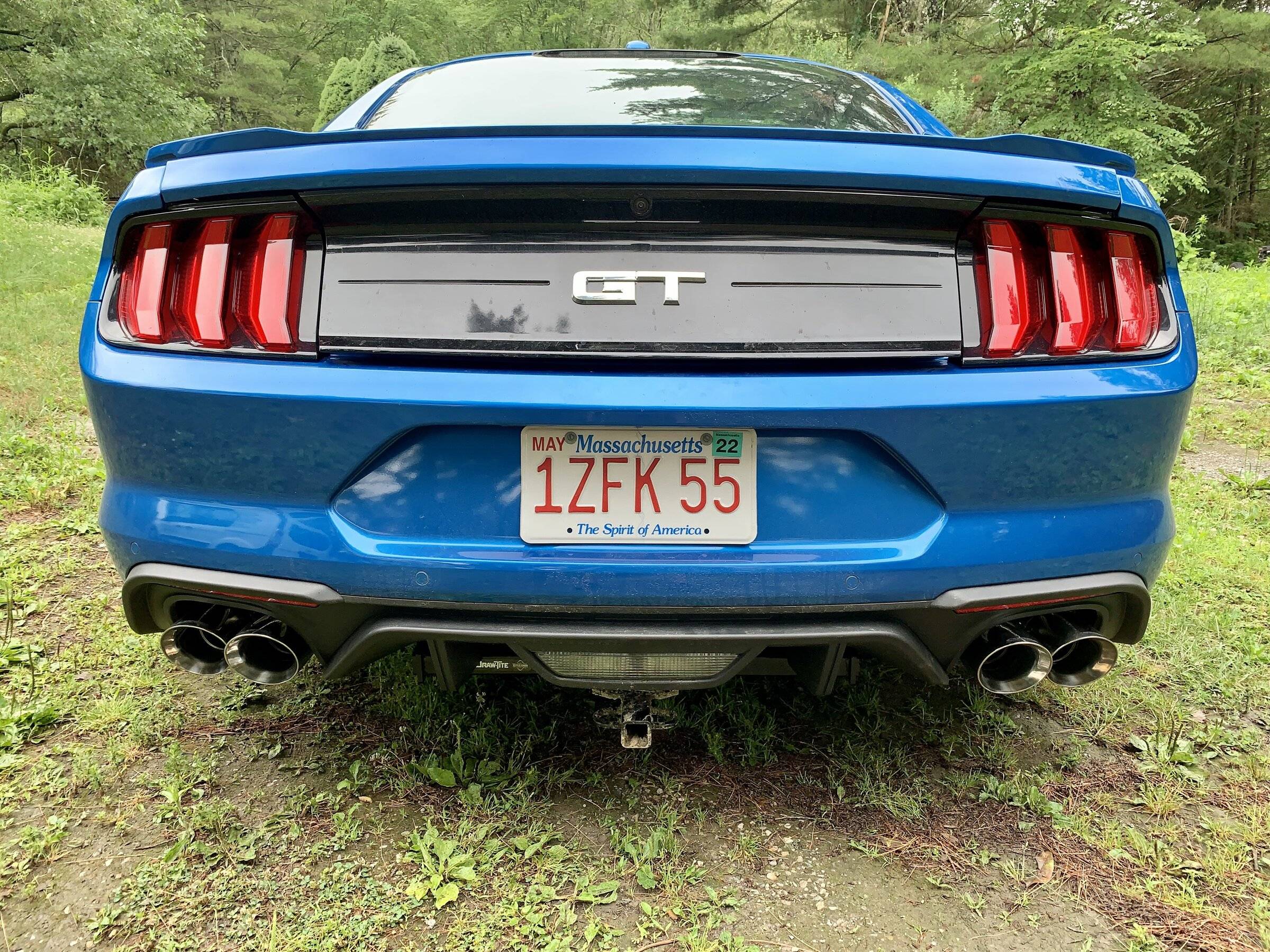

I have the Draw-Tite on my 2019 GT w/active exhaust and it fit perfectly. I'm guessing the differential cooler and such are what's in your way....

I believe I have the Curt hitch and I had to take off my exhaust and beat the mufflers endlessly with a giant hammer to make it fit. 2018 Mustang GT without active exhaust.
Nothing aftermarket ever just works. Is a life lesson I learned long ago.

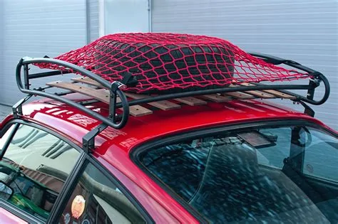

Old school basket type strapped roof rack.
I have a Seasucker roof rack gimmick, so in theory that's possible LOL. However, I also wanted to use my bike carrier, or have the option to tow a small trailer for my fishing kayak. The bike weighs 80 lbs (its a fat tire electric bike) and the kayak weighs 110 with all my gear, so loading either on top of the car is a recipe for disaster.
