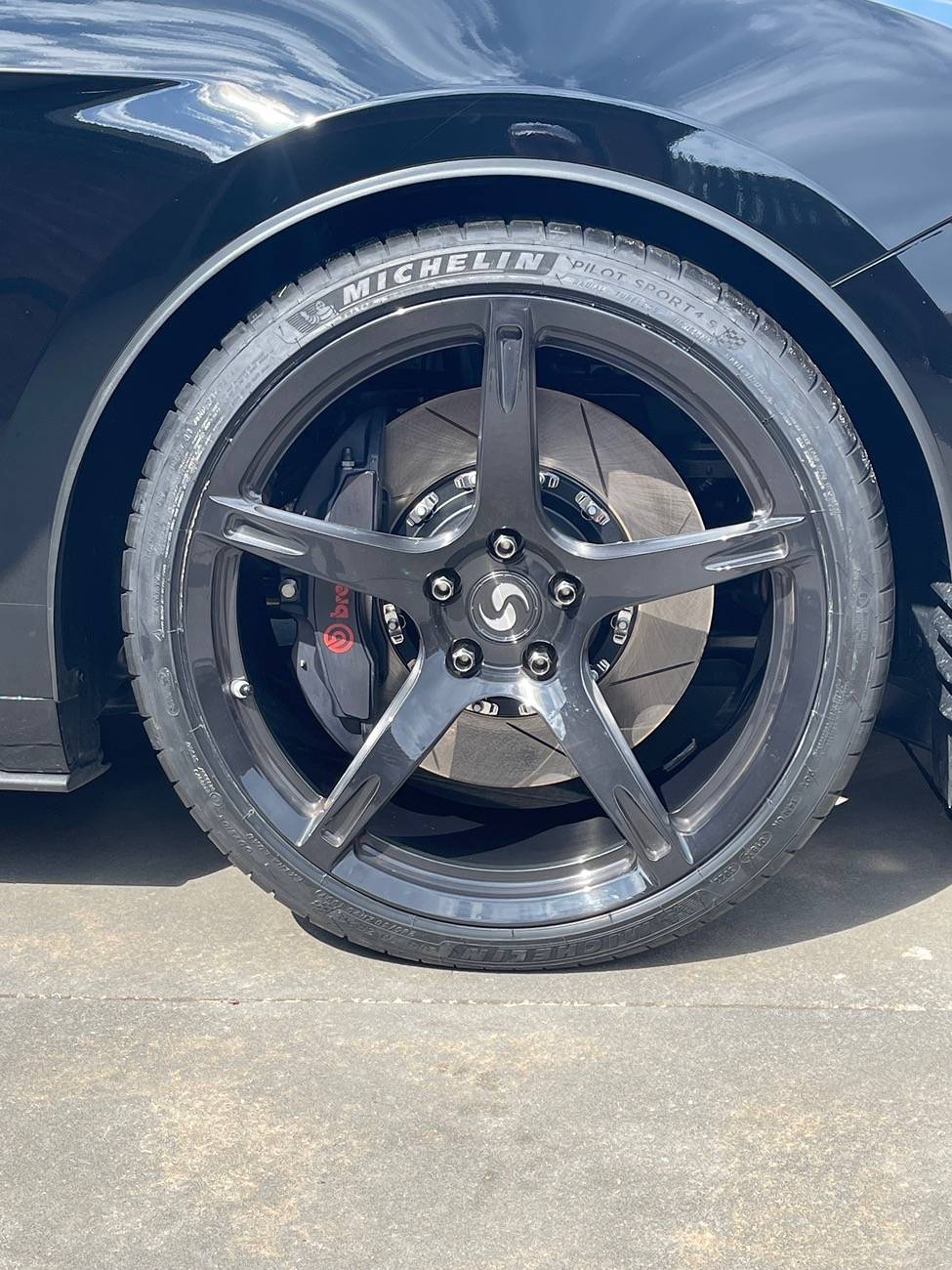

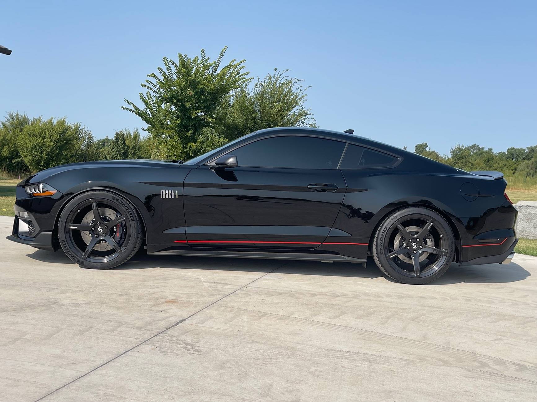

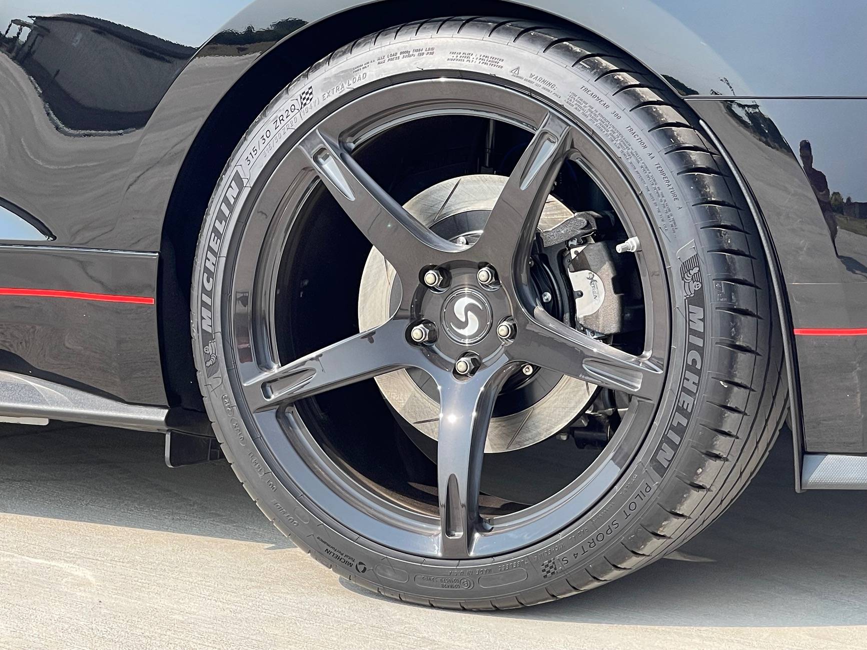

I’ve got 10.5/11.5” signature 20” wheels on mine with steeda dual rate springs.
