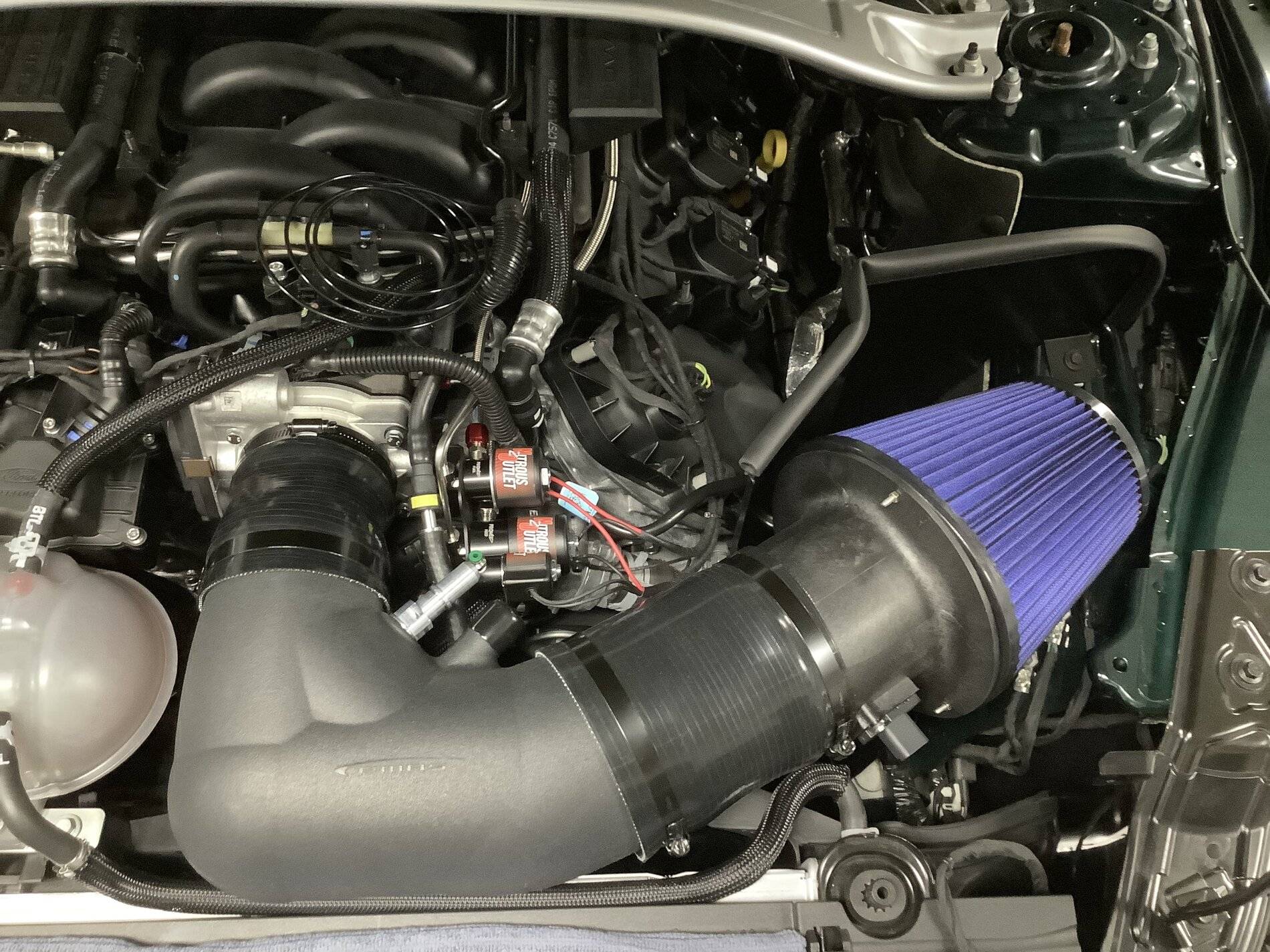

That FP air filter is not fitting very well.

I see that, but to me….looks like it’s not sealed very well then the bottom of the filter is sticking out pretty far from the intake piece. On a side note, I just put in the FP filter too…I felt around the inside of it and found a few strands of the wire that holds it together, protruding out….so I had to clip them. The strands could have broken loose and gone right into the intake manifold and into a cylinder. If you buy one, check it for strands of the wire.

I agree, how good a seal would get bolting it up like that, lol. Found No wire strands on mine when purchased.

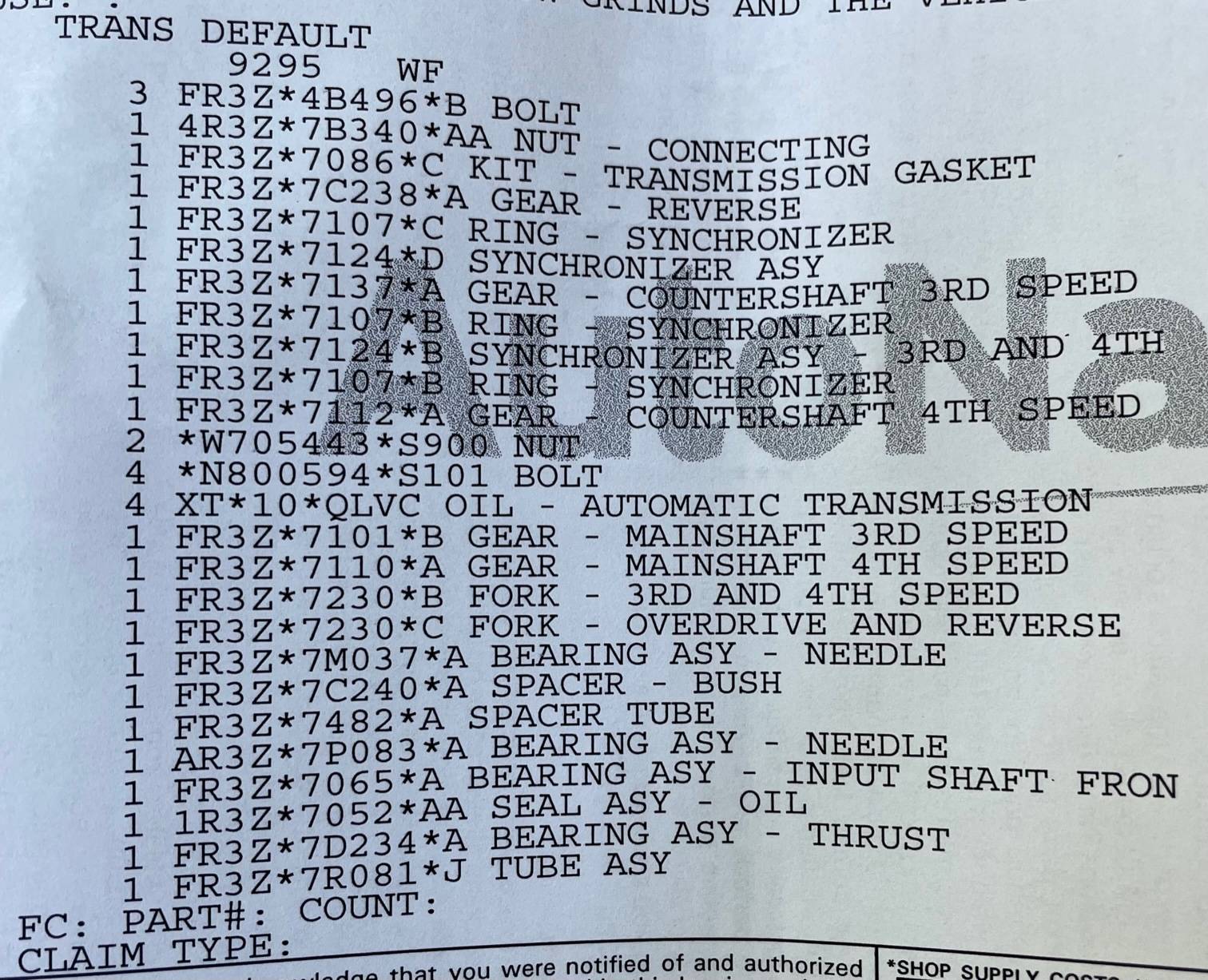

Car is all fixed now. New 3rd/4th plus a bunch of synchros and related parts. Drives great.
There are a couple of odd sounds coming from the car that I could use some feedback on:
1) The transmission has a "whine" to it that increases with gear speed. I think it may be the new gears simply breaking in?
2) There is a noticeable hum from the engine bay when the clutch is out, and it goes silent when I push the clutch pedal in. Any ideas?
I plan to contact the service manager on Monday to let him know about these new sounds.

Sounds like something's wrong inside the transmission to me. It shouldn't be making a whining noise. Did they replace the bearings in the transmission?
The hum when the engine is running and transmission is in neutral with the clutch out also sounds like a transmission bearing issue to me. Another possibility is they didn't shim something properly and one of the shafts isn't preloaded as it should be.

Regarding bearings... they said when the planned repair was complete, the car failed the mechanic's test drive because of an additional bearing that needed to replaced. Took an extra week to get the car back because of that.
Parts list below, there are a few bearing assemblies...
