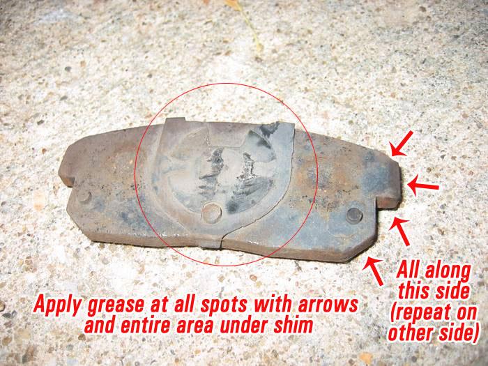

How are people compressing the pistons? I normally use a C clamp on my other cars.
Do people use any brake grease? If so where?
