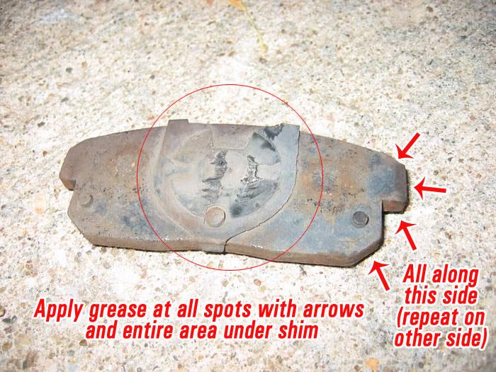

Put grease on the back side of the pad where the pistons would press up against the pad.
Found this pic on the web. It's spot on:
That's the rear pad for a floating caliper though. Both front and rear calipers on the GT350 are solid mounted and the pads have pins in which they slide along.
Well yes, but I mean you can follow that in principle.

Replacement OEM GT350 Brembo pads normally come with a tube of grease. It is designed to handle high temperatures such as those generated at a track outing.
I only put grease where the factory did. On our GT350's you'll see it applied to the ends of the pad backing plates, where they make contact with the caliper. The general area is where you see black (the inside 4 corners in the following photo).
Some have suggested placing grease on the back side of the thin metal support shim that is used for noise and vibration. While on its face it wouldn't seem like a bad idea I don't put any there as the shim itself is there to quell noise (rubber-metal-rubber shim).
https://www.bremboparts.com/america/en/products/pads/the-perfect-partner
The pins I believe are stainless, probably to mitigate any galling that were to occur were they a more corrosion-prone material. A very light coating on the pins may not be a bad idea (as much as I don't believe it will last very long) to minimize friction and encourage the pads to move freely.
