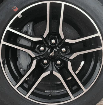

I am just starting out looking into getting new wheels for my car. I really have only two requirements 1. They must be the same size that I have now. 2. The new wheels must be lighter weight than the stock OEM ones. I am having trouble confirming the things below. Are there any good brands that offer better wheels in this size?
I have Ford's Black and polished metal wheel - original to the car.
I think its 18x8, but it might be 18x8.5.
What is the offset on this - or how do I determine the offset?
What is the stock weight? (without the tire?)

that appears to be an 18x8" wheel.
FWIW, if your goal is to stay lightweight, you can actually get a forged 18x12 with a great Yokohama A052 200TW tire and still be lighter than the factory 18x8 with the stock tire. I'm just making a point.
If your goal is to drop some weight and not have to buy tires at the same time, I'd just wait until you're ready to replace tires and then upgrade wheels later. I wouldn't recommend putting any money towards wheels less than like 9" wide. Its just a waste unless your a drag racer and are just talking about front wheels, then carry on.

Stock base wheels are 18x8 with a +40 offset I believe (mine are currently on the car so I can’t double check the offset at the moment). It’s stamped in the inside of one of the spokes
