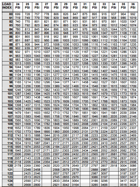

Hi,
Have now had my new Project 6gr Sevens 20x11 + 20x10 lying around for more than a month and the new set of Pirelli Zeros too. Have been waiting for a set of TPMS that never showed up, and will finally get a set so I can mount the wheels so the next question is: Which tire pressure should I have?
New tires are 275/35R20 (102Y) front and 305/35R20 (104Y) rear.
Stock tires have a load index of 96Y up front and 101Y on the rear.
According to a standard table, using 32 PSI on both rear and front on the stock tires, it should translate to 26 PSI on the new front tires (1415 lbs) and 28-29 PSI (1647 lbs) on the rear tires.
Am I correct?

I used this table but maybe people have more knowledge and have more useful info!

That is why I referred to the load index on the stock and the new tires when picking the pressure from the table that is based on exactly that. Load and load index. I based the load on what the corresponding pressure for the stock tires load index shows. It would help if you knew the correct load on each wheel as I don't have the car or manual available atm.
That is: The pressures indicated by the drivers door is 32 PSI all around (2.3 bar). That pressure, together with the load index of the stock tires indicate a load (xxx lbs) on the wheel.
This load is then found (or as close as possible) in the column for the new tires load index and from there I read the new (lower) pressures at the top of the diagram.
The size and width of the tire should matter IMO as a wider tire will become over or underinflated easier as the distance from the center to the sidewall is longer. At least that's what I assume, so I'm keen to get the correct pressure to save some rubber.

Wider tires should probably run slightly lower pressures, but I don’t think you can trust that table. 26psi sounds very low to me. 30 psi maybe, but 26? I’ve never seen a mustang on wide tires run that low outside a drag racing scenario.
If you want to test pressures, look for sidewall wear after mild cornering (signs pressure is too low) and/or go get a laser thermometer and check temperatures across the tread immediately after driving ( before temps have a chance to even out). The center of the tread should be the same temps as the inside and outside tread regions if pressure is right.
Thanks for your input.
Yeah for me it seems logical that the pressure should be lower as the surface is bigger, but as you say, 26 psi is quite low.
Thermometer is an old classic and might just be the way to go...
Was looking for some more knowledge as I assume a standard table is just as good as it gets but 30 might be a good starting point.
Anyone else who drives the same setup with some input?
